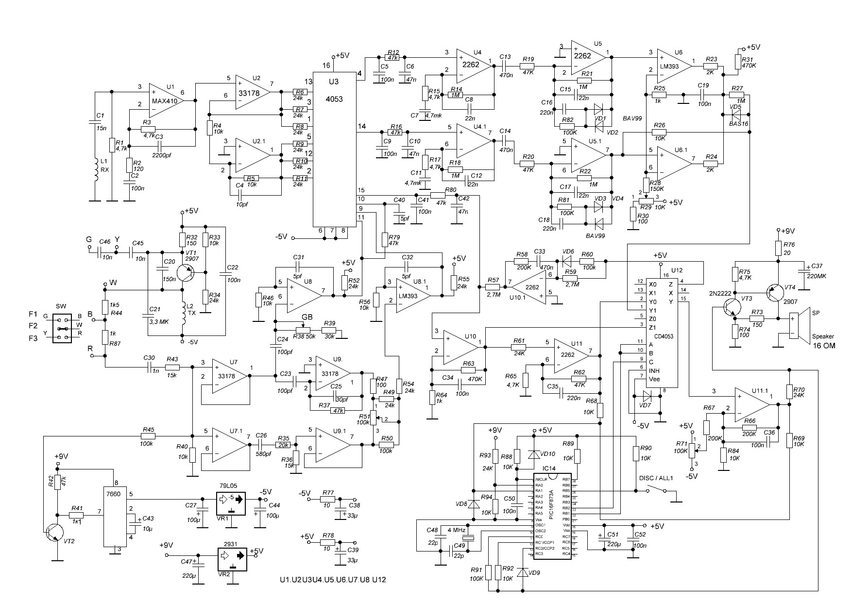

    Hi, theres no supply on the oscillator.
    S
    You are correct. I did that when I was adding 5V somewhere else on the schematic. Looks like I did a cut and paste instead of copy and paste and erased it from the oscillator. I'll fix it.
    • While you are at it, you could replace the U3 symbol with U12 symbol to make it consistent and easier to read.
      • I fixed the oscillator supply. Changing U3 is more involved. More connections.
        MercClick image for larger version
Name:	Cibola_Original (corrected).JPG

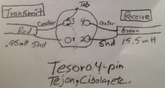

        • I bought a Cibola coil with a damaged cable from eBay. I then bought a 4-pin extender cable and spliced that onto the coil to repair it. That way I would have the exact same type of wire as the original. While doing this, I sketched out the
          coil connector wiring diagram and thought I would add here for others.
          • Originally posted by Merc View Post
            Merc
            Thanks for doing this. Is this looking into the male connector? I take it shd = shield? What is the D.C. resistance?
            • This is looking into the solder side of the connector on the cable. It uses two individually shielded wires. I haven't made any resistance checks yet.

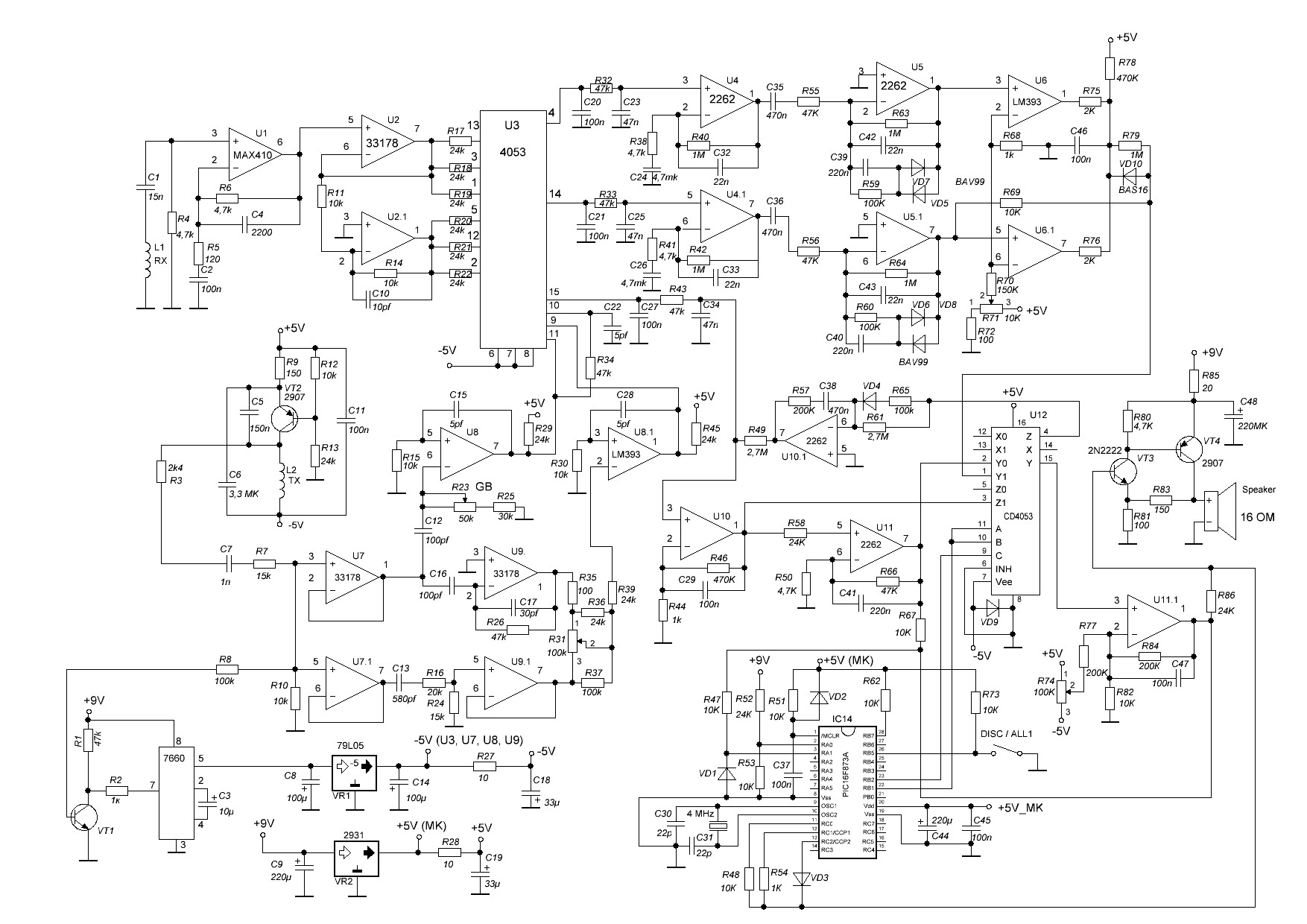

                  • last week i have finished the cibola pcb desgin from ivconic posting 45
                    little bit tricky but it works
                    minelab coil (1mH-10mH) works a little bit better than original sef cibola replacement coil (1mH-14mH)
                    but i think thats a frequency shift problem which could be fixed be using right cap values on rx and tx stage
                    no corrections done since post 45 but i will add them next weeks
                    kind regards
                    • Completed the circuit board and remade Hex.
                      Hex Tested 2 weeks. The result is good

                          Hello Вernte_one ,
                          I used the psb without the processor on the circuit from above page. The processor is connected to a short wire. Oт the weekend, I can remake a layout with the processor.

                            • I made a pcb with the MC. You can use the PIC16F873, PIC16F876. Hex same.
                              ...i made analog model of cibola but works not as i hoped
                              i am sure the pic µcontrolled units performs better.....
                              In my opinion not much difference with or without MK MK. IMNO
