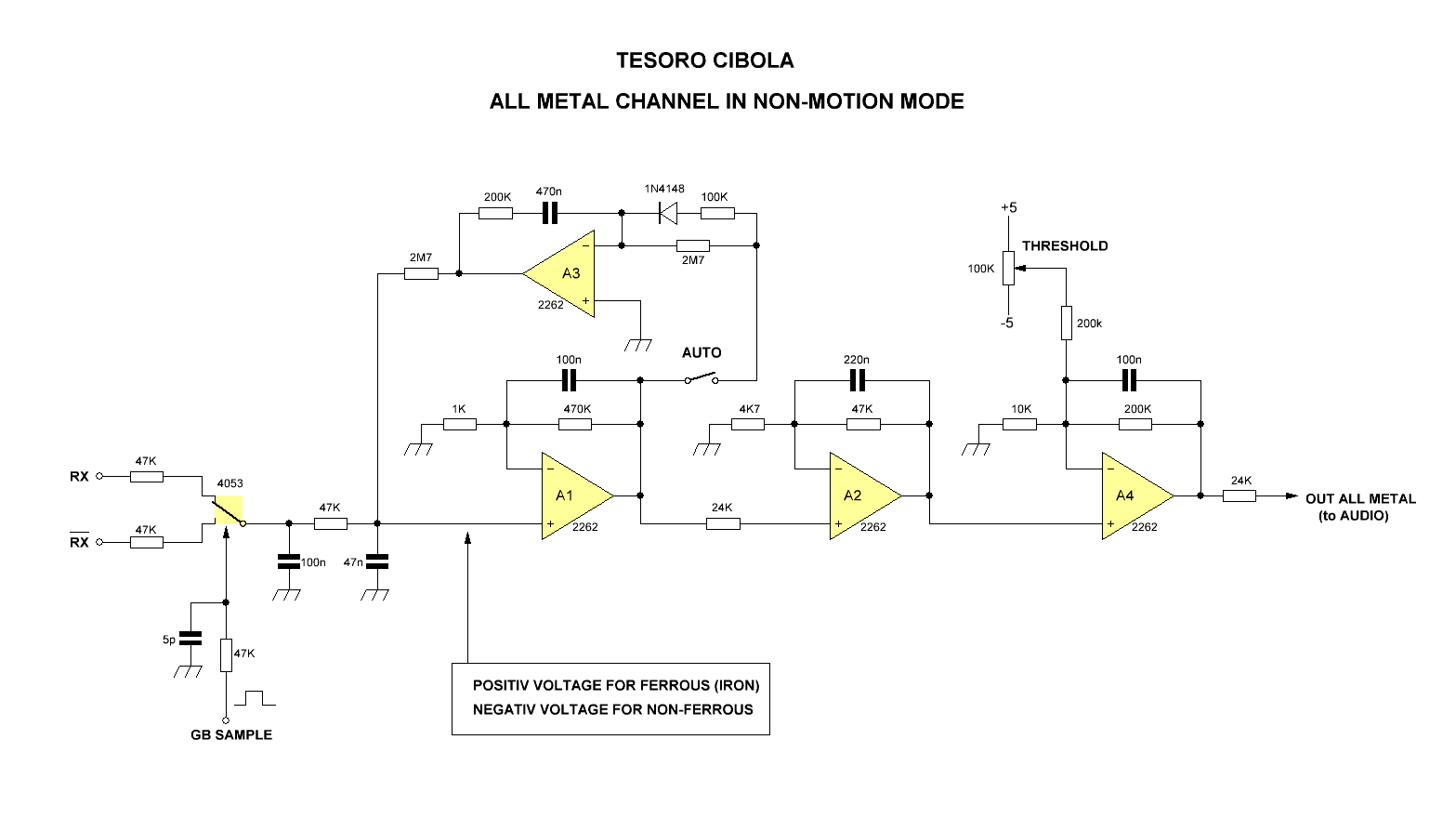

                          • PINPOINTER QUESTION
                            I start to build Tesoro Cibola and i made some measurements and tests. I found something "wrong" about All Metal channel.
                            Cibola is non motion detector in all metal mode, i found this feature in user manual...
                            Everything is good when the ALL METAL channel is tested with iron (ferrous). The signal after phase detector increase to a positive value and i have audio response.
                            Tested with one nickel coin or other non-ferrous target, output signal after phase detector increase to a negative value. In this case i don't have audio response because audio stage working only with positive voltage. Maybe if i use THRESHOLD i will have one response from threshold value to silence (opposite,reverse response).
                            Feedback stage for "auto tune" was OFF because i want a non-motion mode without auto-zero feedback. With "auto tune" ON, i have response for all metals but is necessary some motion.
                            Same architecture is used in Eldorado, Bandido... Click image for larger version
Name:	Cibola Pinpointer.gif
                            Has anyone noticed this anomaly?

                              • I built a bandido both the motion and auto work fine. When working in none motion mode you have to hit the retune to fetch the threshold tone back.
                                Sound a lot like the ground balance is way out
                                or the Rx connections are the wrong way round. (would also give a double beep in disc mode)
