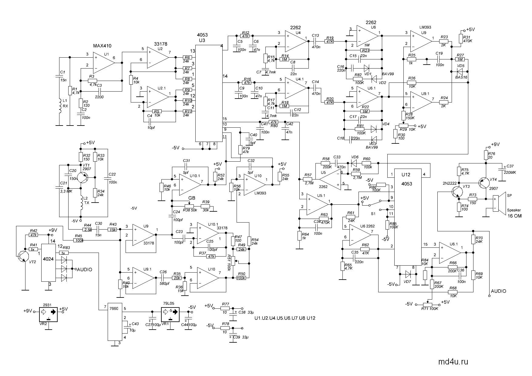

    ello,
    I want construir a Tesoro detector cibola the accompanying drawings is FUNCTIONAL? Someone on this forum did this detector? experience feedback, thank youClick image for larger version

      i have not seen this variant as working detector
      the other Project with µController seems to work Project Name is sibola
      i build myself cibolo without µController from a design layout from ivconic
      but i never reached the Performance like an original cibola (i had it some years ago, the green one)
      maybe the latest scheme from russian Forum is better, do you have pcb layout for this scheme?
      • You have realized this detector ? A scheme without peak ( ucontroleur ) do you have the schemas and pcb ?
        Thank you.
        • you can find all in this thread just start reading from page one

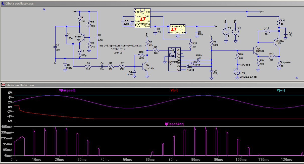

          • Originally posted by gost373 View Post
            ello,
            I want construir a Tesoro detector cibola the accompanying drawings is FUNCTIONAL? Someone on this forum did this detector? experience feedback, thank you[ATTACH]36136[/ATTACH]
            Hello. Tesoro improved their transmit oscillator so the tx signal output is really clean, much better than on their Sabre series.
            And the negative supply really pumps out -5V. Good job, Tesoro! (Hooray.) OOh ooh, and the Cibola uses full wave detection. What's not to like?
            The reverse engineering guy did a really good job, but I think the audio has a bad problem.
            The diodes on the CD4024 are facing the wrong direction. They will cause high current draw because the audio duty cycle is upside-down. What you've got to do is simply reverse the three diodes and give them a slight pull-up (R9=330k should be about right). That should make a big difference. In my picture, C9 is there to kill the diode switching artifacts in the simulation, but is unnecessary in real life, so you don't need it.
            It would work, but this clone would be a battery killing machine with those diodes facing the wrong way. I have wired parts of it in LTspice. I never build anything (everybody knows that) but I might have to build this one I like it.
            I also simulated this thing with the diodes facing the wrong way, and it's a mess, people. Believe me.

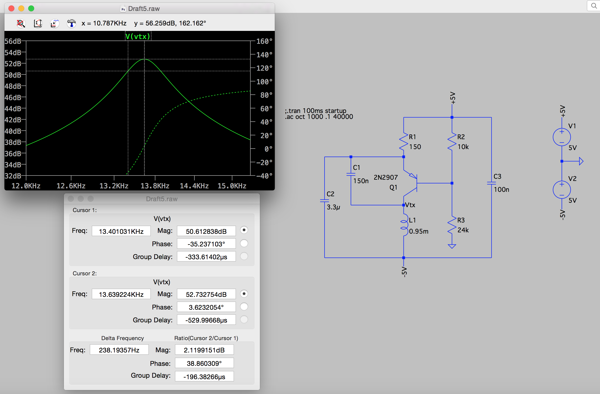

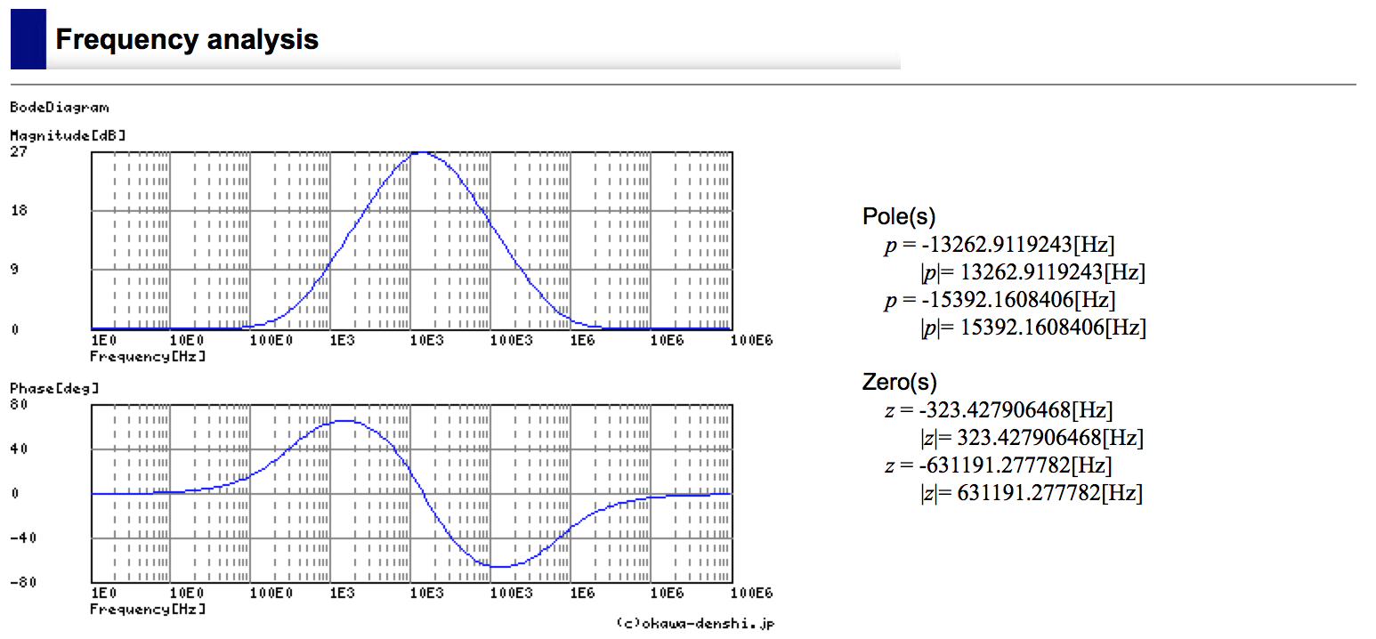

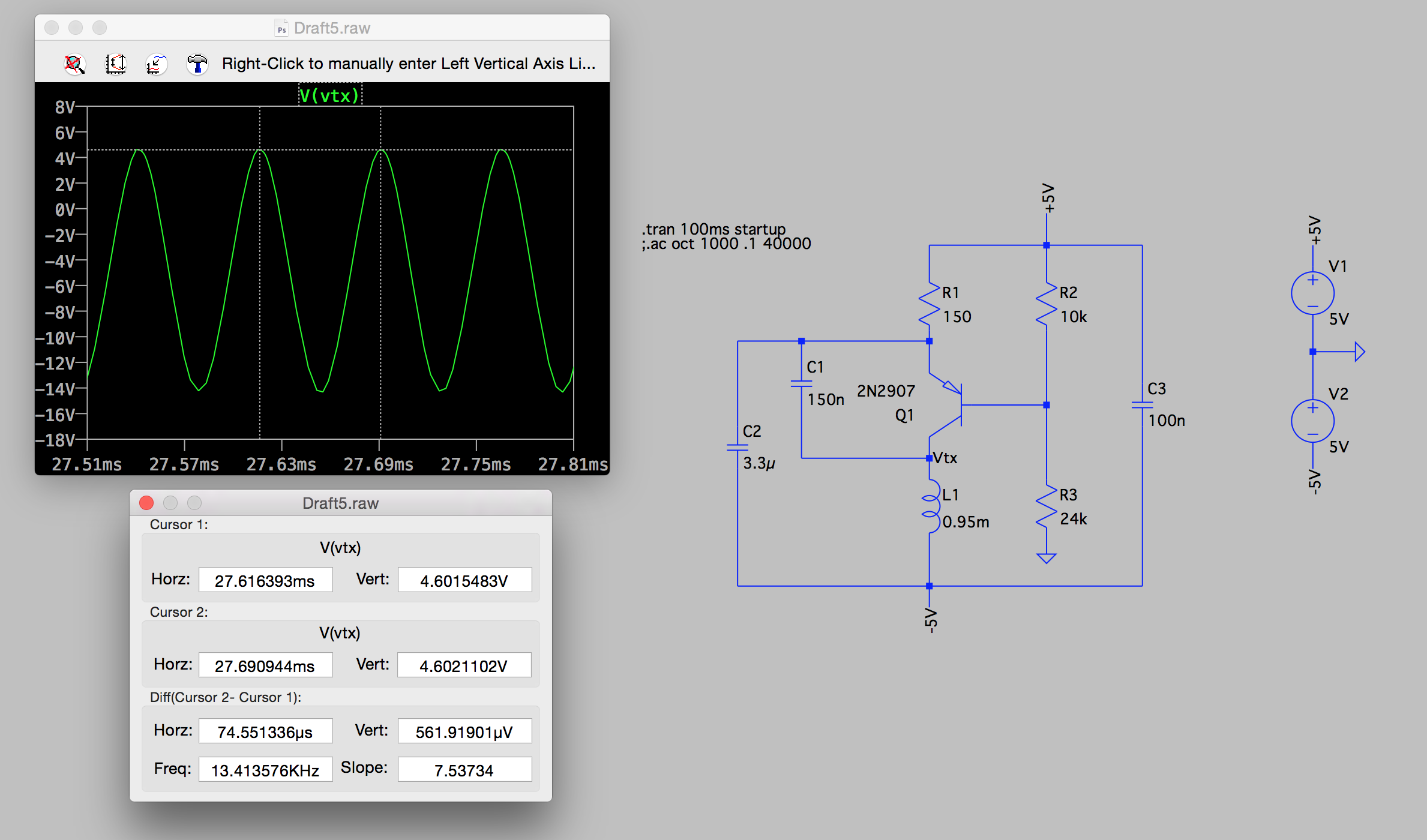

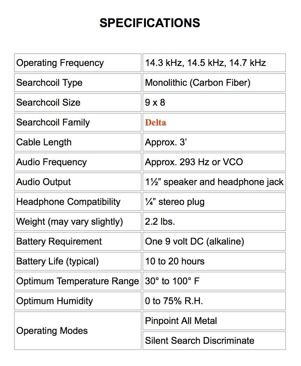

                • I just run a simulation on the Cibola transmitter in LTSpice, it turns out it will oscillate at ~13.4kHz (resonance at ~13.6kHz) instead of the ~14.5kHz as the original Tesoro. I'm not sure if this is the way it should be.
                  • [QUOTE=sled;217933]I just run a simulation on the Cibola transmitter in LTSpice, it turns out it will oscillate at ~13.4kHz (resonance at ~13.6kHz) instead of the ~14.5kHz as the original Tesoro. I'm not sure if this is the way it should be.
                    I saw that too. Umh, rounding errors?
                    • On md4u.ru. Appears someone has a working firmware in September 2015
                      https://youtu.be/tSoiF78HP0c
                      VCO for pic16f873 on GSL board
                      Interest in the project then seems to have been lost.

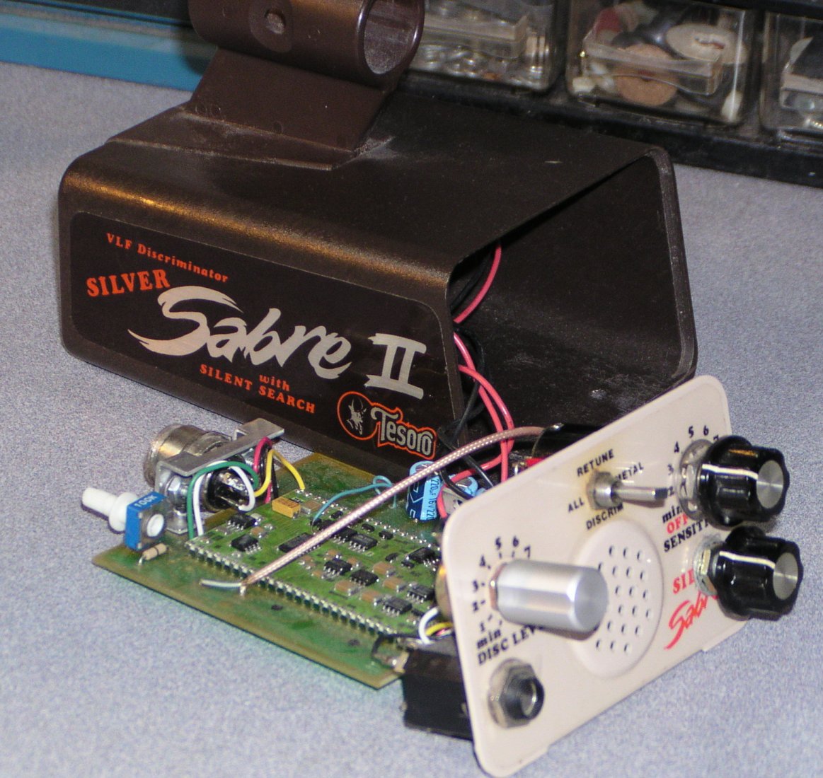

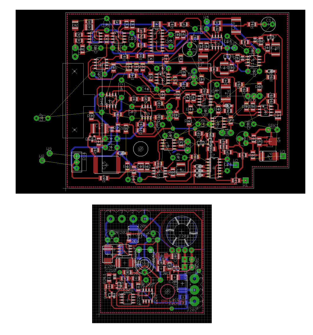

                          I took another look at the Cibola and it is not what I am needing. I totally overlooked the ground balance being a preset. Of course the GB control could be moved to the front panel, but I want something to fit in my existing Silver Sabre II cabinet (smd version). The cabinet has room for either GB or tune on the front panel, but not both.
                          That's really too bad because I had a layout almost ready to go. I'm not going to do it; it will remain unfinished or perhaps morph into something else, some other time. It is not going to fit where I originally intended.
                          Instead I've worked up an SMD layout for the Diablo II. It should fit nicely, with not too many knobs and dials. I will need to drill a couple of more holes... but that's not much of a problem. And there is gold here in potty town, not like you might find out in CA or AZ, but it's here, so Diablo II earns a spot in my old SSII cabinet. It's about time.
