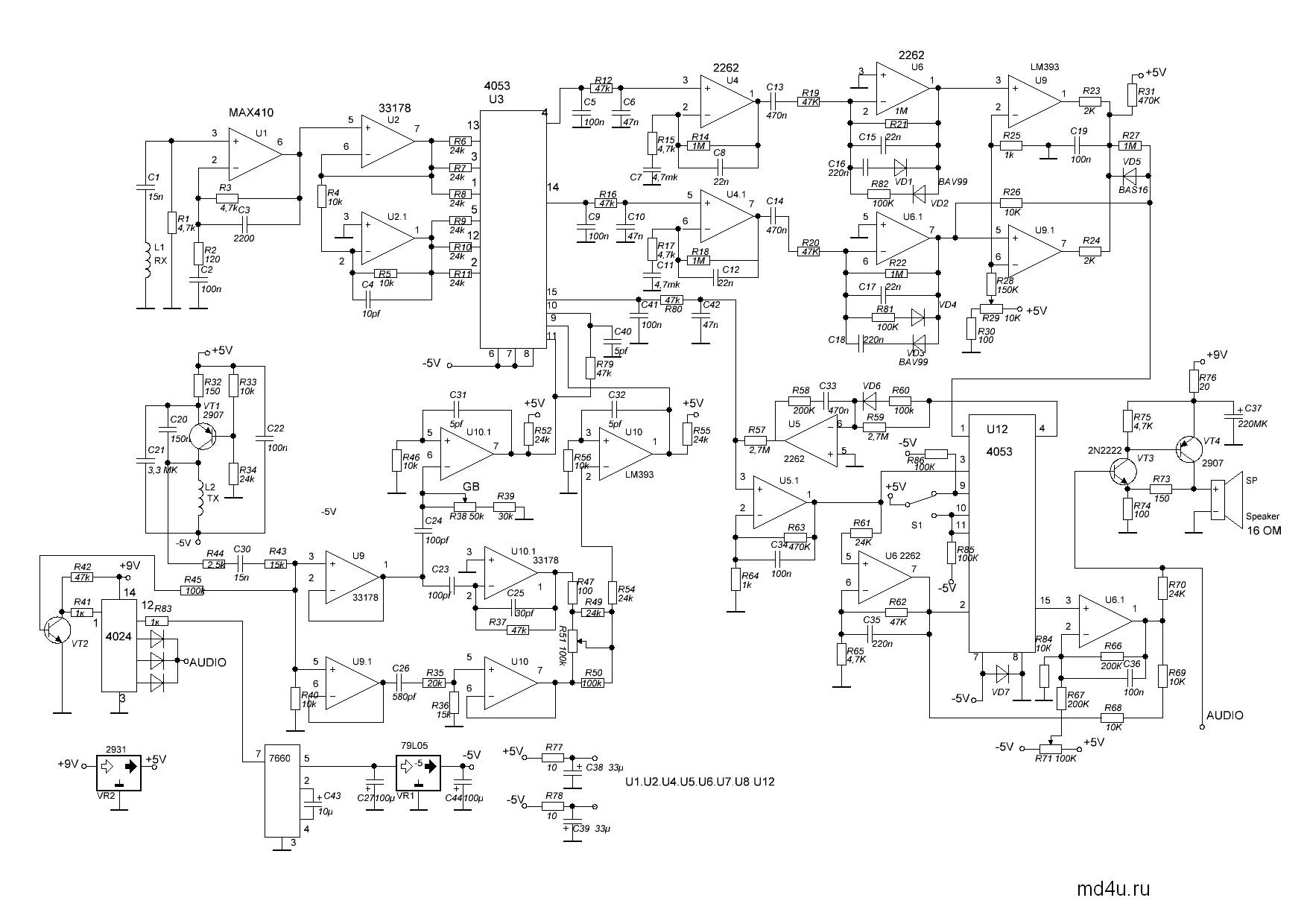

                      Final schematic without mistakes.No PIC added 4024.

                        Omit U12 (4053) and use mechanical switches.
                        It will reduce pcb in size and spare few components.
                        Also instead 4024 single opamp based vco can be used too.
                        7660 would require sync with main oscillator but instead resistive coupling i would rather use capacitive.
                        I guess few pF would do just fine (22-100pF).
                          If this goes to layout and kit.

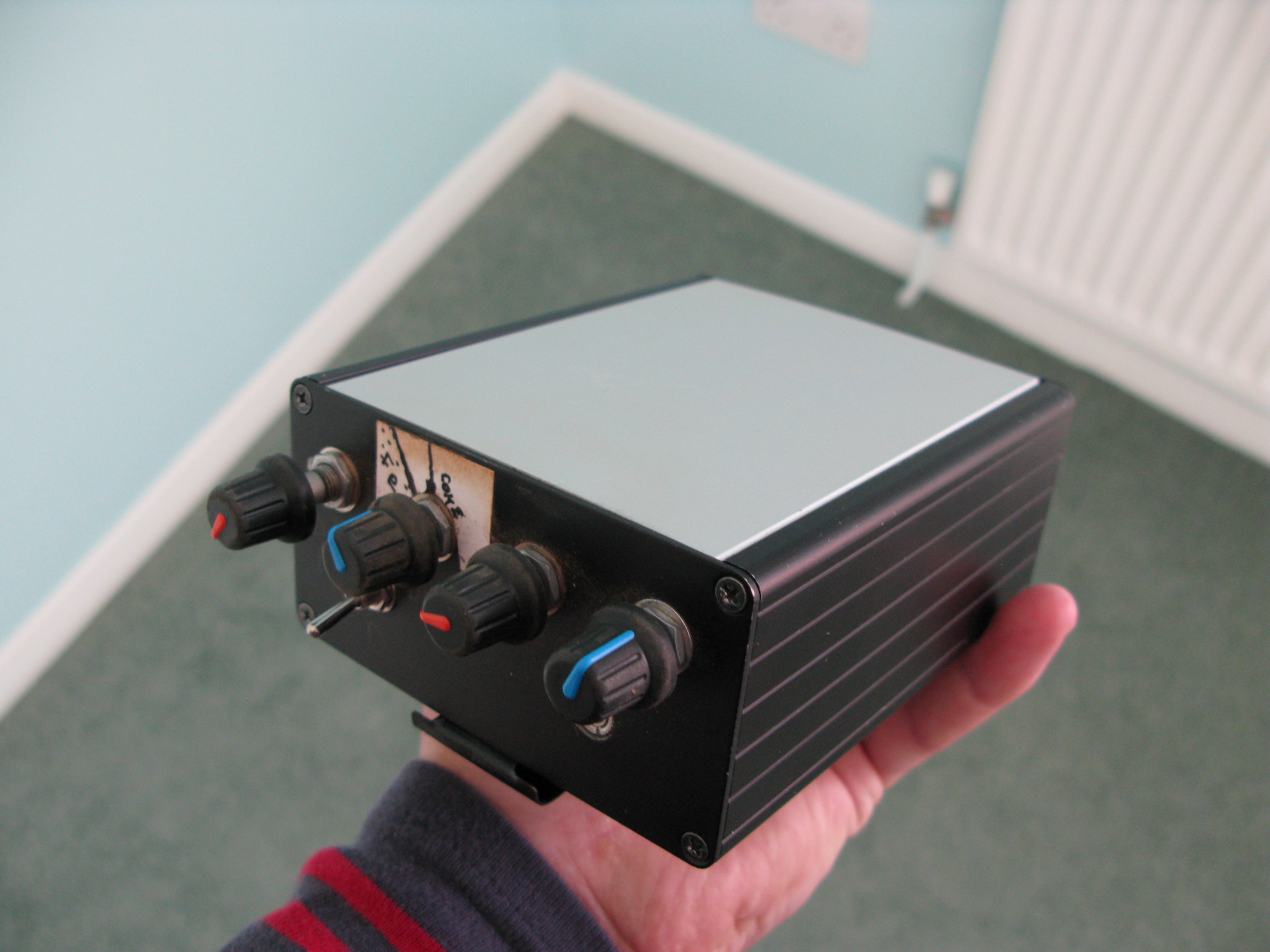

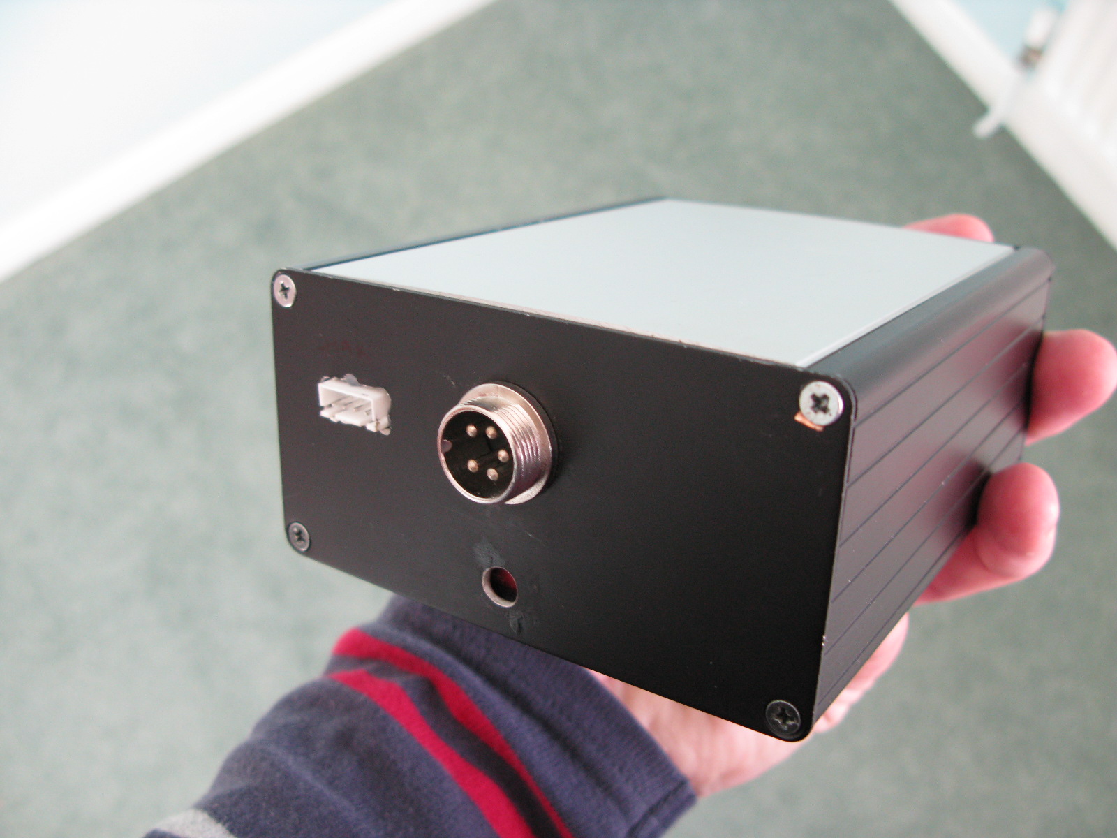

                          Make pcb 100mm wide and 120mm long -so it fits in the rails of a quality project box.
                          eg
ID:	333591Click image for larger version
                          Have a gap exist between the Tx cct and the Rx preamp - with a copper gnd flood between for isolation.
                          Put the holes for the Pots on the edge of the pcb - so we dont have to add lots of wires to pots.
                          So the pots are in a row - mounted thru the pcb.
                          Steve
                              ...It will reduce pcb in size and spare few components....
                              ...7660 would require sync with main oscillator but instead resistive coupling i would rather use capacitive.
                              ....Omit U12 (4053) and use mechanical switches.....
                              Undesirable - this will lead to noise interference.
                              ......7660 would require sync with main oscillator but instead resistive coupling i would rather use capacitive....
                              This solution was used in the Lobo.

                                What noise interference?
                                Solution used in Lobo might not work here too.
                                Anyway, this schematic is full of mistakes, same as "Tejon" schematic.
                                Will not work anyway.
                                Good luck!
