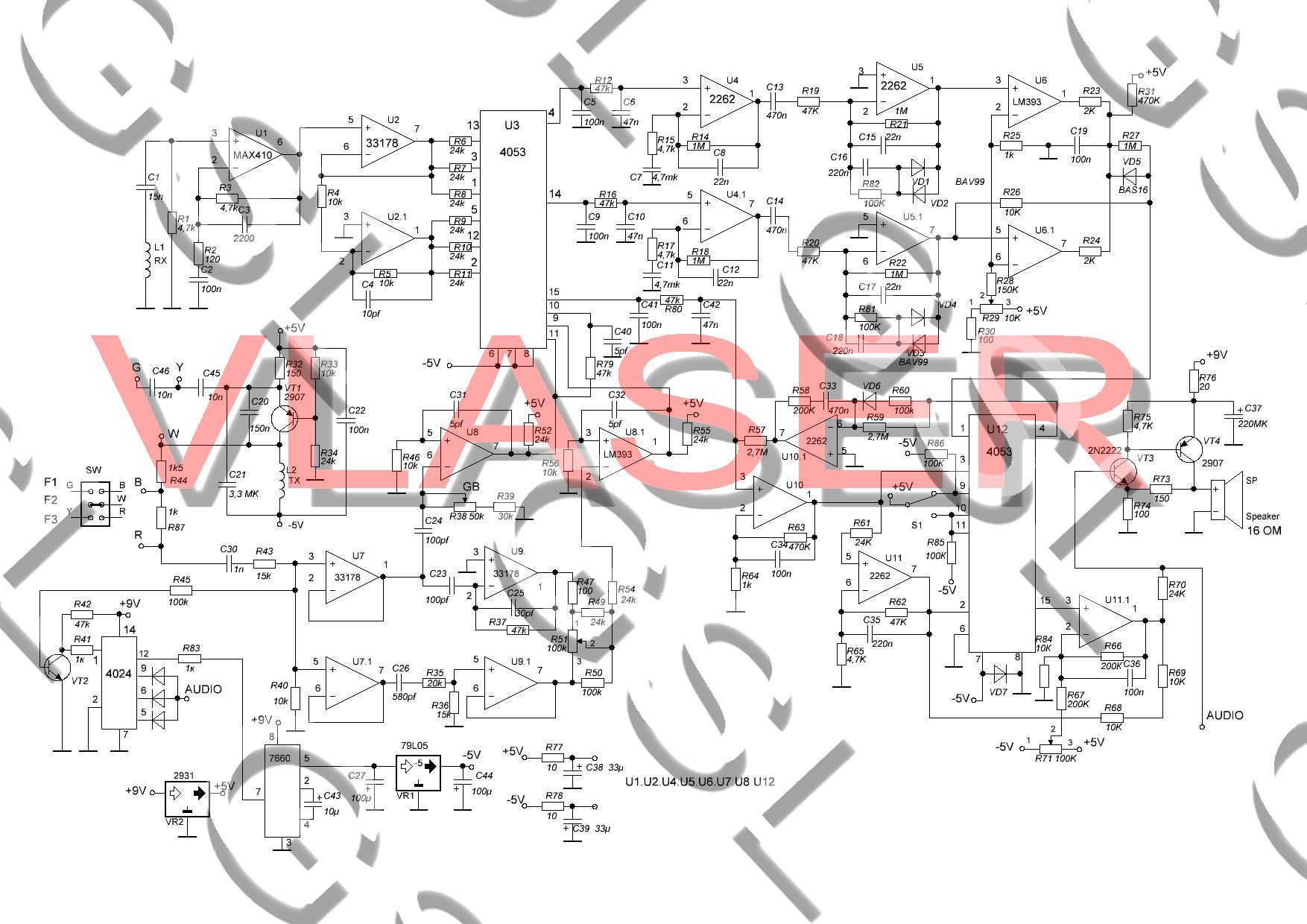

        Great job ivconic!
        The second half of LM393 can be used to indicate the low voltage power supply.
        Best regards,
        GSL
        • #49
          ivconic excellent job.
          What software do you use for drawing the scheme? regards

              R37 (2.7m) must connect with pin3 ts272
              • #52
                Correct!
                That does not affect Disc mode and that's why i haven't noticed any problems.
                I will correct that.
                Thanks!
                • #53
                  Here is corrected:
                  • #54
                    Hello Ivconic,
                    One thing may be interresting to be tested is to use a MAX1440 instead of the 7660.
                    I've succesfully used this chip on a electric violin preamp.
                    The MAX1044 has got a Boost pin to make it run at higher speed (6 times) (without external sync).
                    You can ask some samples for free directly from MAXIM : http://www.maximintegrated.com/datas...7/t/or#Samples
                    Hugo
