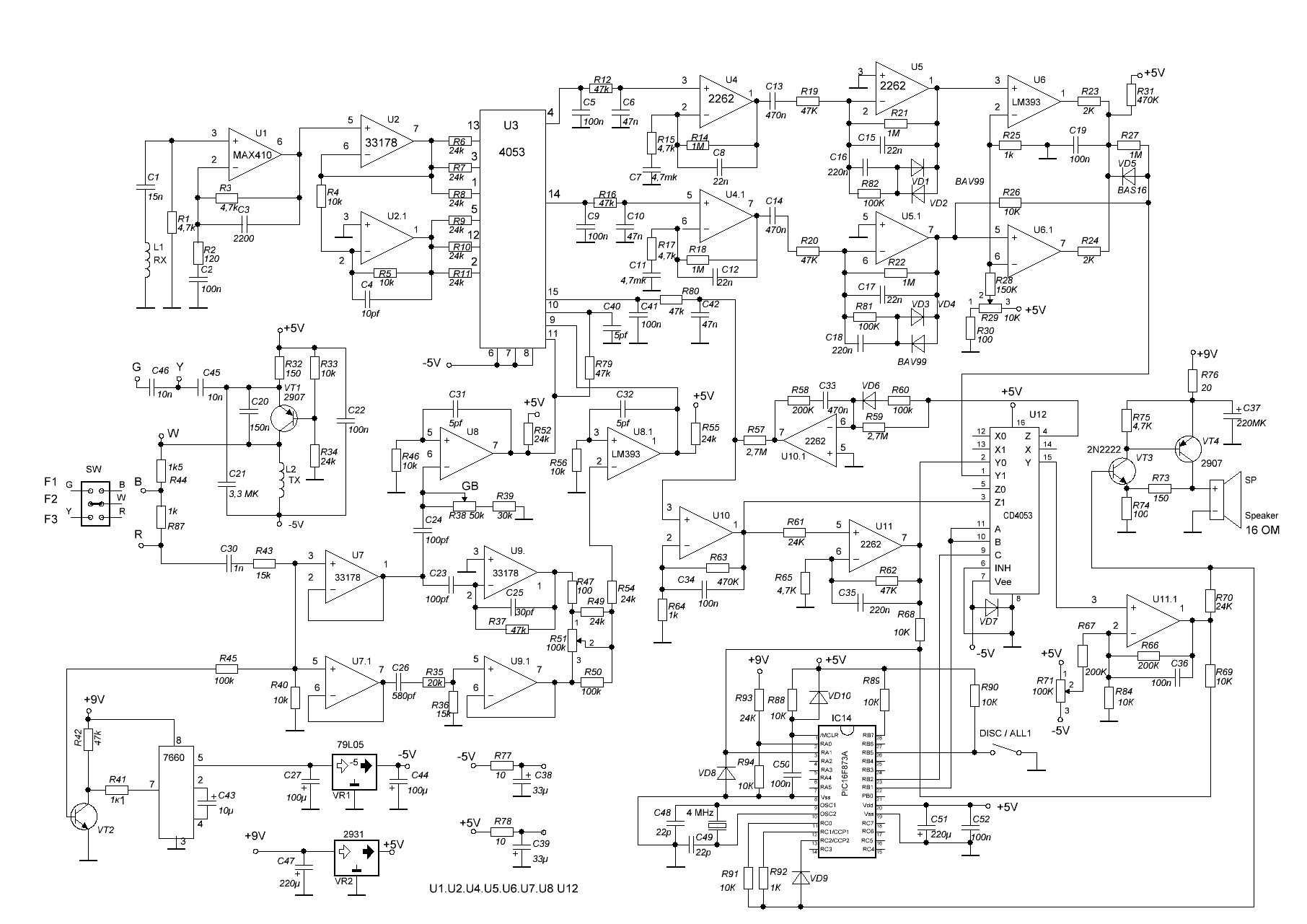

    This is a photo of my board
    Hi GSL, Good job !
    Yes I know, but I want to have a look at the code to see what it does exactly.
    Bad idea ... A flowchart is enough.
    • #92
      I think so too! Нех is enough.
          Well... I disagree. Source code is nice because you can learn from it.
          • #95
            I agree too!
            Is it an original firmware or a remake?
            • #96
              Originally posted by Altair View Post
              I agree too!
              Homemade firmware
              An original firmware locked.

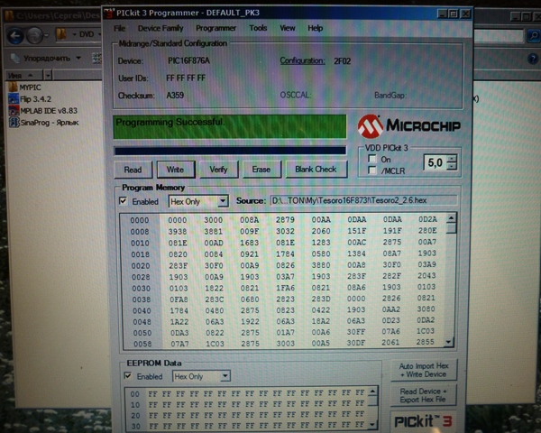

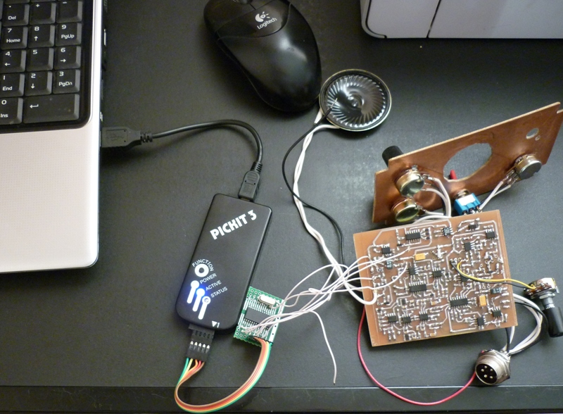

              • #97
                @GSL
                Thanks for the pictures !! Very great job!!
                You are on youtube ? so i am looking forward to see (hear) a video from your working Cibola I am very curious about the sound.
                I am planning to build the Cibola too. But I want to wait until the PIC is completely tested, and integrated on the PCB.
                By the way, that would be another good project for Silverdog PCB´s and Kits .....

                • #98
                  http://www.md4u.ru/viewtopic.php?f=2...138580#p138580
                  http://youtu.be/wG7glZs78h4 Videо Test Sibola firmvae 2.4.1.
                  This is not my video of the device, but made my colleague Vlaser under this scheme with my firmware 2.4.1

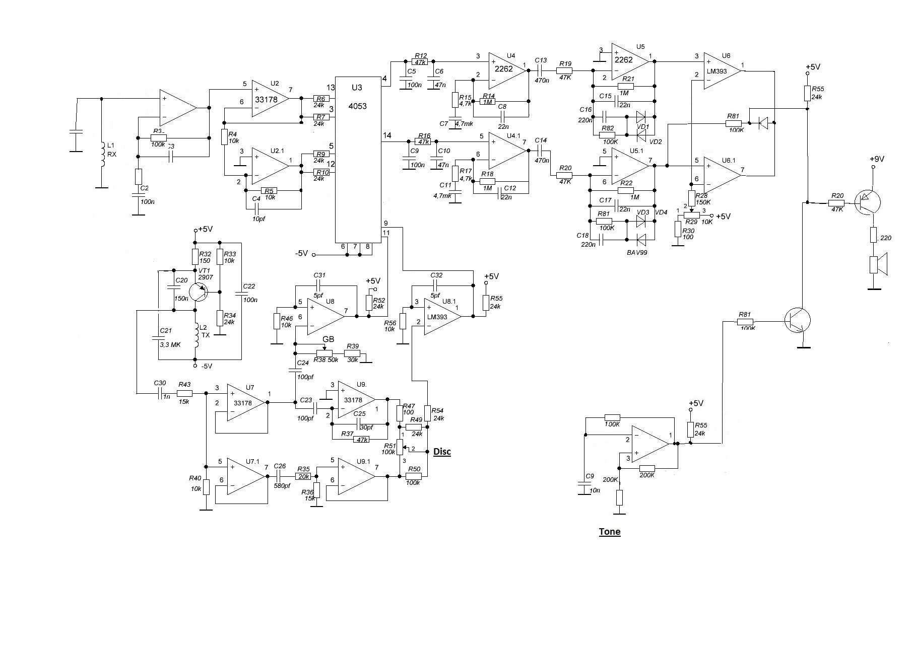

                    • A few people on here are not great with uprocessors. If a reasonable design was found without uprocessors Im sure it would have a wider audience.
                      Ive looked at the sibola and trimmed it back to basics. Feel free to kick it about as Im certain its, sub optimal..
                      I thingk the tone would be on all the time! It needs a tweak - just for architecture than absolute.
