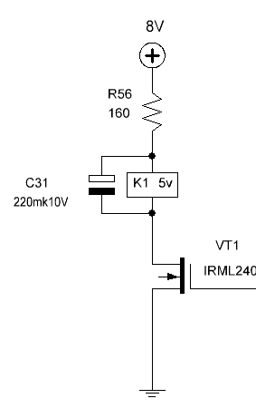

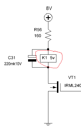

          Is this a relay coil?Click image for larger version
            Its a rele coil
