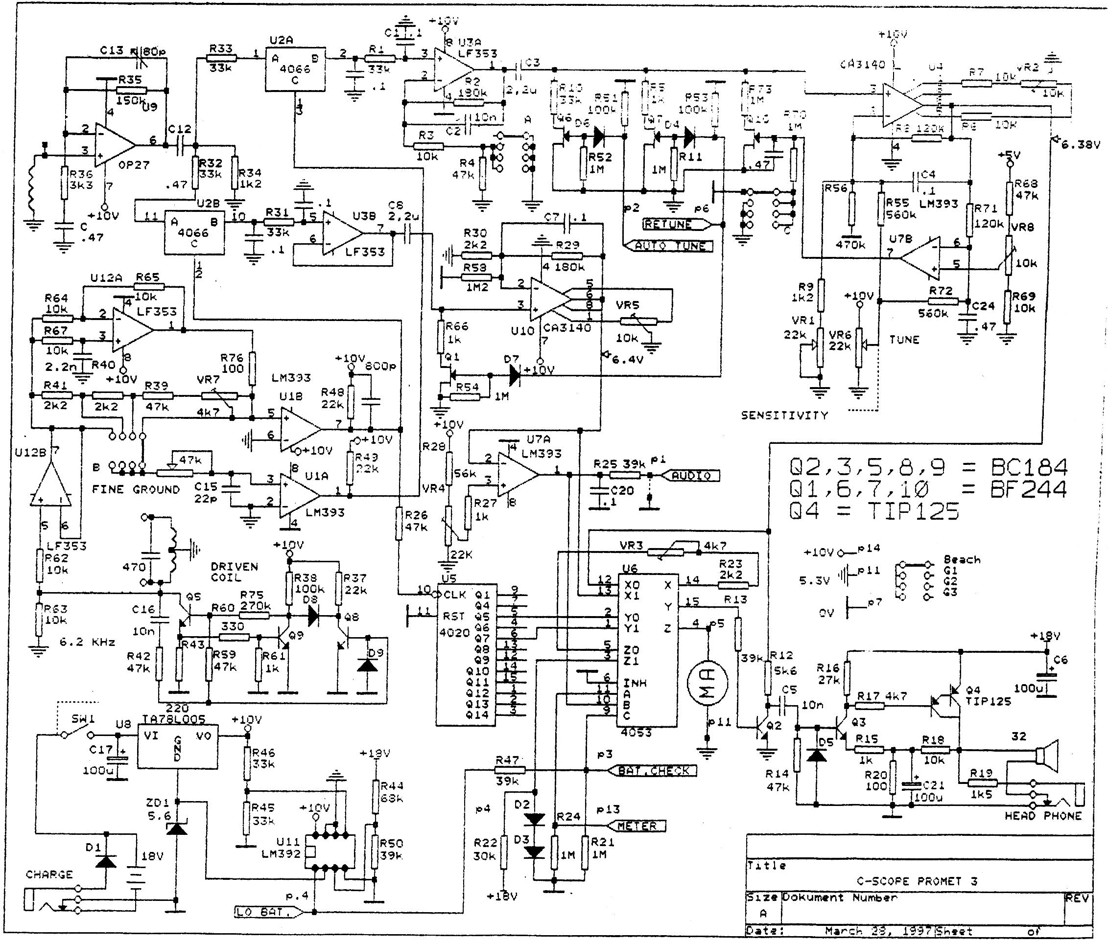

    I have a cscope spoiled . but my big problem is that i have not the part list or better than say have not the shematic
    I put the pictures and films of this.
    yes I need the part list because a few part of this on board cut.

        C-scope schematic.Click image for larger version
Name:	C-SCOPE PROMET3.JPG
          Hi scs
          is that shematic of cscope 3000 or vlf tr3000?
          is that ok?
          thanks
            now I check it but it is not shematic my detector.

                There is nothing on schematics of CScope, they keep it a secret. I am looking for an VLF-TR 990b schematic and no response.
