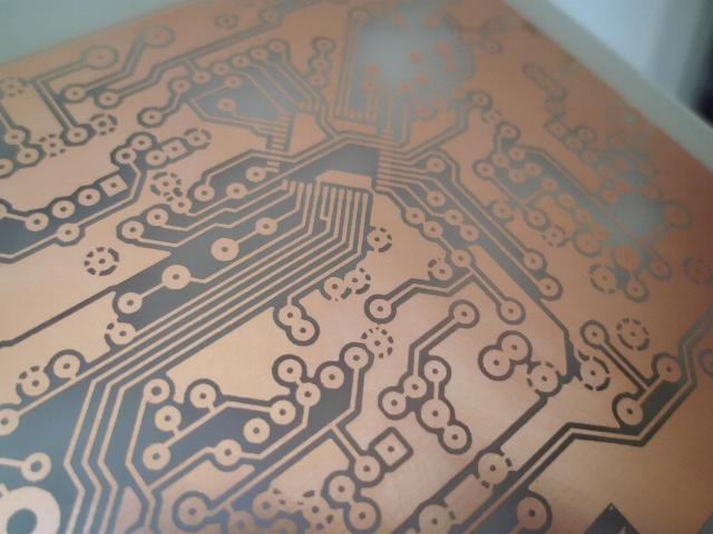

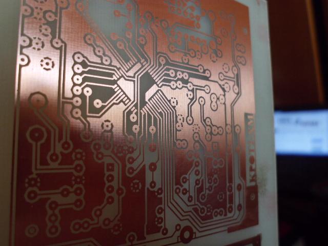

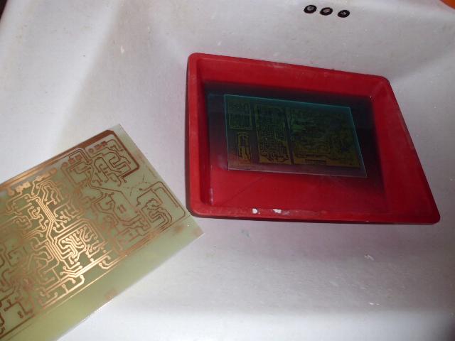

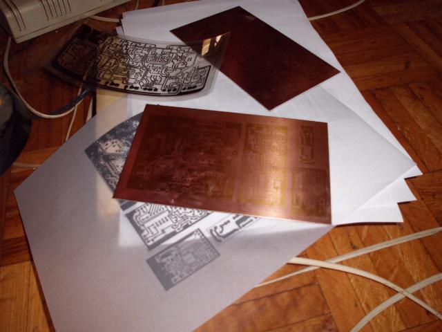

            • KROT(s) in the making
              This posts may be interesting for someone. This build is absolutely “worst case scenario” from PCB making to finished boards: Usually I make proper Linotronic film for PCBs, but this time it is printed on cheapest possible 50$ laser printer with refilled cartridge. Usually my friend does PCB production (using hand made but still relatively decent equipment) for prototypes, this time I made them myself. With some bathroom witchcraft chemistry, end result is relatively good.

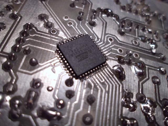

              • Now, I really hate this part. Soon everything will be in BGA package, making any hand assembly nearly impossible. Actually, soldering this SMD package is not problematic at all, if you have proper tools, good soldering iron with good tip, right type of flux and tin etc. But using cheap hobby tools can be problematic, with good chance to ruin PCB and most probably the chip.

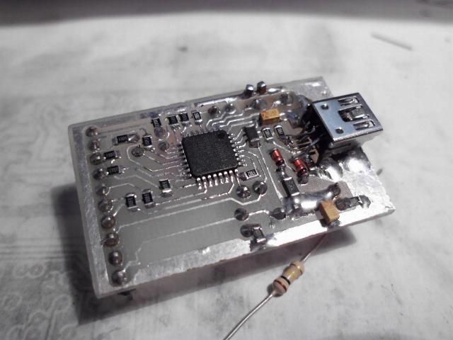

                • Programmer
                  One more useful tool, programmer. To be clear, this is pure waste of time, for something like 20$ you can buy working factory made unit with same or more functionality, but if you are DIY-hard, it works, assembled and programmed according to original Russian website instructions. I programmed my KROT chip earlier, using factory made programmer, built this one for other purposes. After all, if I have to make boards, install small chips etc, one more won't be a problem. I had two problems during assembly, first one, broken data line from USB (not having SMD connector for mini USB, I used standard one, with one pin broken) Interestingly, computer recognized it, but communication failed, I expected this wont work at all. Another problem was incorrectly installed SMD resistor, shorting one PDI line to GND, so programmer was unable to actually program anything. All this fixed in matter of minutes using scope, everything tested and 100% working.

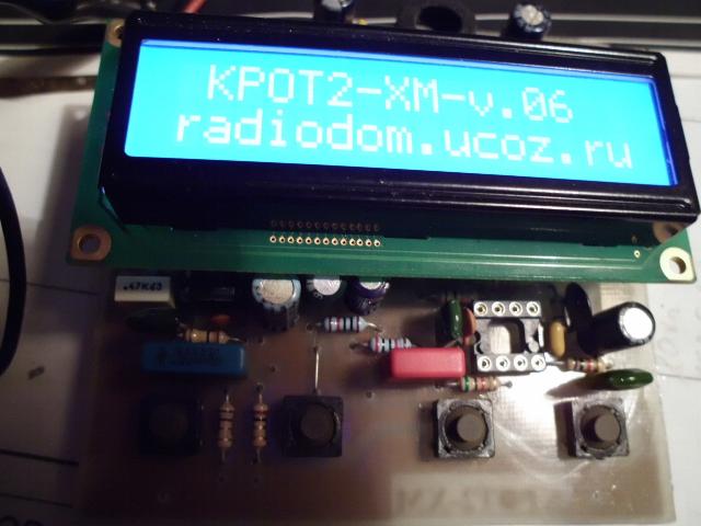

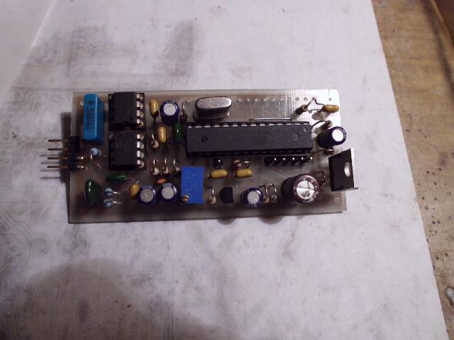

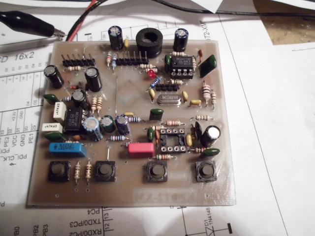

                  • As I mentioned, “worst case scenario” build, almost all parts, except maybe resistors, removed from old boards from my junkbox, this is prototype, who care how it looks like. Not the best hardware ever made, but at least working one. Current status of improvisation: I don't have MCP601, so instead i'm using 1\2 of MCP602 in socket, not quite aesthetic solution, but works, also LDO is small SMD type, tends to overheat, i'm powering board mostly from 3.3V PSU directly. And most important, proper coil. I tested this with some improvised coils, but first thing to do is to made proper coil to original specifications. I checked status of all “resources”, wire, epoxy etc so soon I can test this with normal coil.

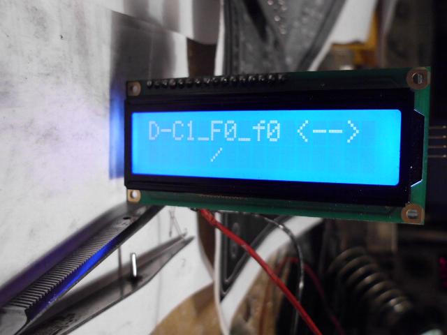

                    • And naturally, my favorite, KROT1, probably best DIY design ever, up and running. Now i'm using some older version software, but have few spare chips around, will program them to compare different versions. Also to compare KROT1 and KROT2 directly, using same coil. Earlier I posted PCB file for this detector (bit modified), I have to add few comments. PCB and modification is good, but pay attention to display type. Now i'm using Winstar display (available from mikroe.com), cheap and very good one but PCB is designed for some old obsolete type I used earlier, actually removed from some old equipment, so: Contrast adjusting resistor must go to GND, on PCB connected to +5V for old display, and remove connections from 4 unused data lines on display to GND. Usually this is not important for most displays, some types actually wont work without this, but Winstar wont work with these lines connected to GND, so just cut them off.

                              • Originally posted by Tepco View Post
                                Hi Tepco
                                You make very nice DIP version of KROT-2 PCB and finished board too.
                                Awaiting for your further reports on KROT-1 and KROT-2 results and comparisons.
