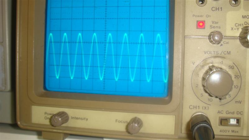

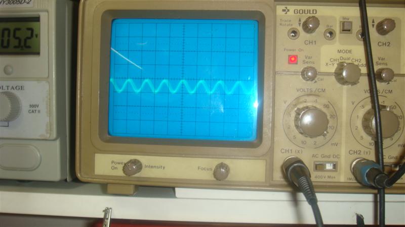

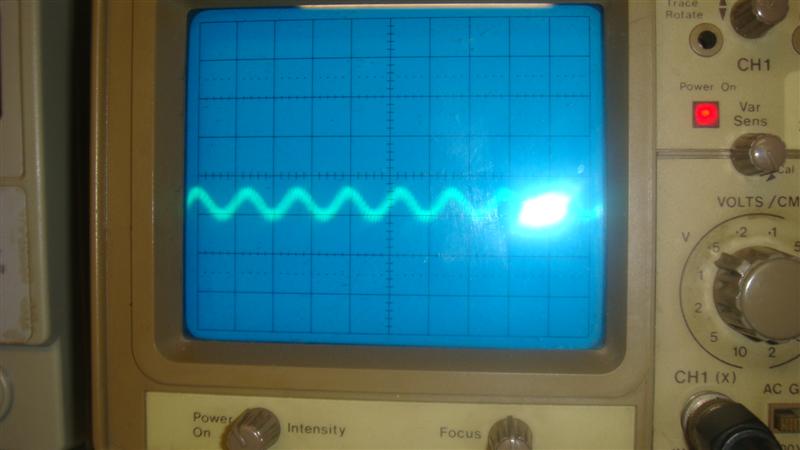

        Hi Andrew.
        It is not possible to make A=0 with MCP601 on board. With TL061 yes.....
        I attach 3 photos.
        First from input of Rx coil
        Second of pin6 of D2 with MCP601 on board and
        Third of pin6 of D2 with TL061.
        With TL061 the device works very good but has a lot of erratic signals "lot of sounds wear".
        Do you think that TL061 can be the problem??

                              Hi Andrew.
                              I attach 3 photos.
                              I don't know the version of firmware because WM6 has programmed it. Maybe he can tell us.
                              Hi Geo.
                              If you believe your pictures then you gain Сoefficient MCP601 =1, TL061 =2. Must be> 50 .... Ostsilogram connected with the coil? If the coil was not where the signal? After all, you probably have A = 0 do? TL061 certainly not suitable look for at least 18V.. Frequency gain of 1 MHz...
                              Try this:
                              Remove R13 and concluded with IN string any point U/2. (R7/R

                                Hi Andrew.
                                No,... gain at TL061 is about 75. At 3rd photo the selector is at 0.2V/ division and at 1st and 2nd at 10mv/ division...
                                TL061 is not a good replacement for MCP601 but i have not something better in my drawers.
                                Photos are with coil connected.
