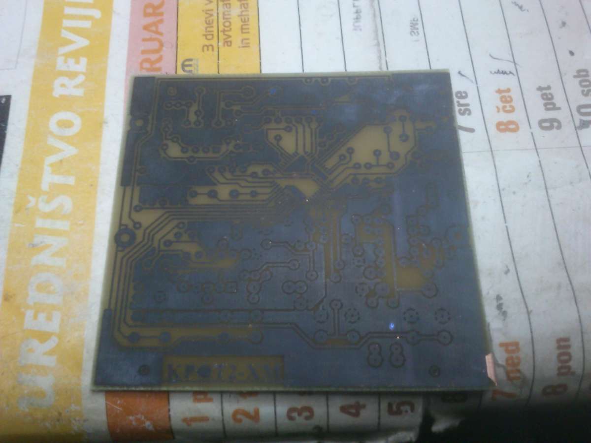

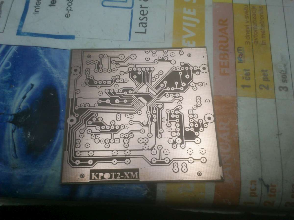

                    Today I have a little more time to do PCB for this detector. Well I take wrong file. T take file for THT elements not SMD
                    So if someone need PCB let me know (for free of course). Priority is given to Slovenian user because of ship cost.
                    LAY is taken direct from author page. I don't know if it the same like here!

                    • Nice PCB SimonS.
                      If I understand you correctly this THT (DIP) version, as on photos, is surplus, you now offer to interested members?
                      Then, you in fact intend to build SMD version?
                      You'll need a steady hand.

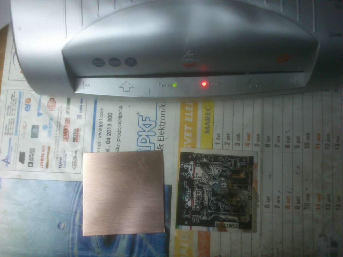

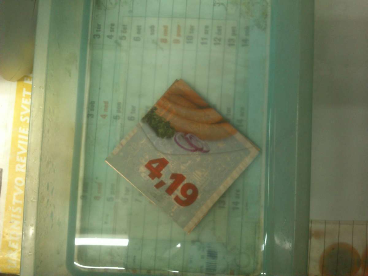

                        Hi Simons, very good work.
                        What kind of paper are you use??

                              • I use publicity paper. Not so important what you use.
                                For me is SMD much, much more simply, and less work when solding...
