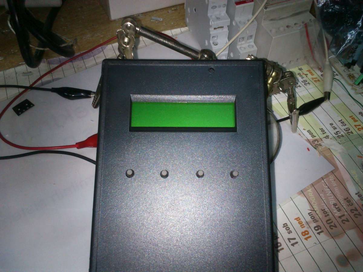

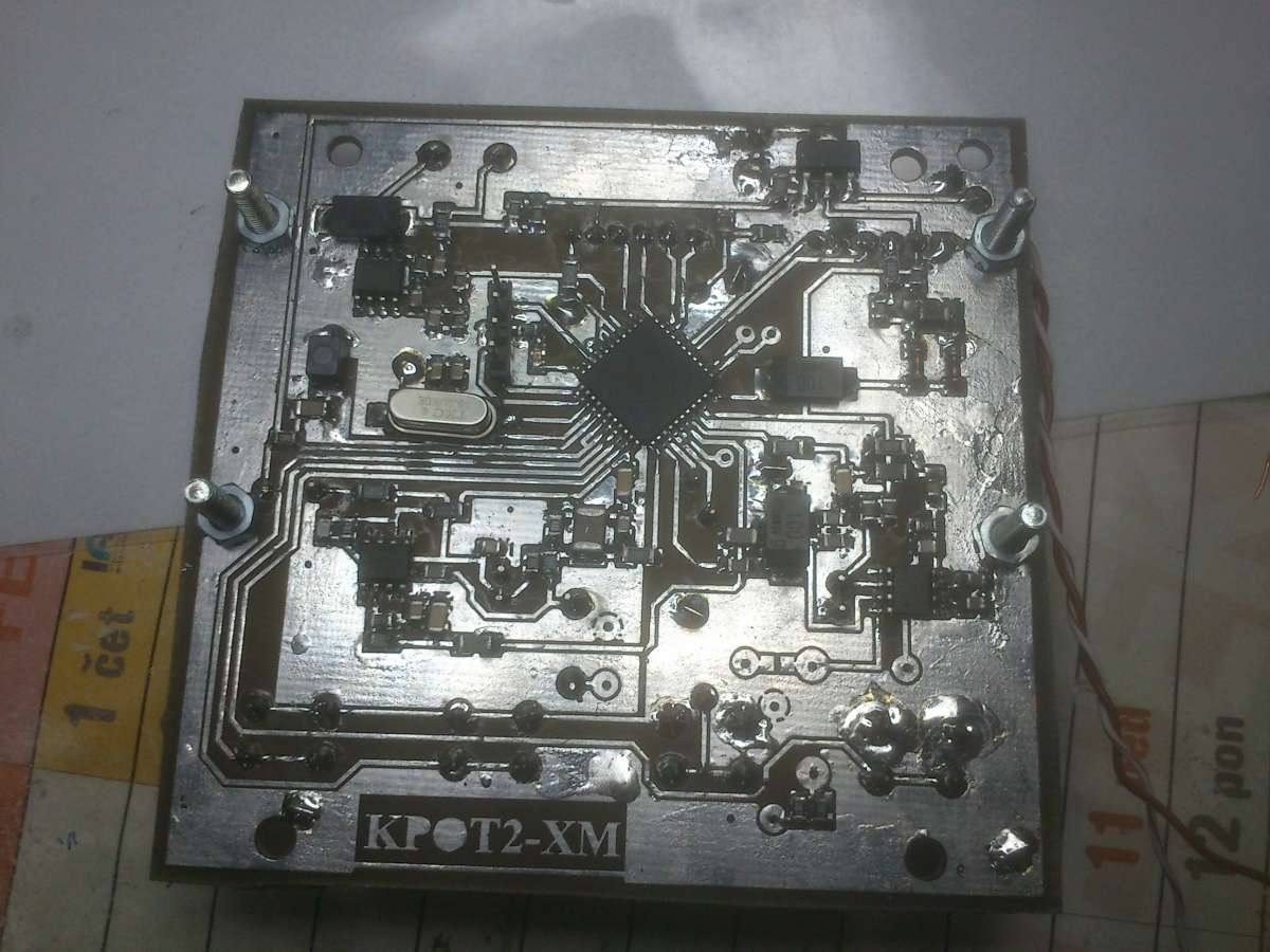

                  • Today I have some free time so I finish PCB. Now the hard think called the coil
ID:	339210Click image for larger version
                    • looks good
                      • Hey and what about this unstable erratic noisess only Geo has it ? Is this md stable outdoor?
                        • Originally posted by SimonS View Post
                          Good work SimonS, wish you all success with coil.

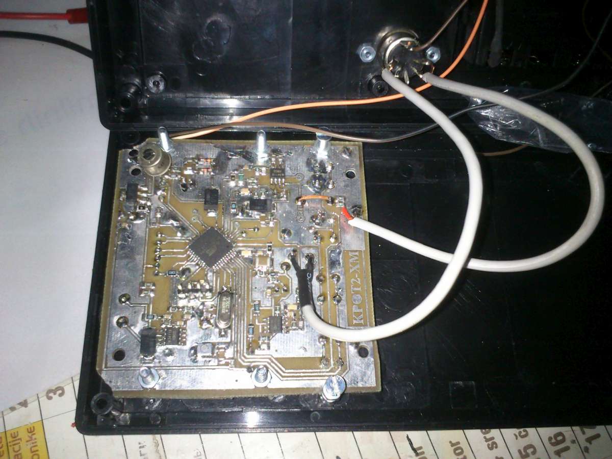

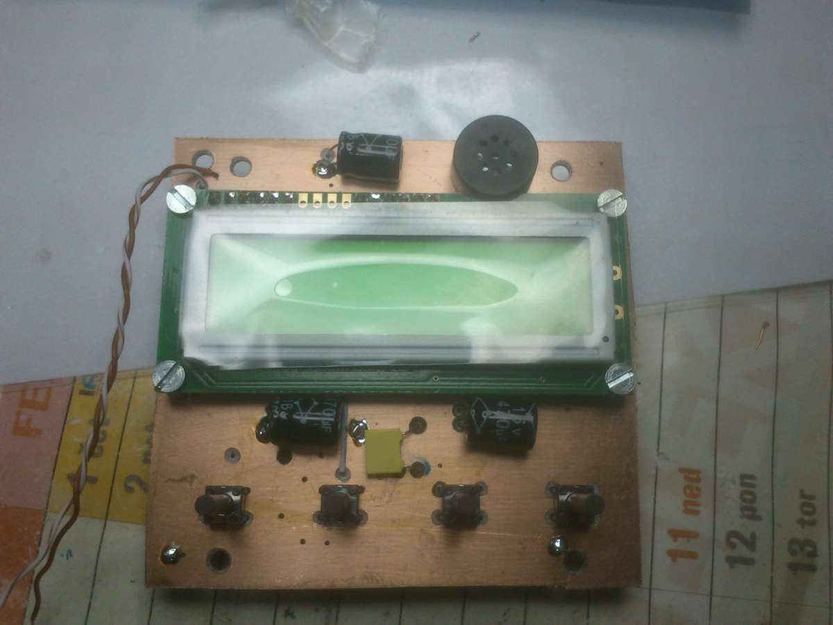

                            Today I do wire work and put PCB in box. Look good for now. I'm waiting for coil shell to finish this project.
                            I have one question. Where to connect shield of RX,TX cable? To GND or AGND?
                              Thanks!
                              Do you have cable with separate shielded RX and TX wires? Can you post photo of your cable (de-isolated at the end, to see structure)?
                              • sure. Here are photos.
                                Cable to connector are shield. Shield are connected to GND (on TX on GND, on RX to AGND)
                                Now problem where connected main cable and coil shell ? I think it is better to GND???
