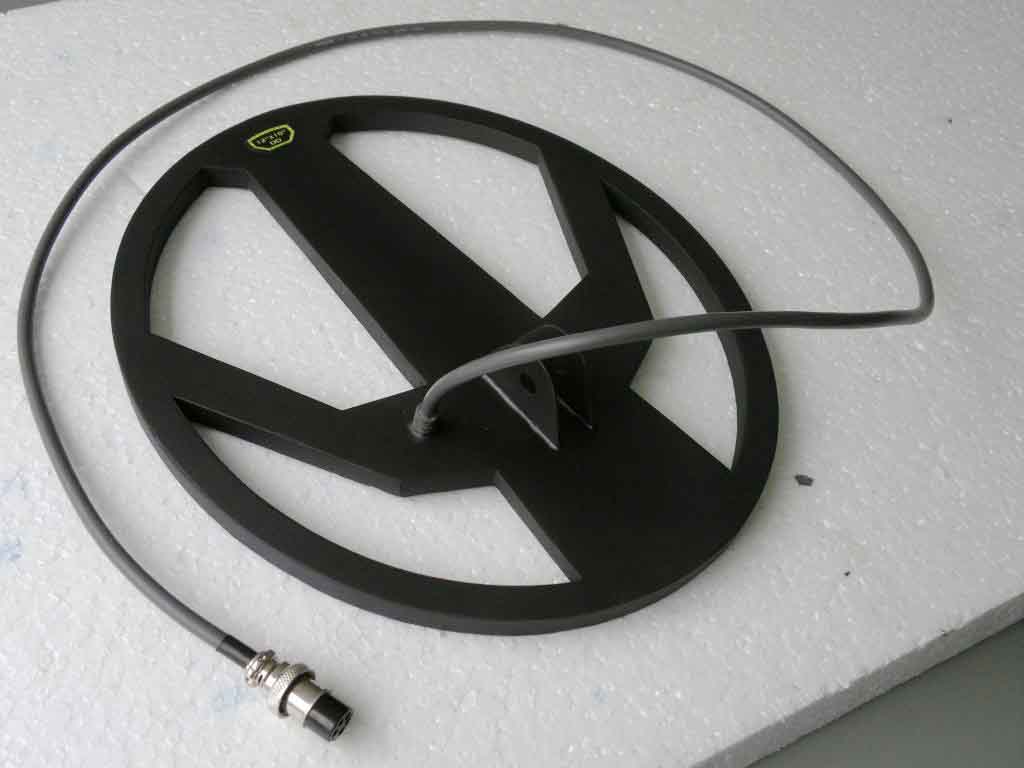

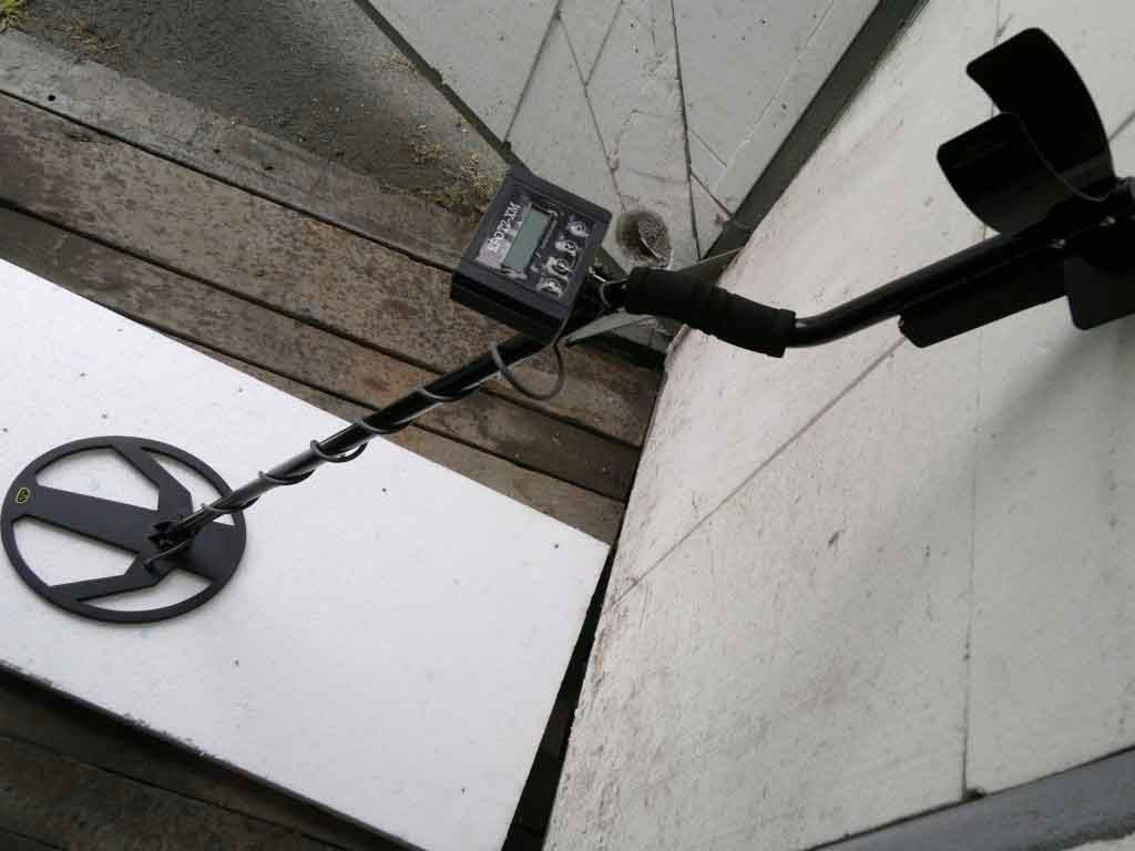

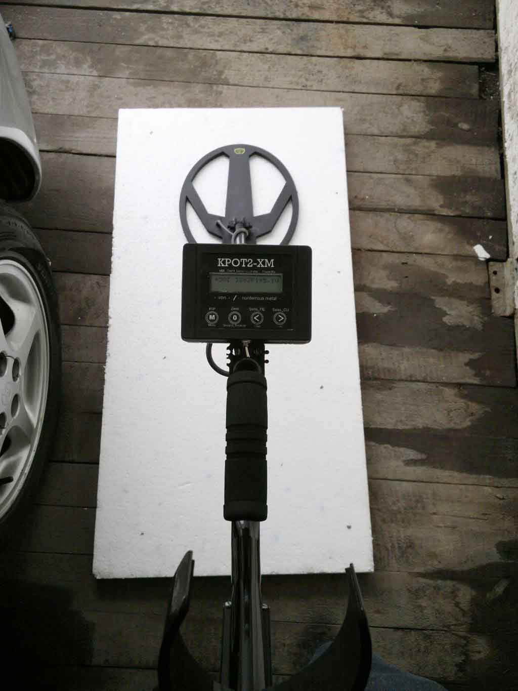

                    • And here is my Kpot
                      It is very stable outdoor, even on wet grass.
                      Andrew Thank You for sharing this project

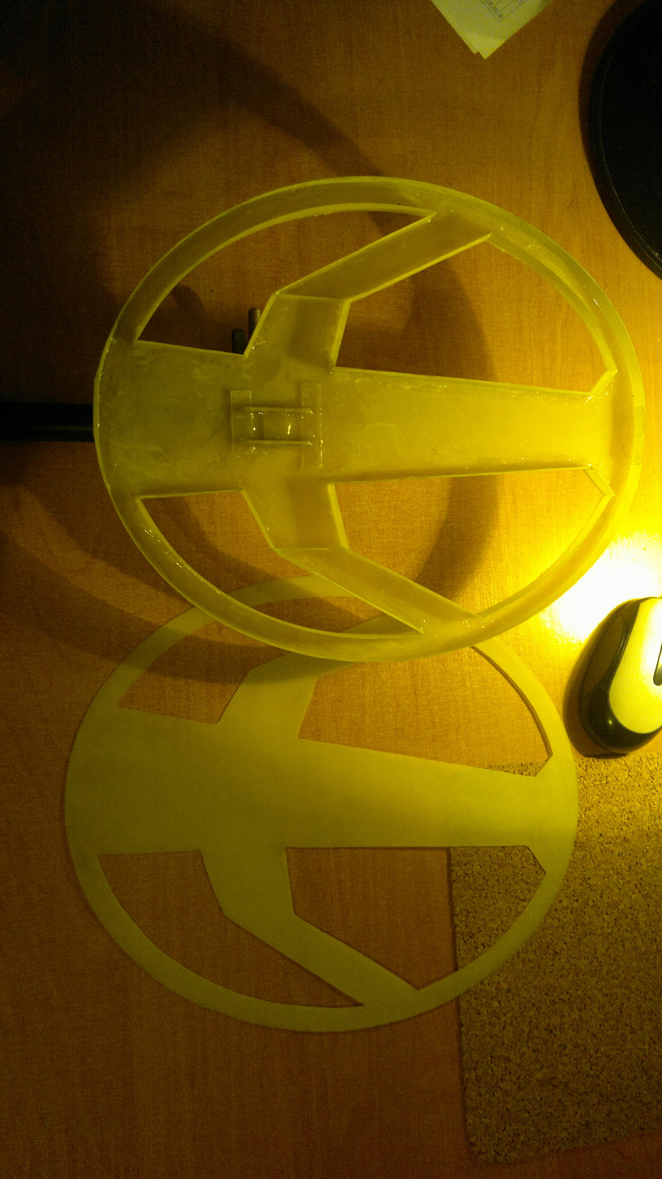

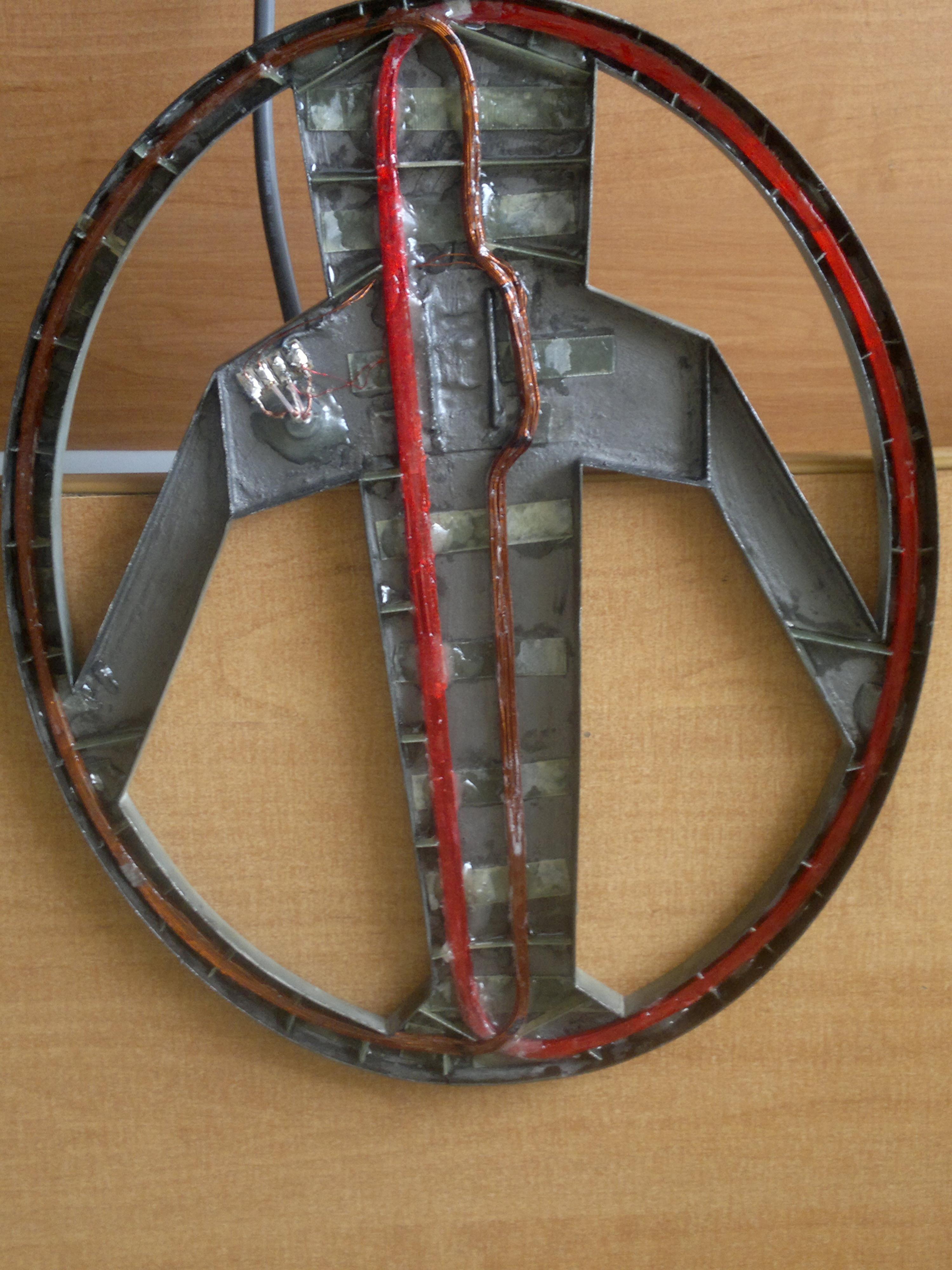

                      • Very beautiful! How did you do to the sensor housing. Describe in detail the technology.

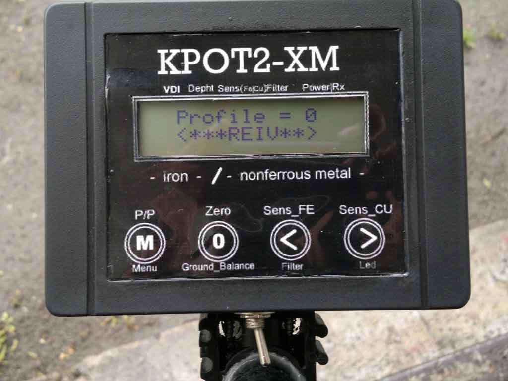

                        • What doing the switch at down side of box??? is it for operation at 3 frequencies???
                          • Originally posted by smity View Post
                            Sure
                            First cutting shapes from epoxy laminat sheets 1mm-up, 0.7mm-"walls" and down cover, then glue them with epoxy like that:
                            Glue contact wire and apply shield layers. I`m using pure graphit powder with varnish, after that glue spacers for coils (to be sure that coils wont contact the shield layer). Then glue coils with some strenghten peace of laminat, like that:
                            Coils can not touch shell.
                            At the end feel gaps with some kind of styro foam and glue down cover This coil is 30x25cm and weights only 400gr...
                            Geo it`s power switch.
