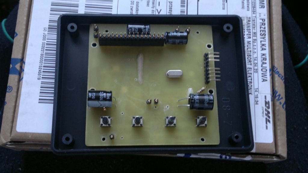

                      • Yes, I have V3.4 too and it is 100% correctly
                        At first start up had problem with contrast too (also 5V LCD, with white backlight) soe i play with R19 and R27. Maybe try to increse contrast at menu (I know that can`t see anything) but try:
                        turn on,wait at last beep,press and hold for second menu button,relase, then press it short 2 times more, and then right arrow to increse the contrast.
                        About Your chattering, first check if he beeps without coil, if yes problem is in components of PCB. Or You may try go outdoor only with PCB and battery and check if he will react different (maybe strong "noises" in Your appartament), if the same, problem with components. Maybe AD8091, hard to say, Mine KROT2XM without coil at sens. S22,gain-2 is totally quiet, S11-ocasionally beep.

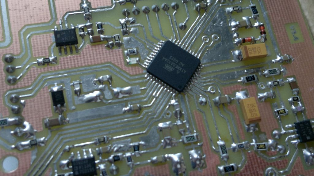

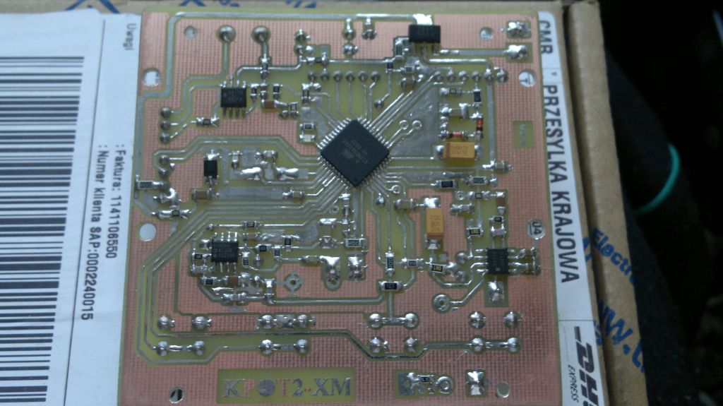

                        • krot2
                          Thanks for the picture Reiv, I noticed that you used two large 100 mfd. tantalum caps for C26 and C3. Could you tell me what values of R19 and R27 you ended up using? My detector is perfectly quiet without coil but starts beeping when I attach coil. Any close up picture of back side of board? thanks
                          • If, remember right R19=0 ohm, R27 no change.
                            Soe Your coil is faulty. What kind of cable (double shielded)? If moving cable and chatters are bigger-change it, concentric S-VHS is good. What value of Rx You have, and what kind of shielding U are using? Resonances are ok?

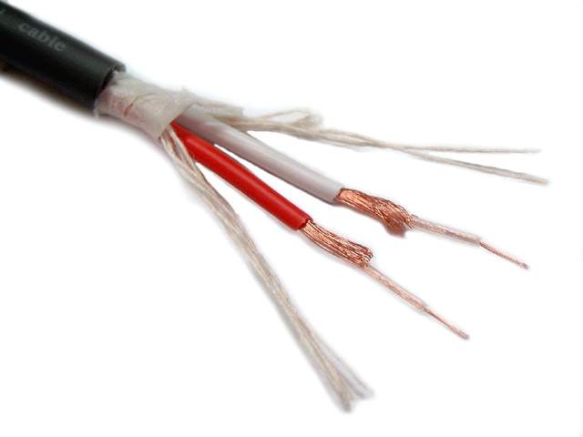

                            • krot2
                              Thank you for the pictures! I got the display to work on 3.3V i put a 25k pot at r19 and it ranged in around 3.5k for good contrast. I left R27 at 10k. So now its back to fix the beeping. I think it is a cheap S video cable. two sheilded cables in side, but no outer shield. my other cable I tried is two double shielded with an outer shield but still beeped! I only made calculations on the coils by using an inductance meter. It seems to use the most current at 8khz. So I assume thats where its working most efficiently. But I dont have any way to check the actual resonance.
                              • My cable S-VHS is build like this, and works perfectly:
                                No need to use inductance meter, just simple generator and osciloscope with Your LC circut, check were is max amplitude at wich freq. When Your Tx has 8kHz, Rx must be about 6.5kHz. What is Your Rx voltage measuring by KROT display?
