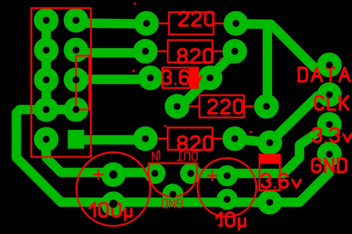

    • whats the difference between an ATXMEGA32A4 and an ATXMEGA32A? Ive got a USBASP programmer, whats the wiring diagram for that I Have looked at the link for that above and cannot find the right wiring diagram.
      • ATXMEGA32A4 can be programmed only through the 2 chanel PDI , Program and Debug Interface
        • You can modify USBASP to handle PDI and Standard AVR protocol.
          You need to make an adapter board such as the link above and add a 3.3v regulator
          On vcc. Then, you need to update the firmware of usbasp with a second one.
          Then, you can program XMEGA.
          I did the board but i didn't update the firmware cause now, i have ATMEL ICE.
          I'll share the layout later
          • But an atxmega32a-au can be used with this project ?
            • I think not. atxmega32a-au it is different.
              • PDI adapter for USBASP
                As promise, i share the layout file and the placement of the PDI adapter board for USBASP.
                To use it, you need to update the USBASP firmware with a secondUSBASP device and also update AVRDUDE. See the link HERE

                  I have the usbasp version where I can switch to 3.3v using a jumper. Do I proceed with the original plan you posted above ?
                  • Hi,
                    By switching the power supply, you'll only put 3.3v on VCC of the 10 pins port. The outputs of the ATMEGA8 of the USBASP will still be 5v, this will cause to burn the inputs of your XMEGA.
                    You have two solutions :
                    1st : You put the jumper on 3.3v an you add an adapter board with the resistors and the zener diodes
                    2nd : You keep the 5v jumper and you add an adapter board with a 3.3v regulator, the resistors and the zener diodes.
                    I would prefere the second one cause you can program ATMEGA and XMEGA without making mods to your USBASP.
                    But it's up to you ..
