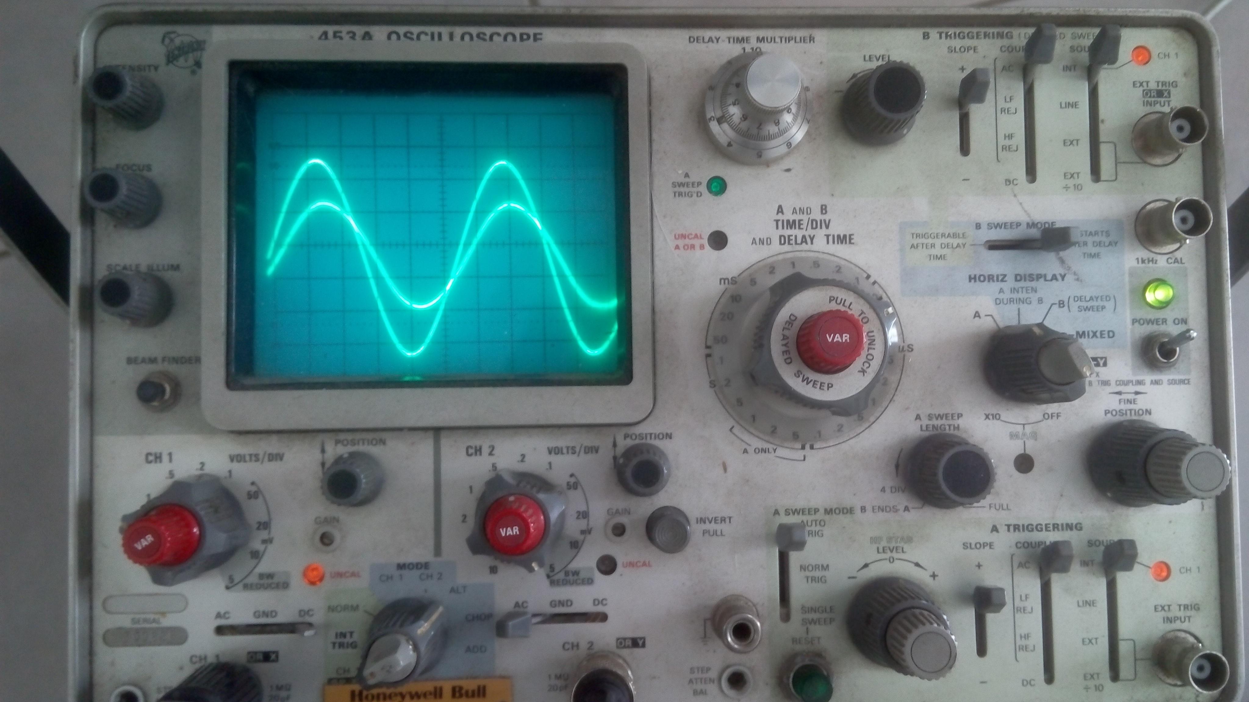

    • Hi,
      I made a nex RX coil (155 turns of 0.15mm L=15.9mH, R=106ohm).
      I use for TX circuit 249nF for my 45 turns of 0.4mm (1.06mH, 3.5ohm).
      The coil nulling is now easy, i can reach a 10mv A/C and RX lags TX of 20°.
      With my coil nulled (Oscilloscope view : Click image for larger version
      , i still have 500mv displayed for RX. I heard it should be near ZERO ??
      My settings are :
      Firmware : K2 GAIN SGOLD
      Frequency : 10022HZ
      RX : 519mV
      Gain : 2
      Power : 67mA (Maximum)
      Is it normal ? I did the tuning as the TGSL project, is it the same principle for KROT project ?

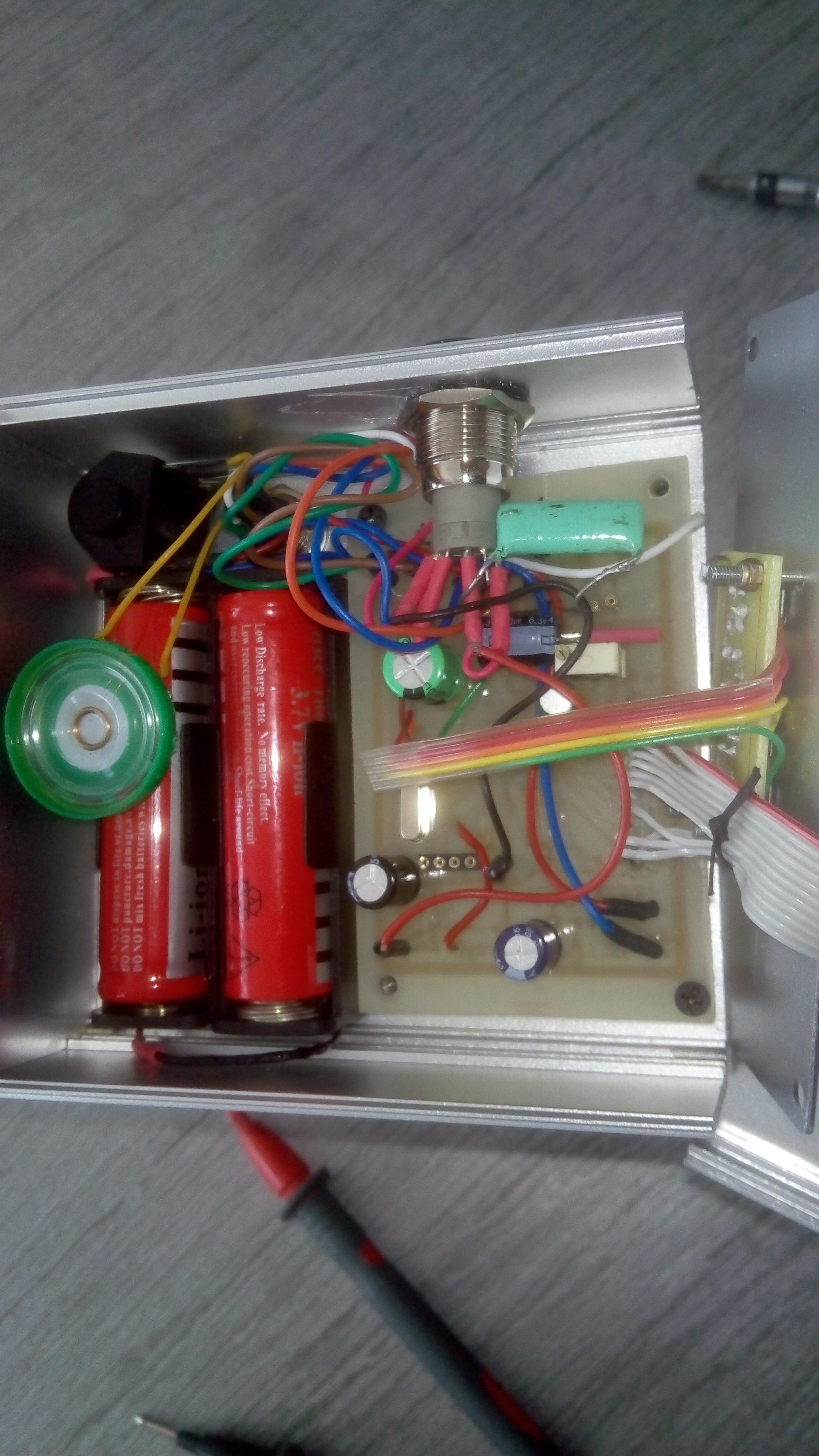

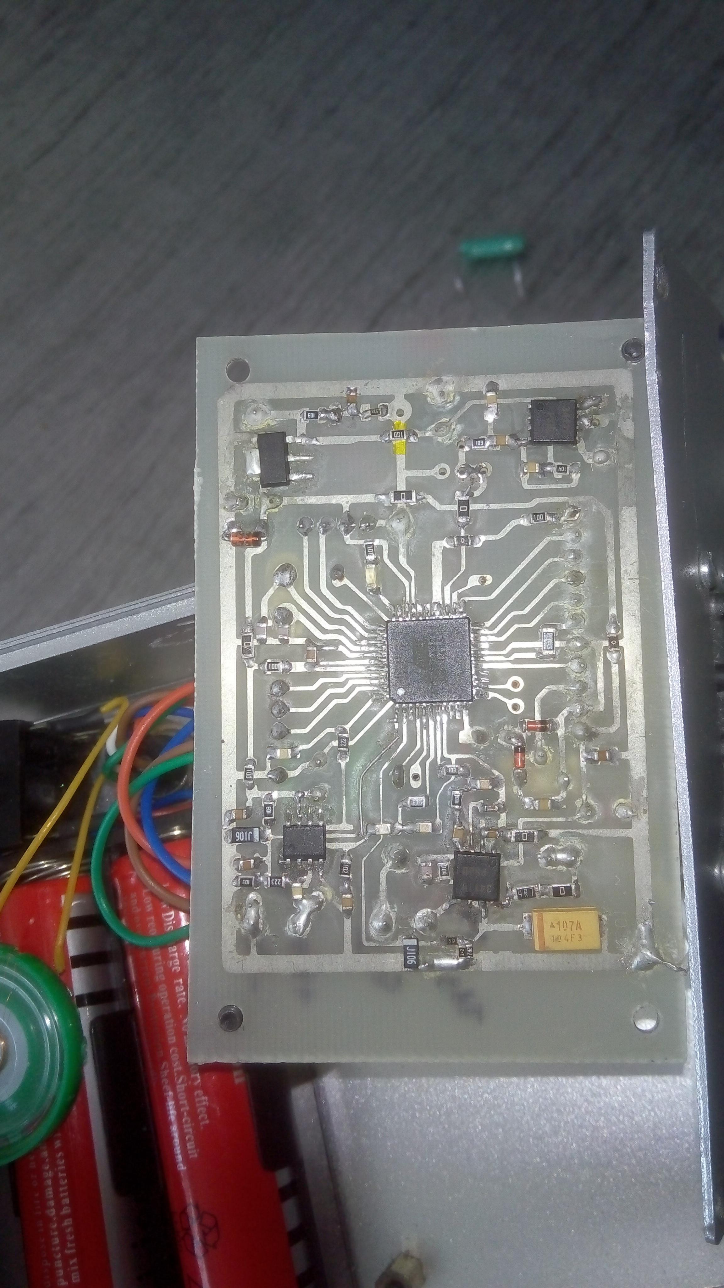

      Here are some pictures of my board : Click image for larger version
ID:	345655 Click image for larger version
      OCBSLIMZ : Have you done your coils ?
      Any help would be appeciate, i'n not far from gold rush ...
      • ...Power : 67mA (Maximum)
        If this value is obtained after starting automatic setting for Tx frequency , I -Tx can be increased by connecting in 1-3 and reduce R4 .
        • My TX is already connected to 1-3 and R4 is measured at 5 ohms. My coil resistance is 3.5 ohm.
          Is there a "limit" value i shouldn't go below ?
          I'll try with 2 ohms to see the difference.
          • My R4 - 1 ohm. Set R5 low value , approximately 15 k or 10k . Try set - turbo mode and M - meandre not S - sinus .

              My RX is around 350 without the coil .... Maybe the firmware? ?
              • Originally posted by reptooyep View Post
                try another mc34119
