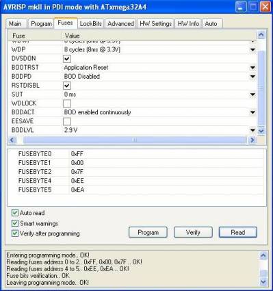

            • Hi,
              Is there any correct fuse should i use, programed and verify sucessfully, my board only show blank square dot and continous beep sound, using mr.blobber dip board mod.
              • fuse ATXMEGA32A4

                      fuse ATXMEGA32A4
                      [ATTACH]38347[/ATTACH]
                      I use that fuse configuration, but not working, anyone know what software author use to program?

                        • I use that fuse configuration, but not working, anyone know what software author use to program?
                          Atmel Studio7

                            • hi ripsdevala
                              if you use AVR STUDIO and avr isp mkII programmer those fuses must work! Do you properly configure programmer?
                              • Originally posted by cvele View Post
                                hi ripsdevala
                                I use studio 5, and diy avrisp, avrisp mkII is detected can read and write, proper 3.3 voltage, and use avr programing button. Is there any configuration i dont know?
