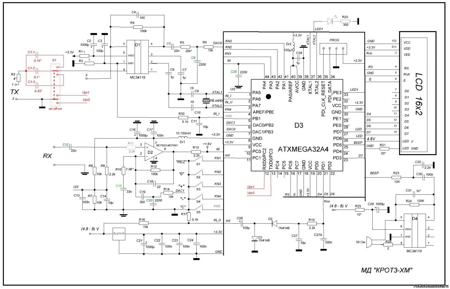

'KROT2-XM' (mole), new project Xmega32
  • Try this ... Hold down the +, -, 0 buttons and apply power.
    • Thankyou smity,
      yes I tried the reset function, but nothing.
      I wonder, because after firmeware changing yesterday, I was able to go into the menu for some minutes, before it switched into the frozen volume.
      There is also no TX signal.
      I know, that the TX signal should be there also without coil.
      • Sorry, I get a clear 10 khz TX signal, when I start the Krot for some seconds, as shown in the video. Also RX stage is working normal pin 6 on MCP601. But signals switched off, when the frozen volume comes.
        I replaced both MC34119D, with the same result.
        So I think the problem is xmega

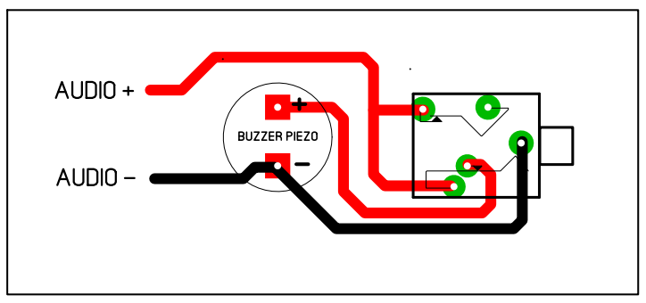

                • Can someone say if this circuit is correct?
                  I want to integrate a few earphones and that have sound in both sides.
Name:	pos conection jack.PNG
                  • this type is transparent and you can see contacts closed-unclosed inside
                    • Thank you
