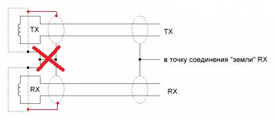

                  In the scheme of connecting the coil probably a mistake. Do not connect shields made ​​TX PX in the sensor housing. This should be done in the connector.

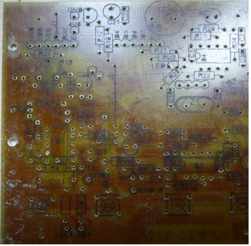

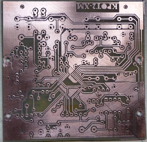

                          I ve tried to make pcb not bad results but hard to make ..tracks very near each other and thin even with UV etching hard job
                          hope someone very skilled deign again wider pcb ..someone did?
ID:	338162Click image for larger version
