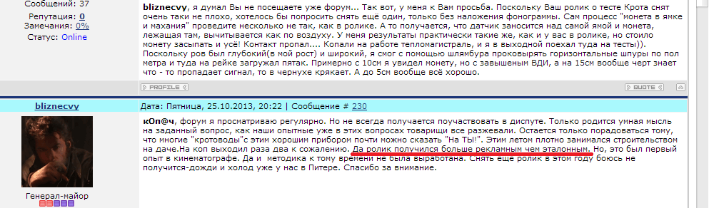

  • I study subject the device to the author's website. Test video http://www.youtube.com/watch?v=-09HEuCwxHE it is advertising. The author says this is the video itself.
    You need a video?
    • Originally posted by Black Digger View Post
      [ATTACH]27022[/ATTACH]
      You need a video?
      Please can you explain what writes here because translator don't work... ""video.png"""
      • **Yes movie get more publicity than the reference** - a translation of the word-for-word

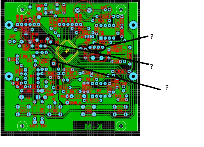

          • what is thats?
            • Upper two points are RXD\TXD from MCU, not needed, probably used in development stage, can be ignored. Right 4 pins are PDI interface, novelty in Atmel series, for programming\debugging. Lower left pin is PP\ static switch for pinpoint mode.
