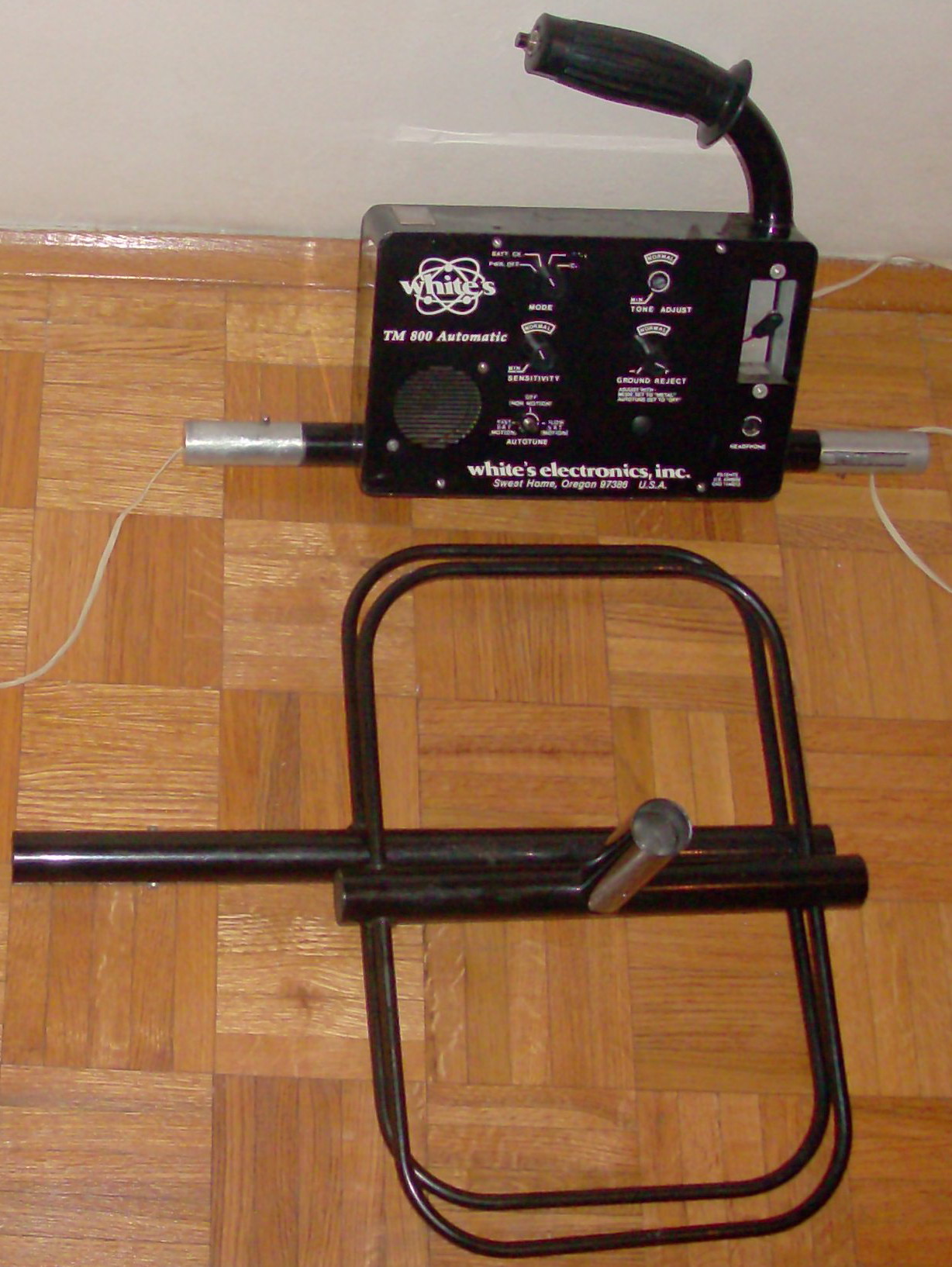

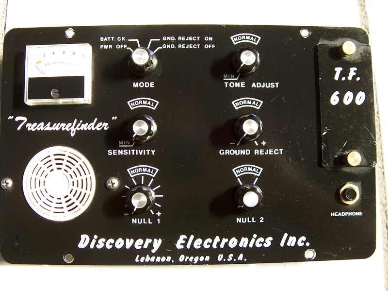

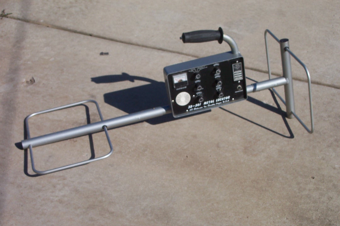

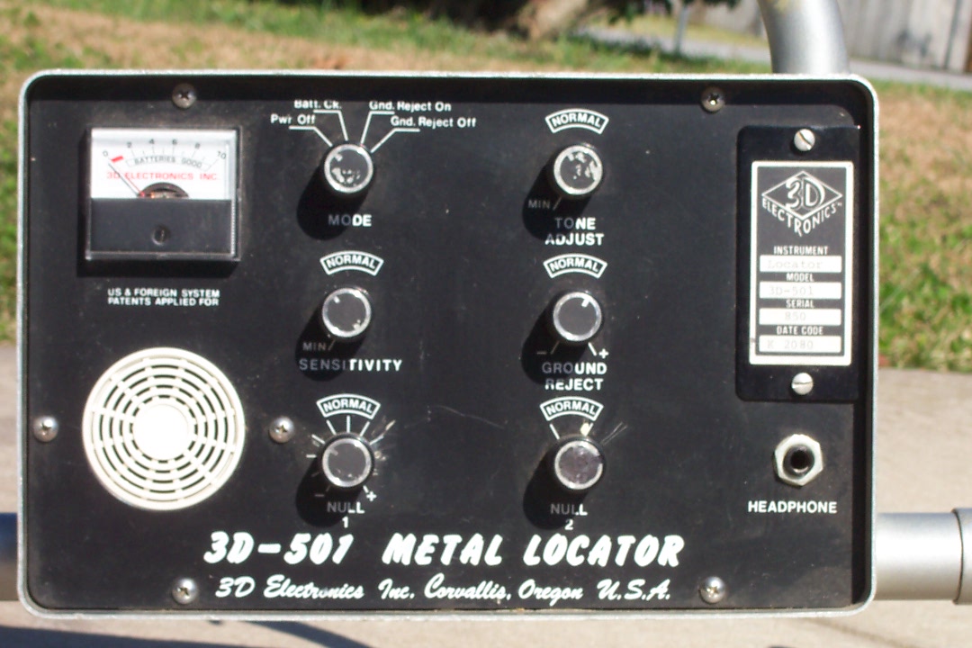

                          is TM800 same as 'Discovery' TF600 'treasurefinder' inside?

                              I to would like to know if they were all the same inside
                              Interesting all three models/manufactures were in Oregon.
                              Were the made under license or are the copies/clones.
                              Is there any advantage of a two box over a pulse with a large coil.
                              Not sure how the coils are constructed from the schematics
