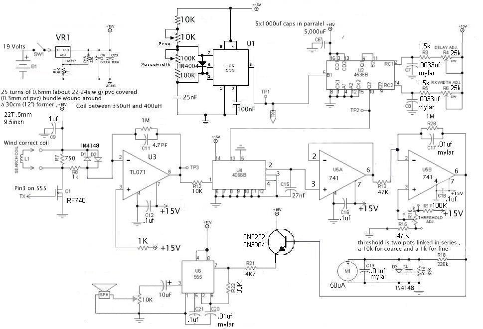

    I've been gathering up the parts needed to build one of these and keep seeing something in the schematics that's a little confusing. Good chance one of the many experienced guru's on here can help clear it up for me.

    U6 (555 for audio out stage) seems to be excess baggage, that is, why couldn't you just connect the cap. on pin 3 directly to the transistor's emitter that's driving U6 and do away with the 555 altogether?
    Appreciate any insight.
    Dan
    It's because U6 is used to generate the audio tone. Also, it appears to be a VCO, whereby the audio frequency will vary depending on the strength of the target signal. Without the 555, it would either just give a "click" in the speaker, or you may not hear anything at all.
      Thanks. After I posted I thought about it more and went back to hit a "delete post" button but didn't find one. Makes sense.
      Appreciate your help! Cheers,
      Dan

            the "blind squirrel" jpg is the modified for simplicity one that was posted on another forum.
            i used a cd4098 instead of the 4538 so timing caps will need to be differnt values.
            we never got it finished,
            theres no "ballance" on the tl 071,
            r12 wants to be 2.2k,
            and i ended up opting for an opto intead of the npn to the 555 vco.
            im quite happy with mine,
            use it regularly no problems,
            poss best sticking to original design from old radio builder and just substitute clock chip with the 555 arangement though.
            its non-motion but quite stable.
            recomend this easy logically aranged project to anyone for a 1st time build.
            mines a little bit over modified now though.

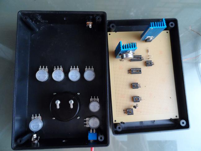

                Yes it is different than the "oldradiobuilder" design. Yesterday I got it built to the point of firing it up and after correcting a little mistake I made it appears to be working. I just dangled the coil off the edge of a box to keep it in the air and it detected my wedding band at about 10". I don't have an o'scope any more but could use a piezo buzzer to go through the circuit to detect oscillations where they should be and hear the frequency adjustment/width working. So far so good. Now on to building something to hold it all together. I think that I'm going with a waist mount battery (3X6volt) using SLA's. I see, depending on the frequency/pulsewidth adjustments, the current draw can be anywhere between 200ma and 500ma. An internal pack of rechargeables probably wouldn't last too long.

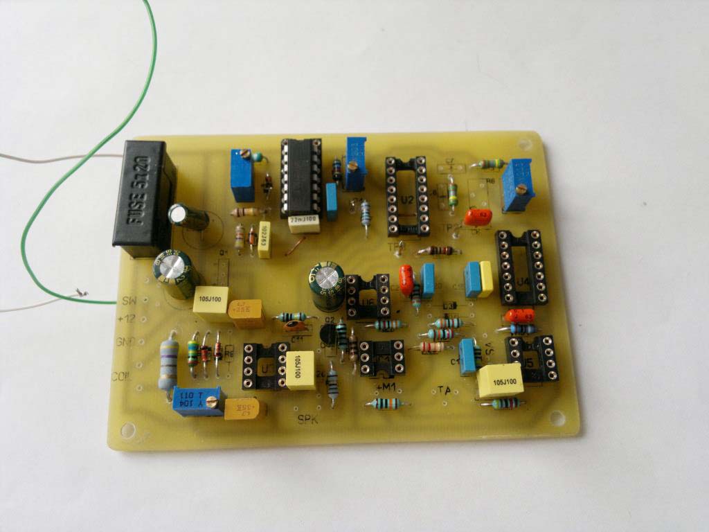

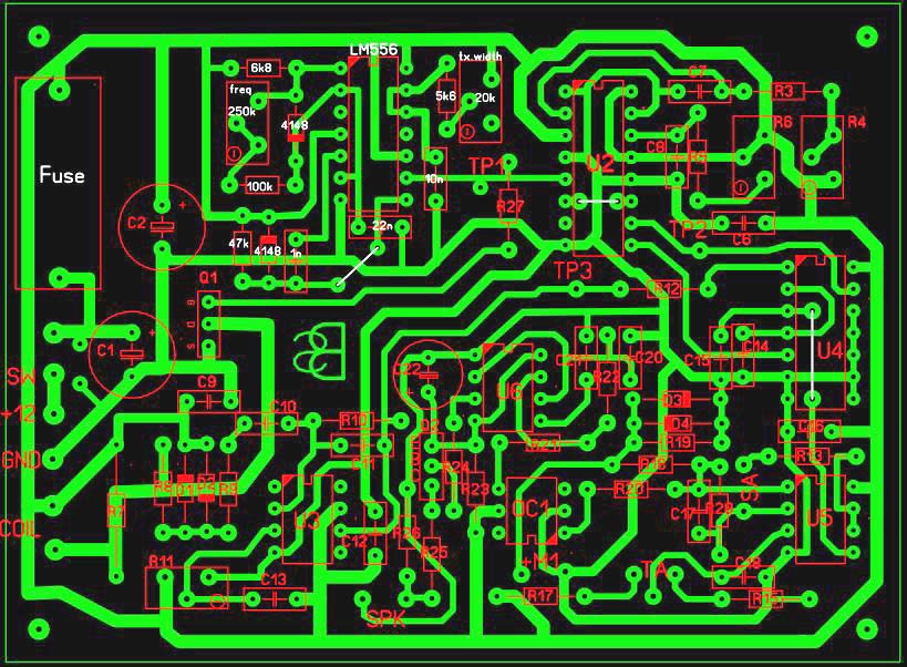

                        Hi
                        I`m finishing Blind too. I have changed only transmitter to get linear frequency regulation by poti. It is from Delta pulse and gives range about 196-600Hz and tx width from 30-150us.
                        Chears

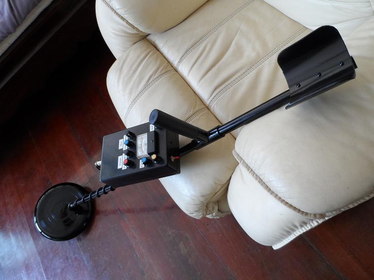

                          Looks good! I'm limited to some parts availability around here so I went with the 'generic' route using the 741's and all but it seems to be working. A bit overkill on the power section with mine. I used a 2n3055 (TO-3 case) regulated to 15 volts. All the articles I read indicated over an amp current draw so that ruled out using a 7815 but after seeing it come up and draw just over 1/2 an amp max. (depending on frequency/pulsewidth settings) made realize a 7815 would have been fine. Oh well.
                          I've been working on the coil cover and strut today. Getting close to field testing soon.
                          Good luck with yours!
                          Cheers.

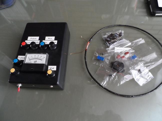

                            Need to run out and buy a couple SLA's then take it outside to try but it seems to be working with a bench pwr. supply.

                              nice job mate, what does the meter respond like?, i mentioned to a mate of mine who works in parts aquisition that i wanted a small u meter for a project and he gave me a box with 4 in i think they are samples as they are all slightly different but the same company, the box says no resale on it, anyway i did not want to add one to what i'm building if it just flicks to the end pointlessly.
                              so is it readable on the pi?.
