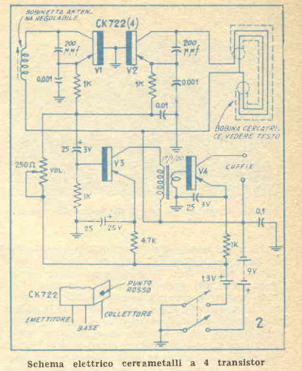

    I found an old schematic of a metal detetor 60s. would like to know if it would work and if it can be compared (performance) with other DIY metal present in this forum.

    I would also indicated a simple schematic, easy to build, with discrimination and that it is easy to calibrate.
    I also accept schematics containing pic of the 16 series that have good performance

    Probably, its a BFO MD, not really good in most cases.
      after Surf PI working bult to turn back to primitive BFO is not so right. I offer to pay attention on something more productive.
      leave it... do not waste a time...

            Look around, many to choose from, KT's suggestion of the Surf PI is a good one, it's analog and does not discriminate, but lots of people like it.
