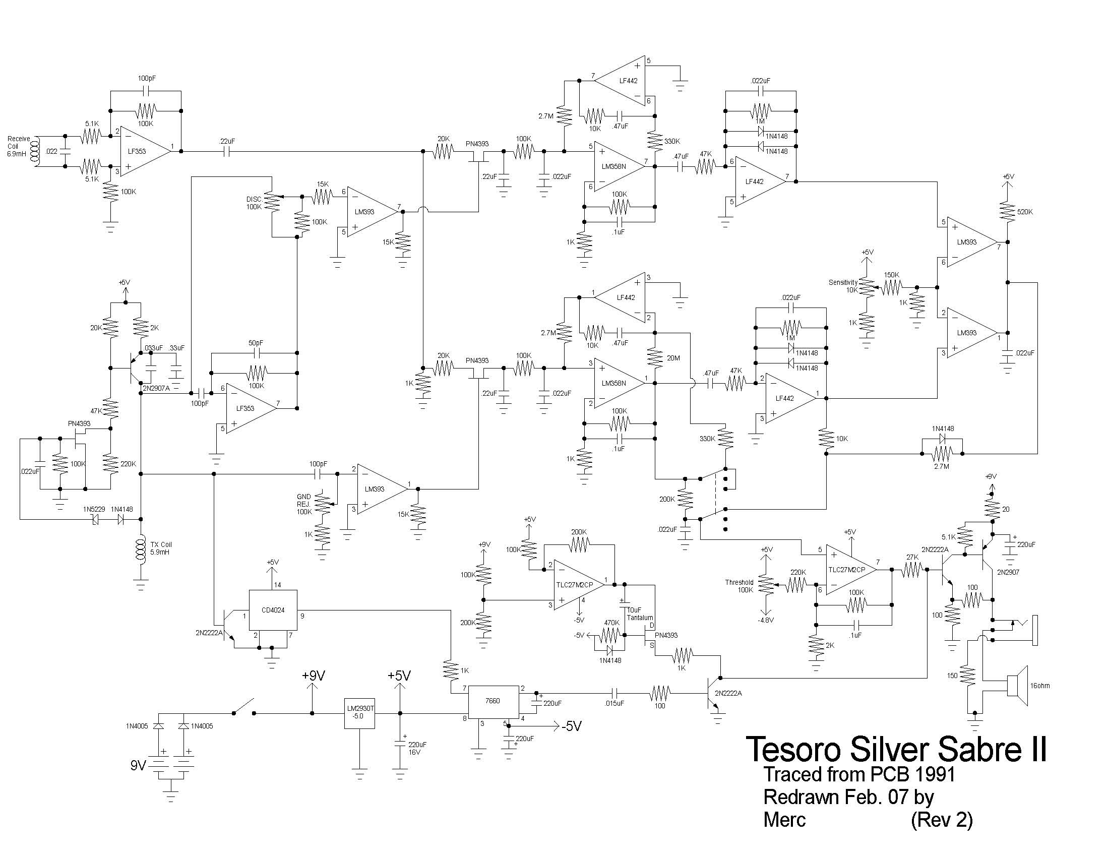

    Any One Have Drawing This PCB Layout can Share Here

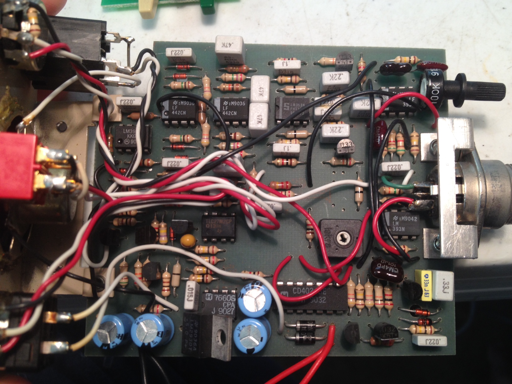

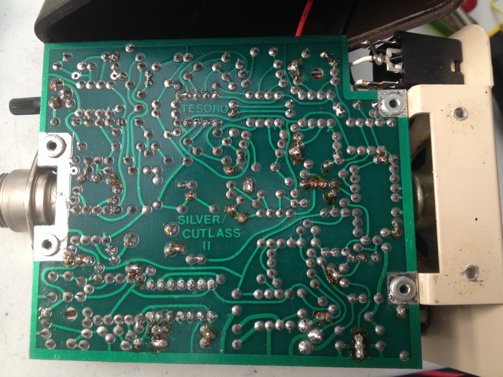

    I can take pictures of original PCB if that would help you.
      Yes show us a pic or two. We can check the schematic by eye as we've studied it so much!
        yea that is nice
          SS2 PCB pics
            Hmm the 27M2 is missing from my schematic. I didn't realize it ran on +- 5v like the Bandito.
            Without rail to rail opamps it must be giving away some depth... I lowered the supply on my
            TGSL and it lost a lot of depth!
              very clear picture
