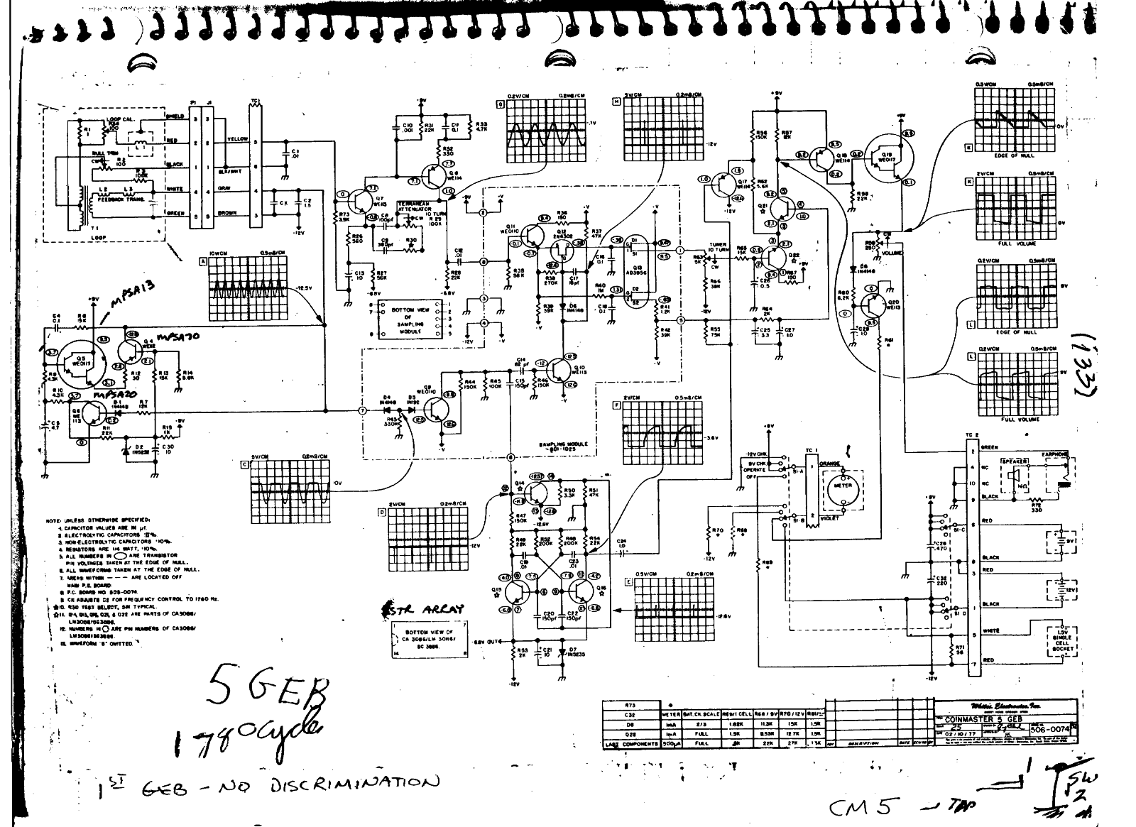

    Hi All, it's model CM5D (it's not the DB model), date code KP (would love to know actual date for that) and it works in GEB mode, but is wonked on all 3 Disc modes as far as I can tell (just gives loud tone all the time in high and medium, can't tune it, and low never tones, can't tune it either). Maybe it's me but I read the manual (ok quickly glossed it) ...

    So I thought I'd take a shot at repairing it, schematic would be so helpful. Also if anyone knows of any components that especially always need to be checked on these or just always replaced that would be helpful also. Any tuning info or voltage or signal test points/checks would be great.

    Is this what you're looking for?
        Thx much Qiaozhi, test points, waveforms, and all, cool!
        It looks though like that is for the earlier version CM5 which is similar to but different than the later version CM5/D (from what I understand the newer CM5 base circuit had the capability of having the discrimination added, & when added makes it the CM5D). I will hang on to that schematic for any part of it that looks to be in common, still seeking the CM5D schematic though...

          Hey Carl did you ever happen to come across the specifics of the CM5D tweek to higher freq for seeking gold? I'm thinking [in addition to the tx freq change and different coil] the receive preamp section with the TA control would need a tweek for the higher freq input? & maybe other tweeks?

            Except (complicated) coil, schematis is really nice piece of transistor era design.
