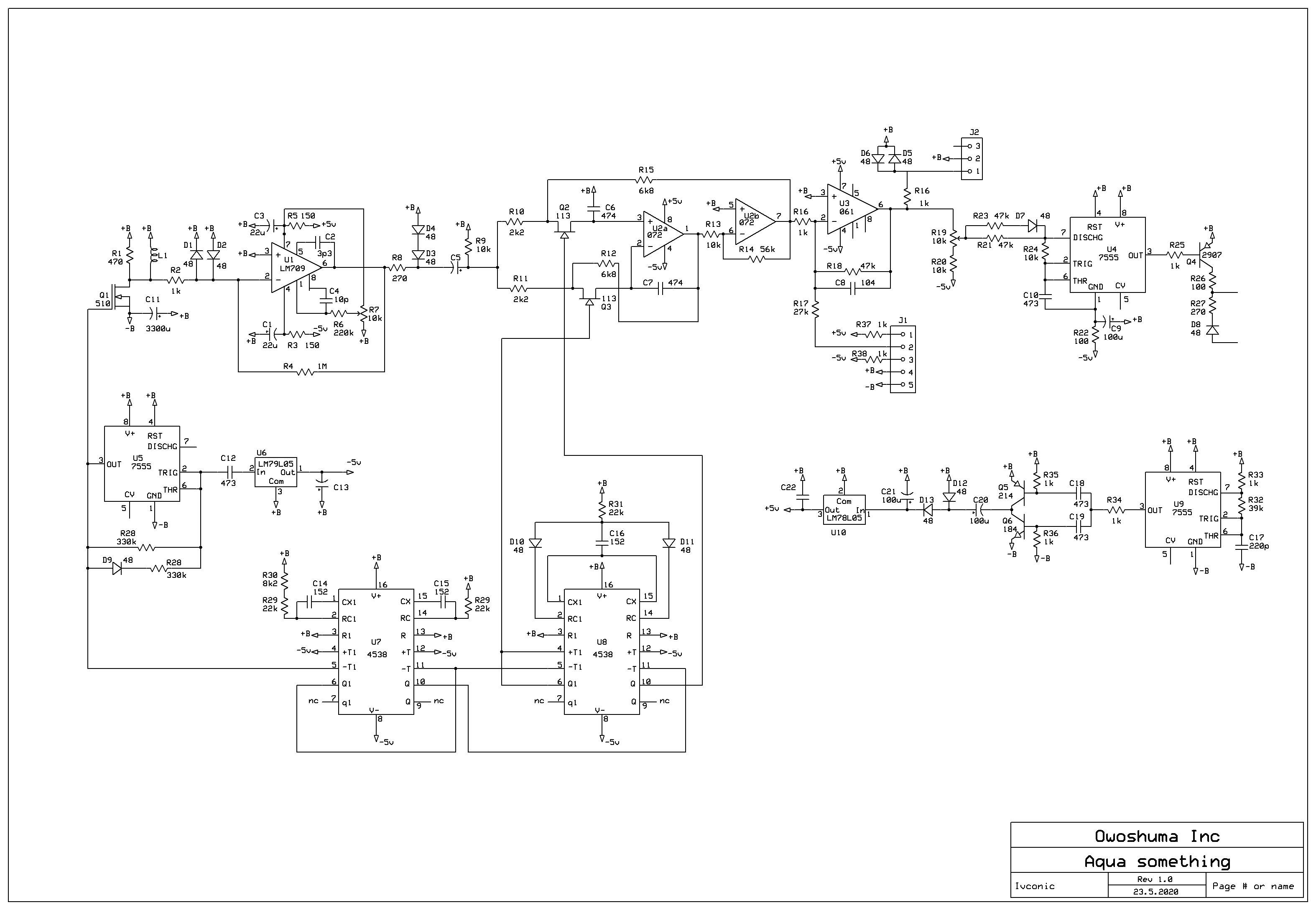

            From what's available i tried to put the schematic together. Probably will need some minor corrections:

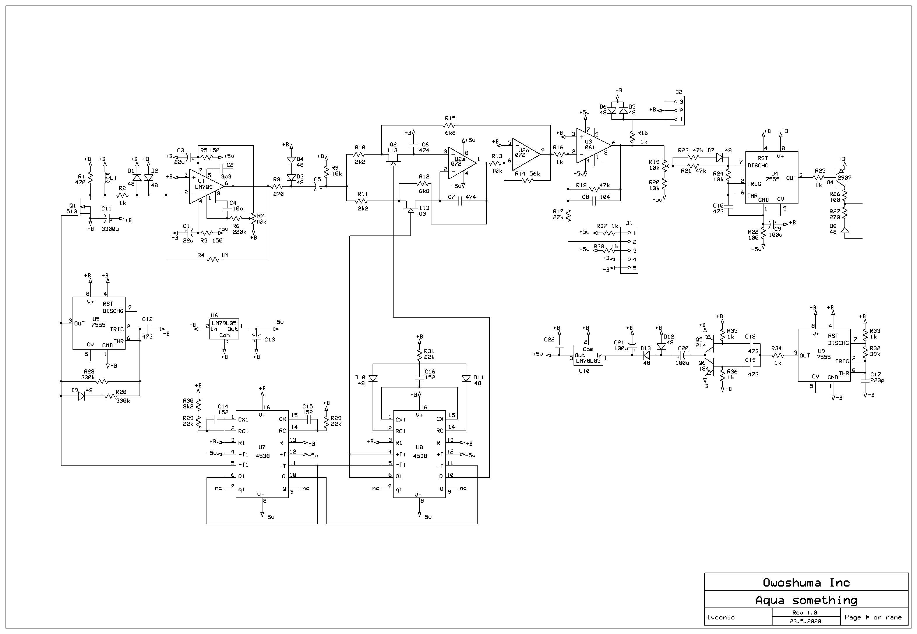

              Corrected:

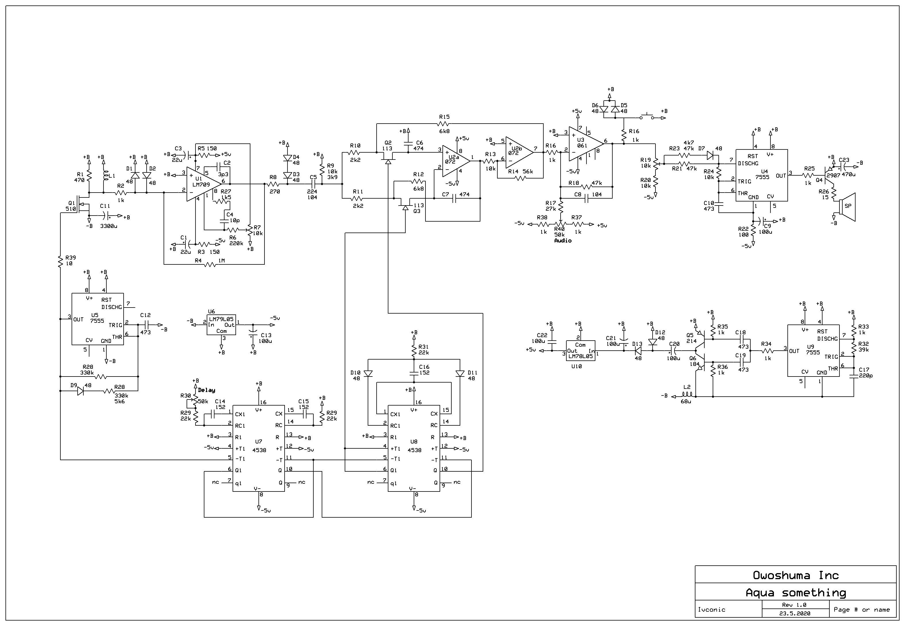

                I tried to complete the schematic, the way i see it should look like.
                I compared Minipulse and XL500 details with this one.
                Probably this will be fine.
