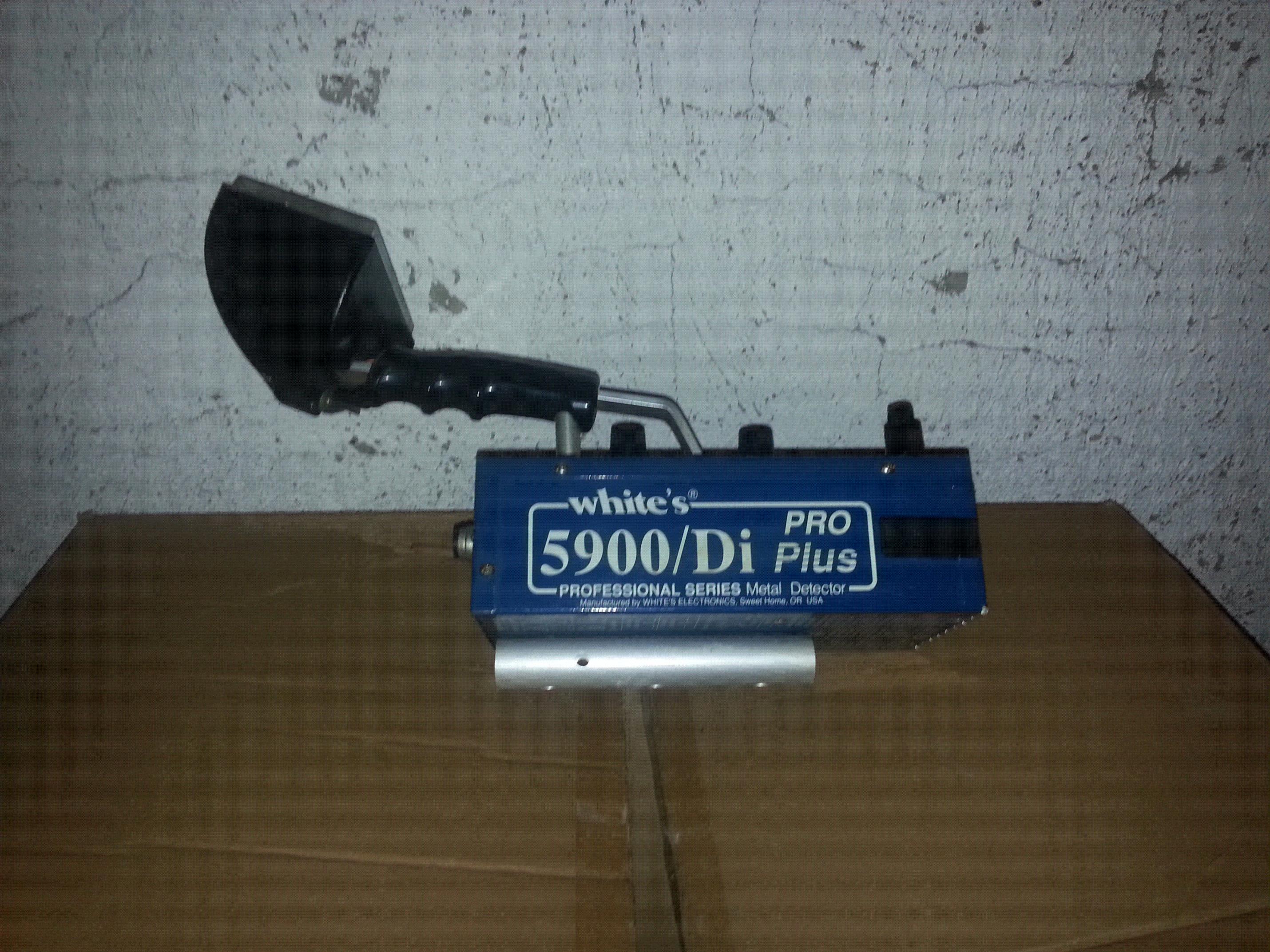

    Hi, I'm trying to repair a White's 5900 pro plus, if someone can 'help me with the electronic schematics.
    We are grateful.
    Is that the DI Pro CB or DI Pro SL?
      Whites 5900.
        The model 'in this photo.Click image for larger version

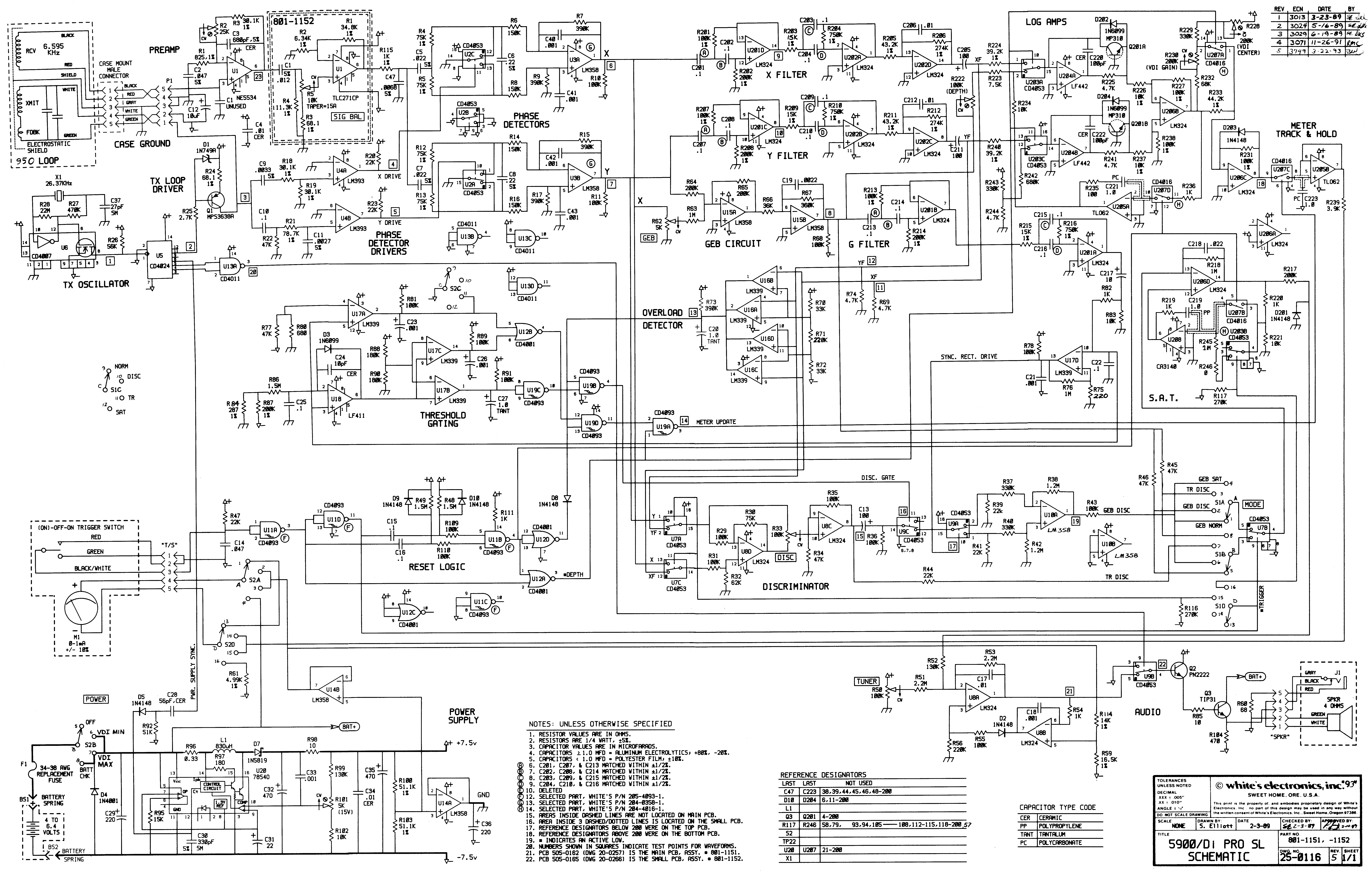

          thinking patent US4783630.pdf has sure the schema. you can take it on this site, a banner atop the page is clickable - go to a section with patents.
            The schematic is pretty much what was posted here. I have a 5900. I am souping it up a bit. I have added in the sensitivity control from the 4900. It makes the GEB mode chatter, but in TR mode it works well, though it tends to keep the meter at nickle range.
