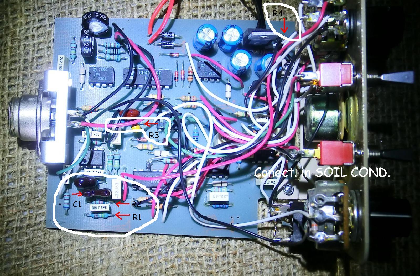

            Hi WM6. I'm working on the diagram and I can't see the values of some components of your photos, Can you help me? They are marked in the attached photo.
            Thanks in advance,
            Fabián

              Hello Fabian
              Here photo of unknown parts:
              Measured value of resistors, without desoldering (!) - I am not willing to desolder parts to measure it:
              R1 = 4.93K
              R2 = 16.14K
              R3 = 14.95k
              R4 = 148.5E
              Original PCB is in a little in cone design not proper square PCB:
              Now, we need ivconic to reverse it:
                Thank you WM6. Wow! I see totally differents colours with the light that you used to take the new photos. I hope my others presumptive values are ok. I think so...
                I think it is all what I need to finish to draw the circuit. Maybe after that, you can confirm some of Mr Lahr values, to make an more accurate project.
                Don't worry about de reversed PCB, a new one is almost done...

                  Hi WM6. Here we go with (I hope so!) the last one question: Can you tell me the order of the connections of the Mineral Conditions switch? I believe that is (top to bottom) Black - White and Red, but I can't see it clearly enough in any of your photos. The diagram is almost done and the new PCB too, but I don't wanna make a dumb mistake like this who can spoil all the work.
                  Thank you again,
                  Fabián
                    Hi Fabian, I will, but I am not at home to check at the moment. On Monday. As per photos it is black on top position.
                      Ok, don't worry. I have no time to work on this until next week. Have a nice week end.
                      Fabián
                        Here "Mineralization Switch":
                          Thank you, WM6. It Was as I presumed. Soon, I will post the complete corrected diagram.

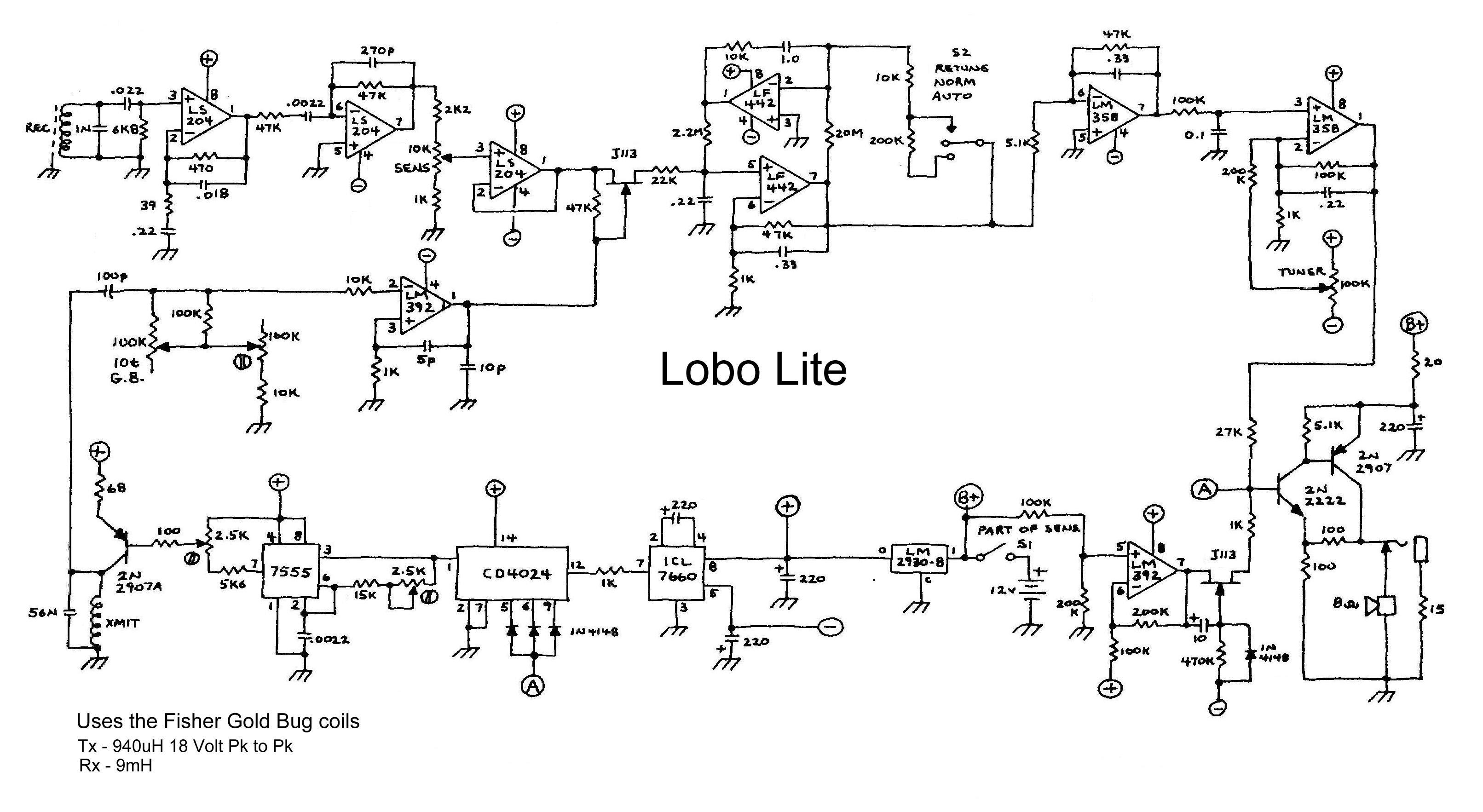

                            DIABLO and DIABLOII Schematics
                            Here is the W.L.'s DIABLO schematic with no errors, and the new one DIABLO II schematic based in WM6's information and photos.
                            Soon I will post the boards.
                            Fabián

                              lobo light = diablo, schematic from kev. you may check your result with his.
                                Good work, Fabian thanks. Thanks for contribution to you KT315 too.
