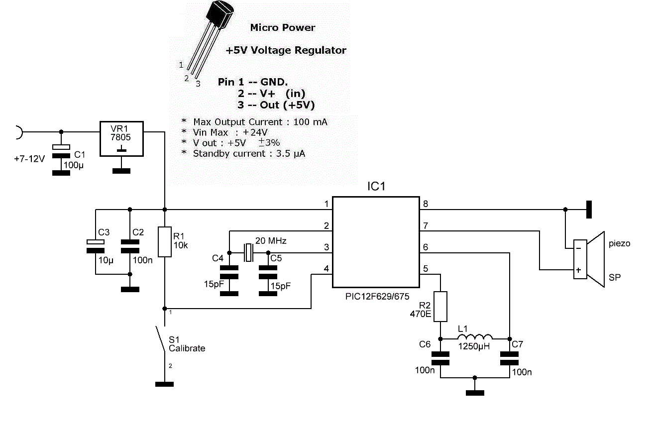

      You programm microcontroller with firmware? Check voltages (like on schematic). As beeping detector? (sound i use for show errors in pcb)
        i using hex file version PinPoint683v5f.hex
        my ragulator im using LM317L is that have problem
          This .hex for PIC12F683 only. In PIC12F675 or PIC12F629 this firmware not work
            omg
            where is hex for PIC12F629
            cos im use PIC12F629
              Any other. All work with 12f629.
                ok i retest back
                  Note: for firs and second version hardware use diferent firmware. Good luck!

                    hahaha im still dont have luck not working
                    i using this schematic
                    firmware v2 v3 v4 v5 huhuh all not working when turn on
                    silent no sound
                    huhuhuh
                      silent no sound
                      huhuhuh
                      [ATTACH]32203[/ATTACH]
                      THE RIGTH schematic in my post #6.
                        THANKS MR. KT315 I WILL FOLLOW YOUR SCHEMATIC NOW!
                          In post#6 second version of hardware with external oscllators.
