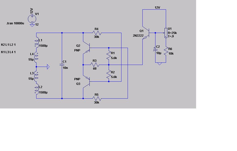

    First , I cannot get the aquasound Hartley oscillator to work at all. I have the correct inductance of the tx coil, but it won't oscillate. I must understand why.
    Secondly, the same coil with the Hartley oscillator scheme from the Fisher 1210/1212x is running from the start, and working very good.

    • Altair, I made a coil 8 inches, with 4inch for feedback. 0.4mm wire 40-10-10-40. I tried with 10nF cap and with other cap values.
      Does not oscillate with aquasound oscillator.
      Same coil is working very good from start with Fisher oscillator both 1212x and 1260x. I tried both and they work very good. Peak to peak voltage is measured 36v~
      • I must figure out why coil doesn't work with aquasound oscillator circuit. I checked and rechecked my circuit. But it won't work.
        However the simulation works. Waiting to see if you have better luck.
        So l don't know what could be wrong. I double checked everything.

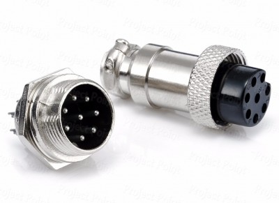

                • The coil plugs.
                  https://projectpoint.in/index.php?ro...d=501711119279

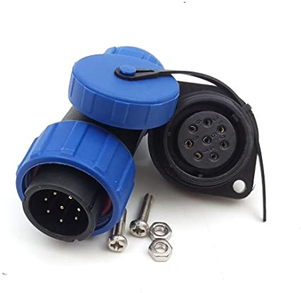

                  • Underwater coil plugs.
                    https://www.amazon.com/Waterproof-Co.../dp/B07BK35YZF

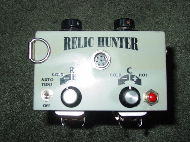

                    • Nautilus coils.... expensive!
                      http://www.relichuntersupply.com/NautilusDetectors.html
                      • dbanner,
                        I have doing a rapid test with my TX coil, .... it oscillate with Aquasound circuit from first start!
                        Respect original schematic there are the following differences:
                        - no Buck coils connected
                        - BC327 instead of 2N2907
                        - two 47K resistors instead of 50K, 51K ones
                        - power supply: 10V at 100 ohm resistor
                        Results:
                        - frequency: 17.748 KHz
                        - output p-p voltage: 26V
                        Coil is connected as indicated in my previous post #54, with exclusion of bucks.

                          Great! So it works.I have several questions.First, what inductance/ number of turns/ coil diameter did you use.Secondly, what is the value of the tuning capacitor you used.I did not put 50k resistor from collector to other end of coil( I suppose this is for simulation of the two 100k potentiometers) when I tested my coil. I wonder if this is why my circuit don't oscillate.

                              51 + 51 turns on 228mm diameter with 0.5mm wire
                              Measured resistance: 3.6 + 3.6 Ohm
                              Measured inductance: about 1500 + 1500 uH
                              Capacitor: 10nF

                                Really, p-p voltage was not measured across the whole coil (at resonant cap terminals), if you do it voltage is about 52V!
