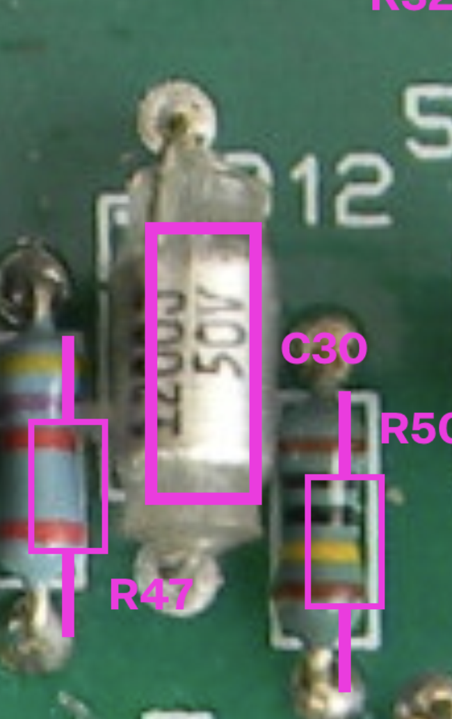

      • was looking over the schematic and the picture of the board, i would imagine some of the components have been updated ?
        This looks like a Polystyrene cap thats polarised , in the schematic has it been substituted with a film cap ?
Name:	Screen Shot 2020-05-16 at 8.10.17 PM.png

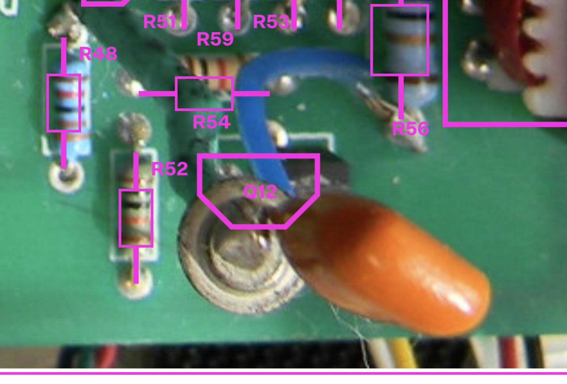

        then noticed the cap the seems to be between resistor 48 and 56 ?
Name:	Screen Shot 2020-05-16 at 8.09.45 PM.jpg
        and then cap 19 seems to be extra compared to what was on the board ?
        • Originally posted by jasonNZ View Post
          [ATTACH]50270[/ATTACH]
          [ATTACH]50271[/ATTACH]
          jasonNZ,
          the cap at your image: Screen Shot 2020-05-16 at 8.10.17 PM.png is not polarized; it's a Polystyrene one but, for the circuit that is, I believe it could be replaced with polyester one.
          The cap at your image: Screen Shot 2020-05-16 at 8.09.45 PM.jpg should only modify the envelope of sound signal; it is not important for me and it not part of original schematic infact it was added later on PCB.
          Important are the 30pf, 100pf and 470pf capacitors that should be silver mica or similar.

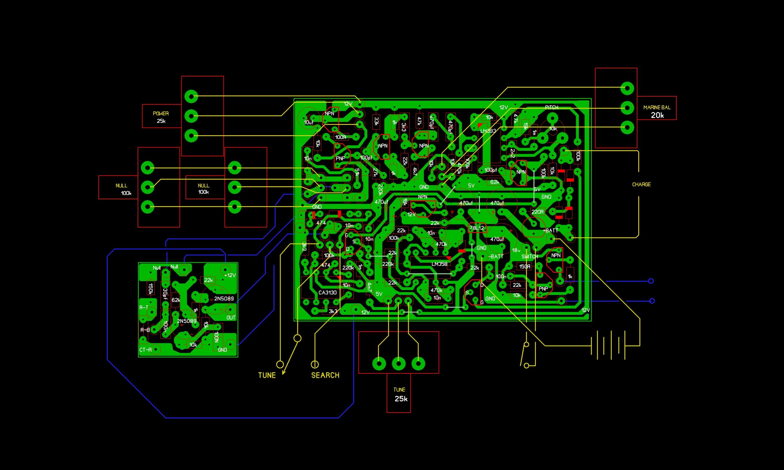

            • hows is this for size very compact 75mm x 57mm haven't checked it yet and not built yet
              • Originally posted by dom44 View Post
                [ATTACH]50307[/ATTACH]
                dom44,
                it's look well, great work!
                I am busy with some minor modification to the original design in order to suite my requirements. Keep in touch!
