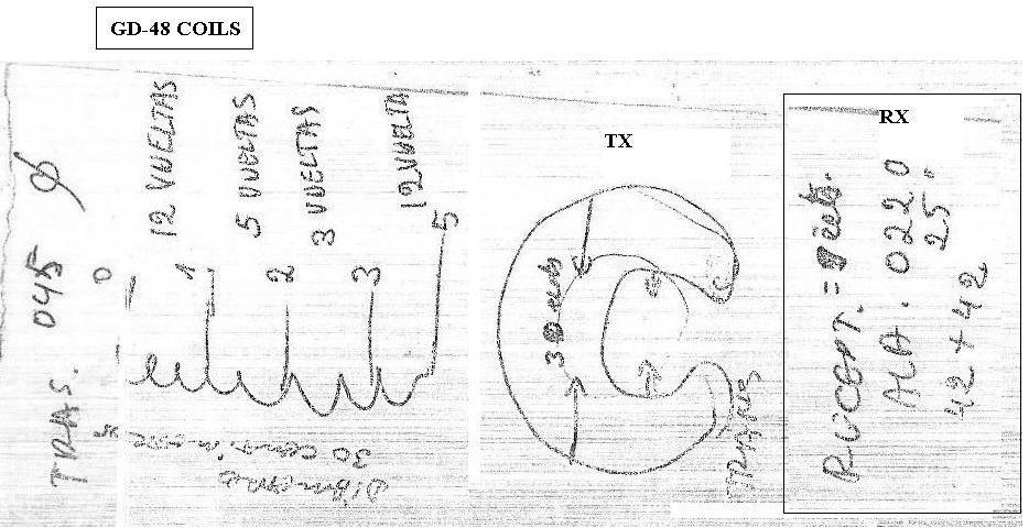

  • If I eliminate the bucking coils and try to balance RX and TX like a normal OO, everithings goes well; no distortion at all.
    • You may also try a RX coil without CT, optional arrangement from the patent.
      See if you still have the distortion.
