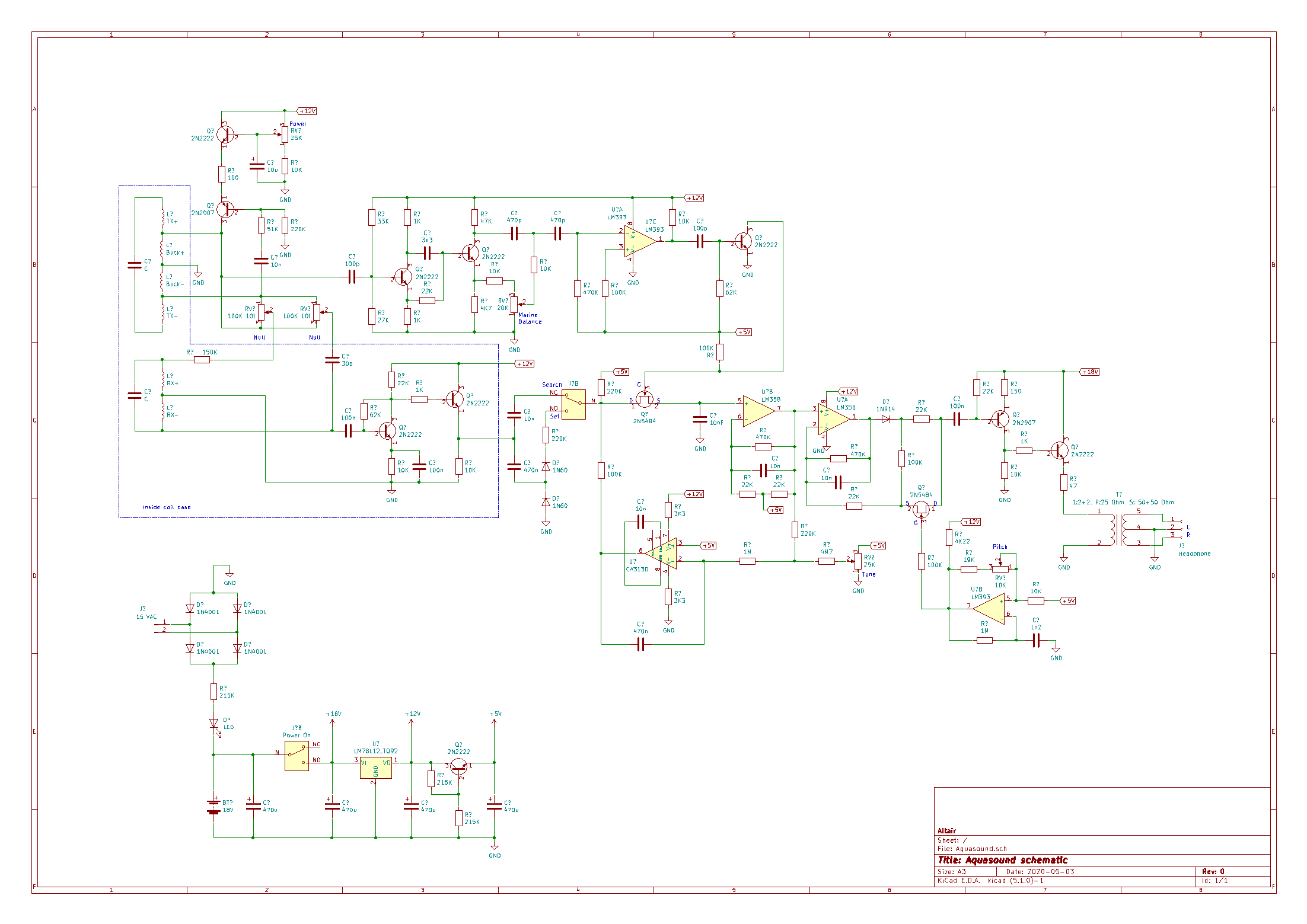

                • #68
                  Here is Aquasound schematic!
Name:	Aquasound schematic rev0.png
                  It's a rev. 0, drawed as the pdf we already know.
                  It could be have some errors, I hope not but is better to check it. Let me know for any mododifications to do.
                  Besides, i have realized from pcb photos that 2007 version is different from the schematic we have; a retrace of a new schematic should be made from photos.
                        [ATTACH]50117[/ATTACH]
                        In retracing the schematic I noticed only few slight differences, nothing really to redraw the schematic. Only place changes in an addendum.
