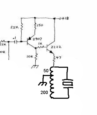

      try use this circuit for piezo

          The Tx oscillator is the power boost circuit, There should be a 25k pot that turns the power up to 52v. Its an amplifier oscillator circuit.

            The power pot and null pots of the Aquasound correspond with the transmit power and R and C on the DMC2B.
            Its very easy using 2 transistors to build a high power oscillator.
            With 12 volts dc in you can get a 44V or 52V peak to peak ac sine wave out of the coil.
            I just built an oscillator for a variant type of bfo detector, with 10 volts dc in I get about 35 to 40 volts peak to peak
            ac out.
            With an oscillator we input dc and get ac wave out. I still think its magic!

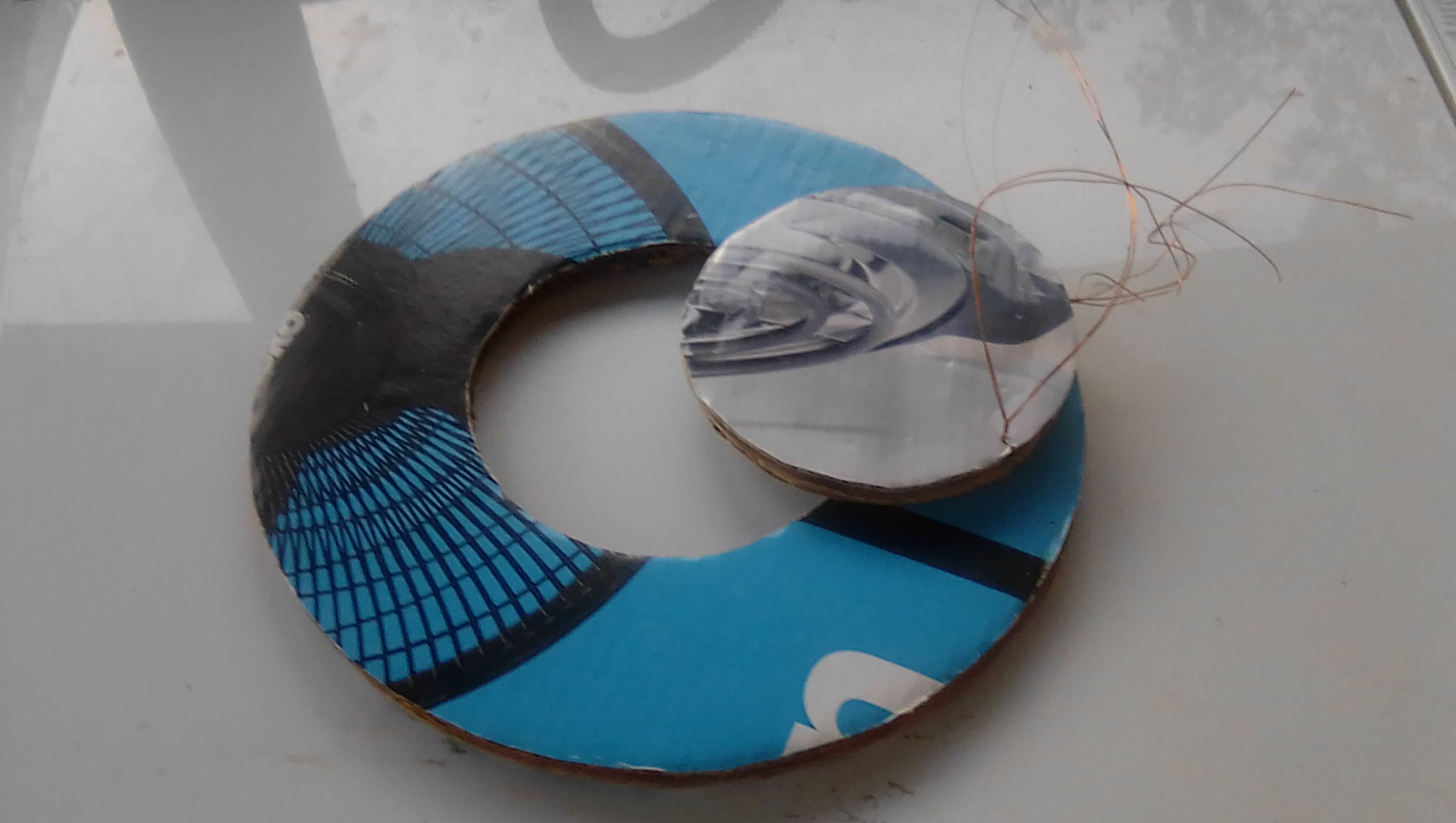

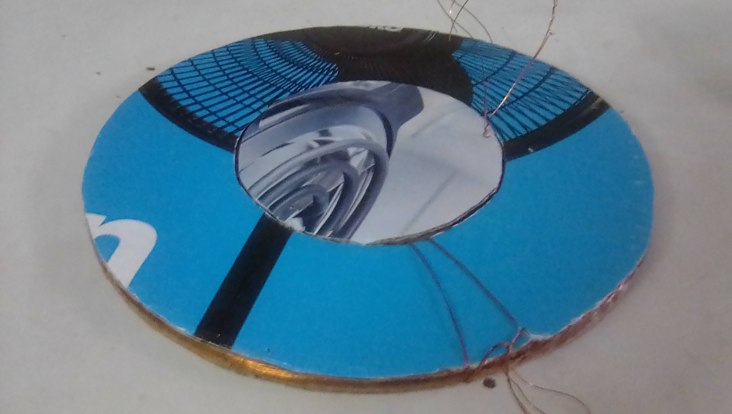

                The coil is proving to be difficult job. Winding with two spools, it is necessary for the windings to be side by side to get the benefit of bifilar big voltage step up. I am going to have to make a jig, hands cannot do such a good job, it takes a lot of effort.

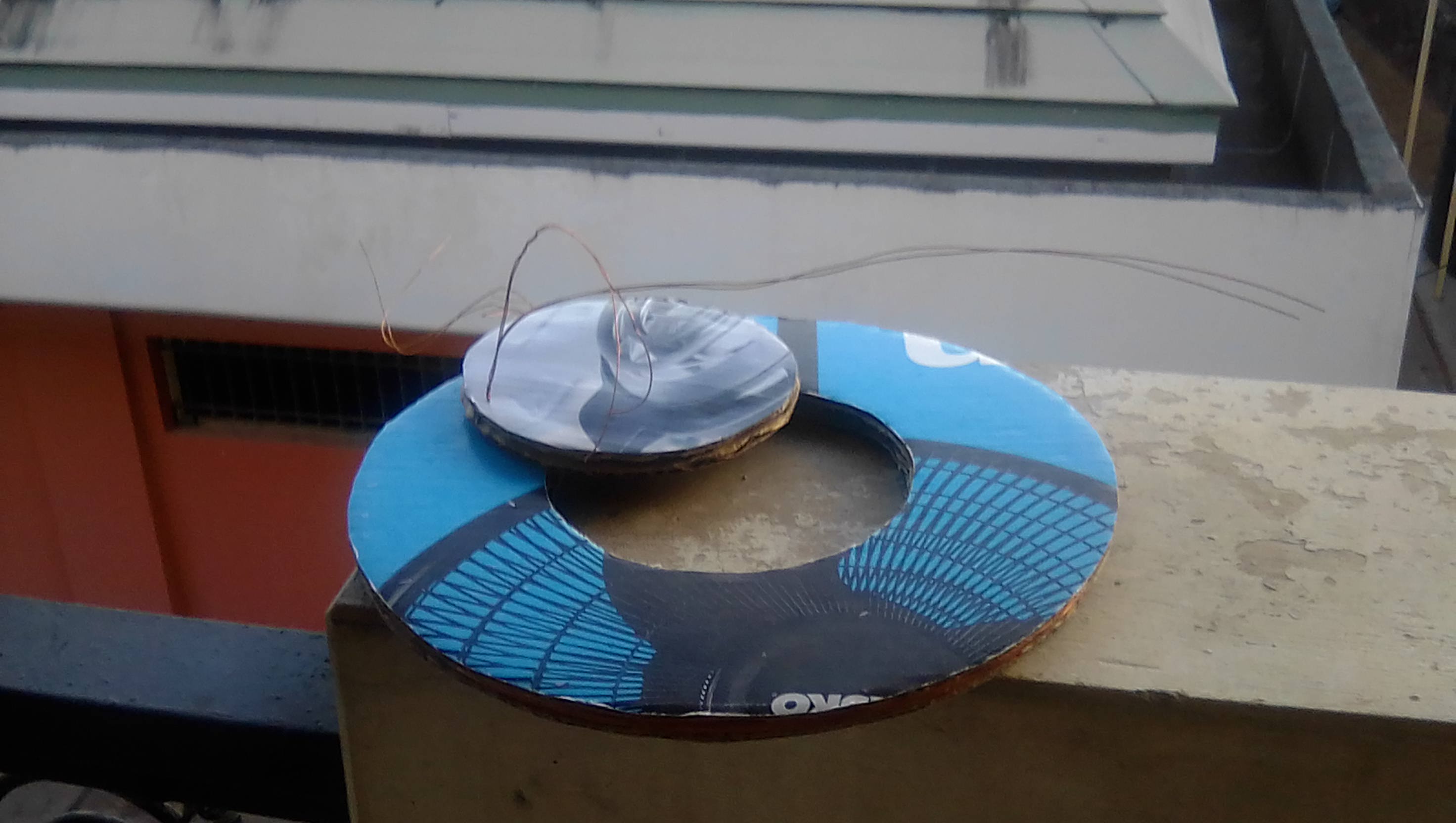

                    • I finished making the coil. Now it's time to breadboard the TX oscillator circuit and do some testing. I'm curious to see what the p-p voltage will be.
                      I did 40-10-10-40 coil /10 inches diameter.. Bifilar windings. I think this will be ok for testing.

                            I will check it out, good work. Today I begin testing coil.First I will try your winding plan, then I will try my winding plan (wires can easily be changed for both)I will measure the peak to peak voltage and scope the waveforms.Whichever one have highest voltage will be the winner.
                            I use common 2N2222 and 2N2907 for the tx circuit. I will put pics of results later today.
