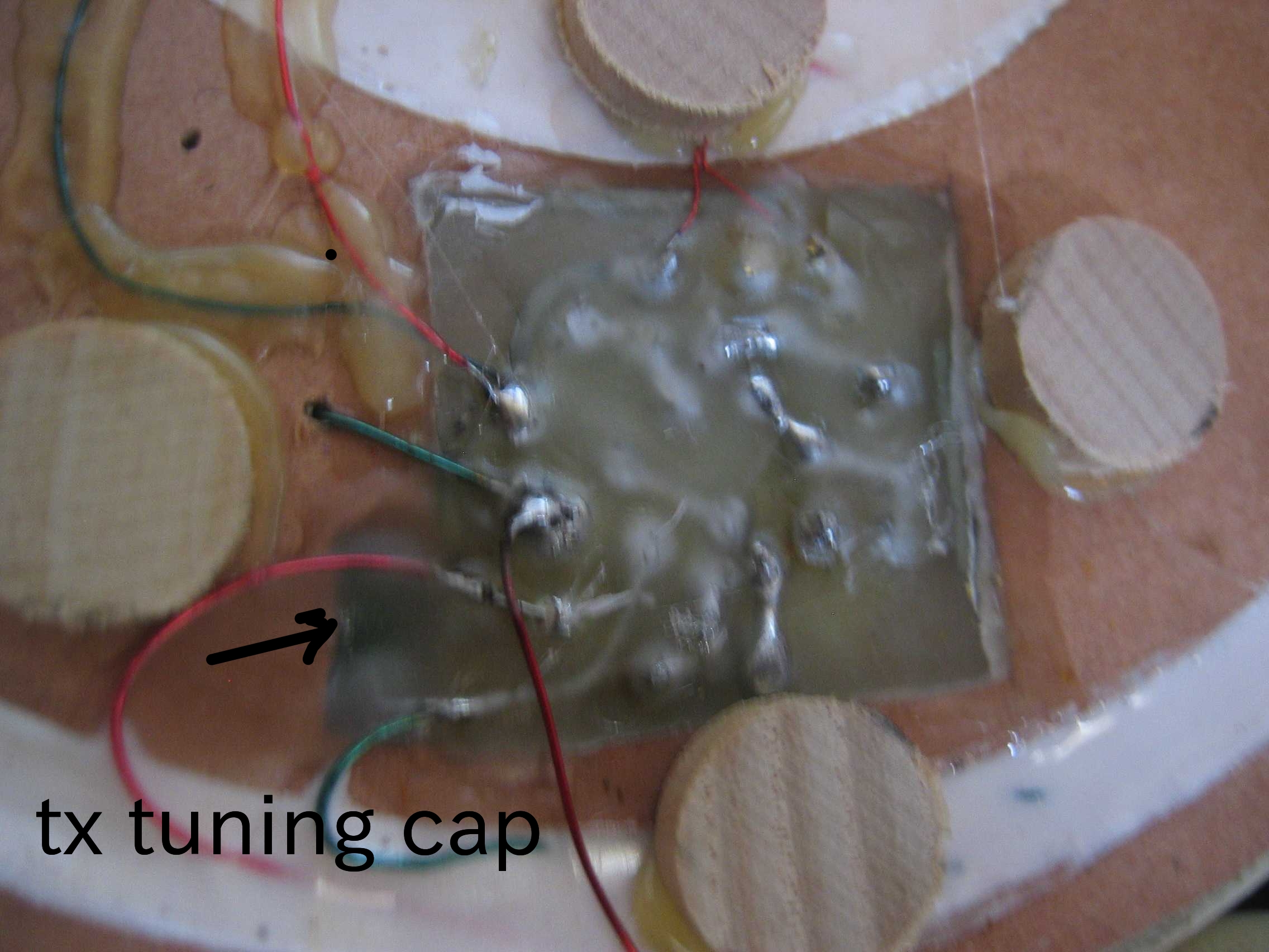

              • Well I have spent the last few hours trying to get the TX circuit working. It will not oscillate.I am going to quit for the day and start fresh tomorrow.
                • No doubt this is Hartley oscillator.
                  I made mistake with value of a capacitor from bill lahr schematic. It is shown as 10nF, but on the PCB it is 1nF.
                  All other values of the oscillator checks good in the oscillator.
                  So I will correct my circuit and test the oscillator again. Maybe this time it will work.

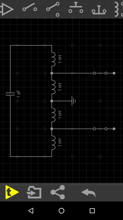

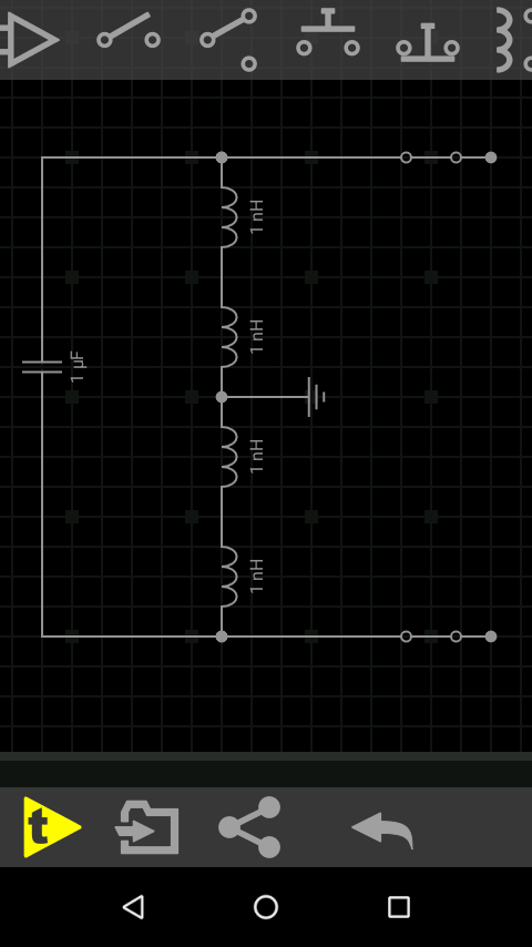

                      I have finally figured out the coil.
                      I am now very confident that the coil for the Nautilus dmc2b and the Aquasound are essentially the same coil, and are connected to the circuit in identical manner.
                      This stands to reason because both detectors share identical Hartley oscillator circuit.
                      So it stands to reason that the TX coil would be made up and connected the same way on both dmc2b and Aquasound.
                      Now here comes the best part. I have concluded, based on the photos of the dmc2b coil, and Hartley oscillator topology, that the Nautilus patent does not show the correct connections for the tx coil. The aquasound schematic also is showing the coil drawn just like the patent, but the coil will not work if connected like that. The photos of the dmc2b coil photos show it connected in the correct manner, and it is not like on the patent or the schematic for the aquasound.
                      The proof is in the photos of the dmc2b coil posted earlier in the thread. The evidence is clear.
                      The tx coil is connected to the Hartley circuit from the outer ends of the coil and not from where it is shown on the patent or aquasound schematic( at the intersection of the TX and feedback coils).
                      I proof this today with my self made coil, I get 50 volts peak to peak! Wow!
                      I will draw a diagram of the right way of making and connecting the coil.
                      I'll put everything here so all can replicate the aquasound coil.

                          • Please disregard the values shown, I merely put these diagrams to illustrate the connections.
                            • I know KT315 is going to come here screaming bloody hell.
                              But my coil is working good. If you guys think you can get it to work the way it's connected on the schematic, then be my guest. I don't mind being wrong, not at all.
                              • Next , I will put screenshot of my coil oscillograph and measured voltage peaks.
