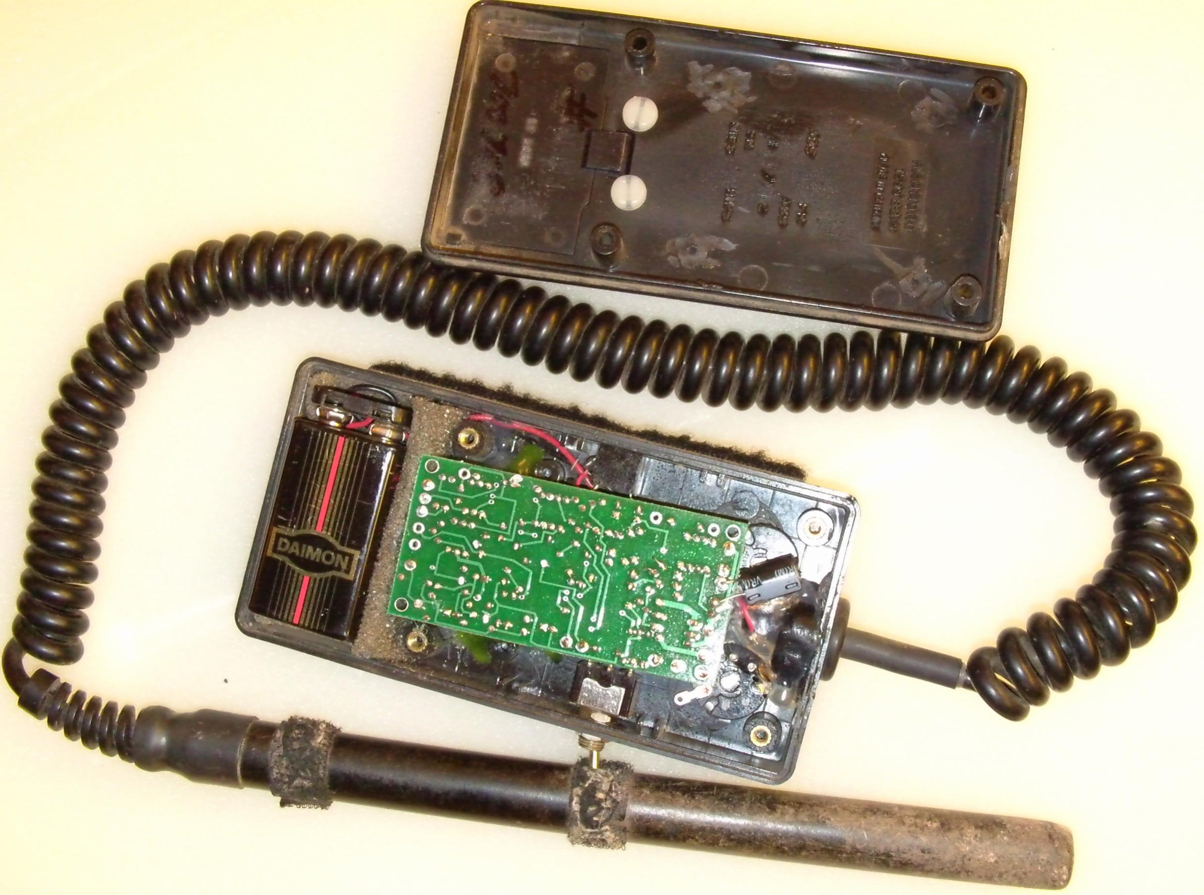

    Got an old used and not fully working Uniprobe Pinpointer, as i hear it is no more on Production.
    Made some test with this broken unit, was also sensitiv to small gold, and good range for big Objects.
    Coil is around 550µH.
    Hope i can make a re-work and would need some help.
    see attached files

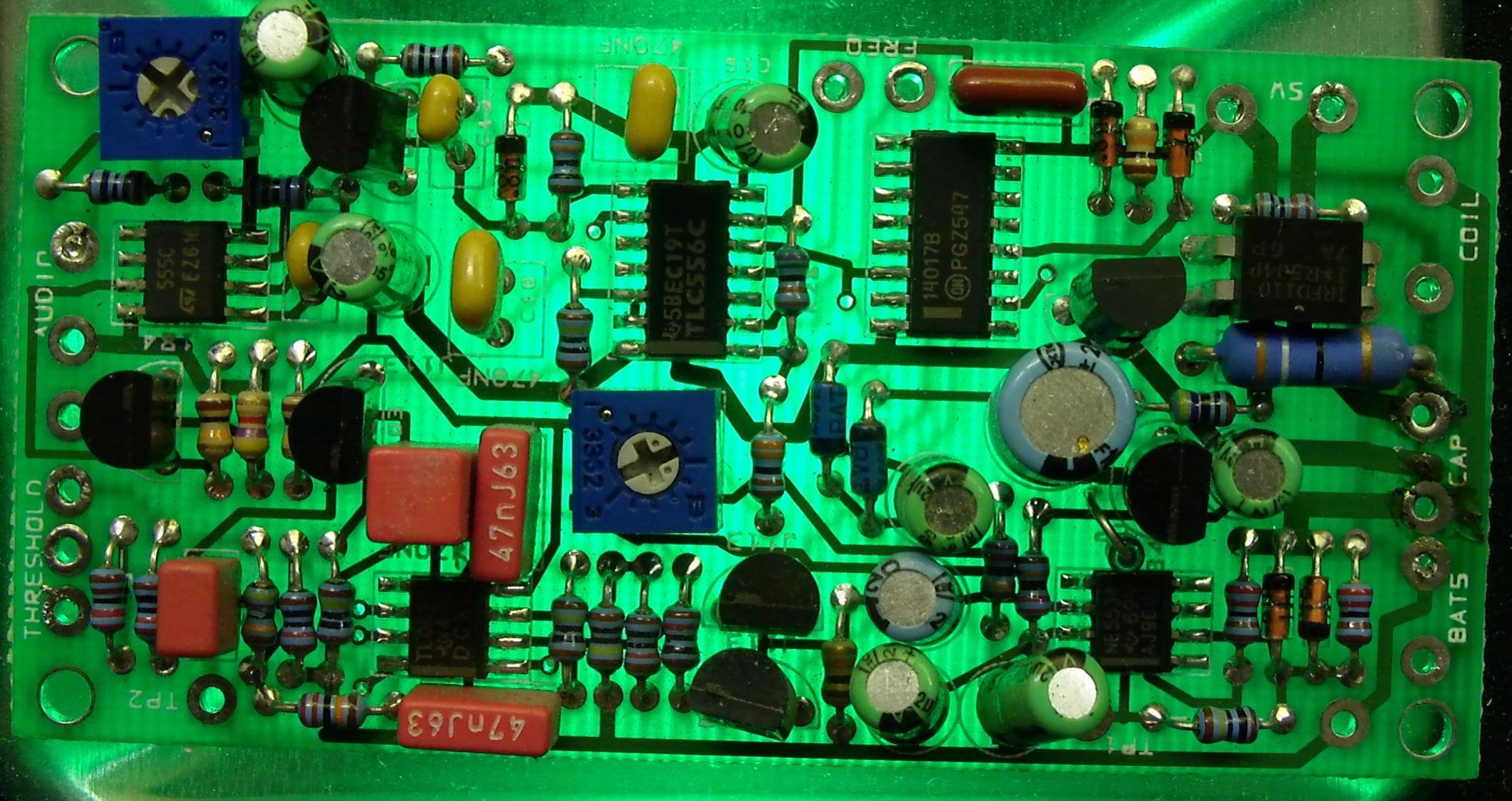

    Looks like a nice one to reverse engineer. Let us know if you come up with a schematic for it!
      Hi Bernard. Looks good to reverse it...
        yes i hope i can make it
        would be the first time i make a scheme from a pcb
        reverse layouting is more my favourite

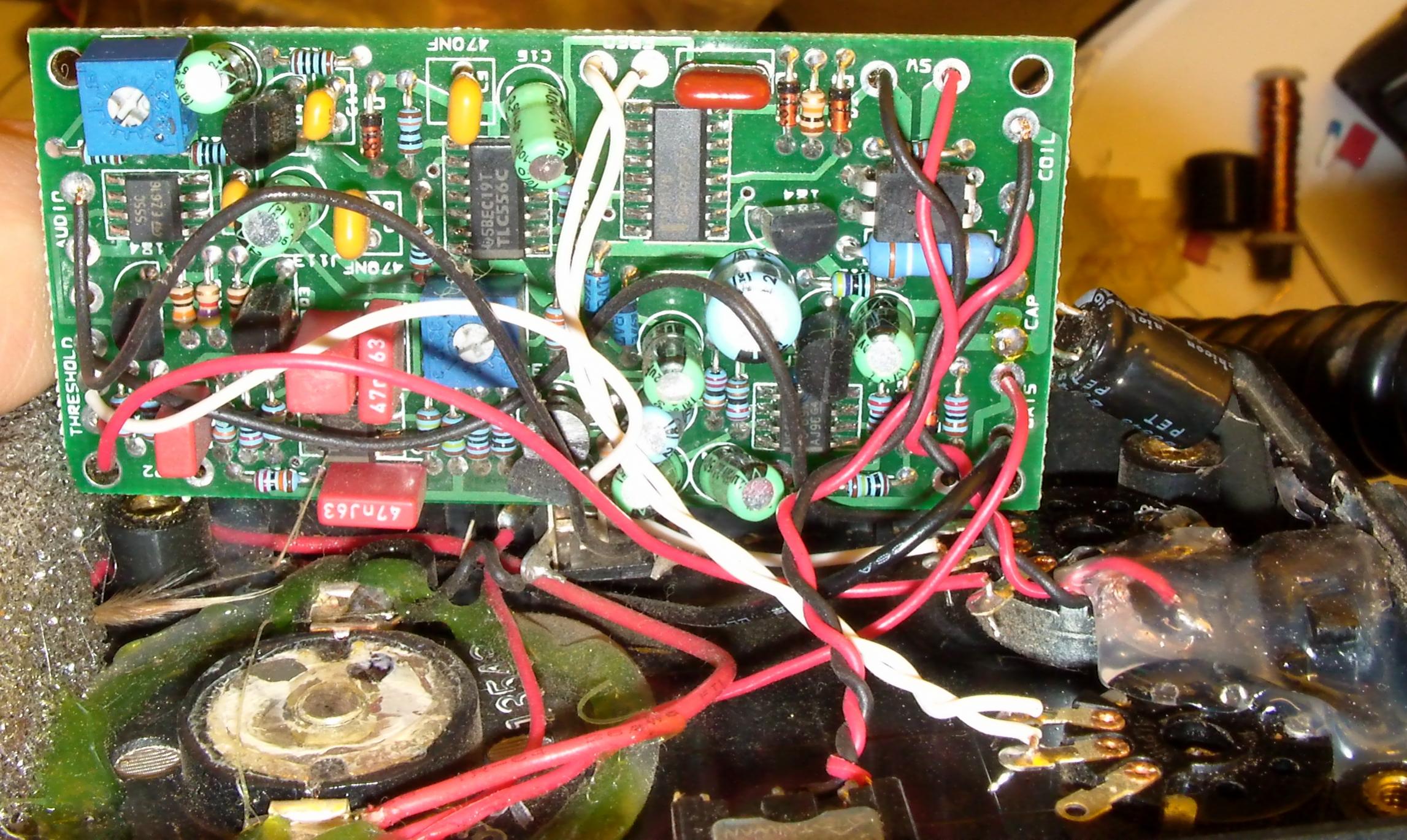

                I think that we need better photos... More aligned and clearer than these, but I think that we can do it. Perhaps some components changed for troughhole for me (hard to find SMD components here) ¿Got the coil specs?
                Fabián
                  thinking Mr.Bill has output on the designer. but you know Bernd... Mr.Bill is out of game... he is only dealer and unactive in our field.
                  your project is nice... I see DIP-4 mos-fet, this reminders me that Pocket is working on short PULSE WIDTH.
                  interesting schematic for realize...

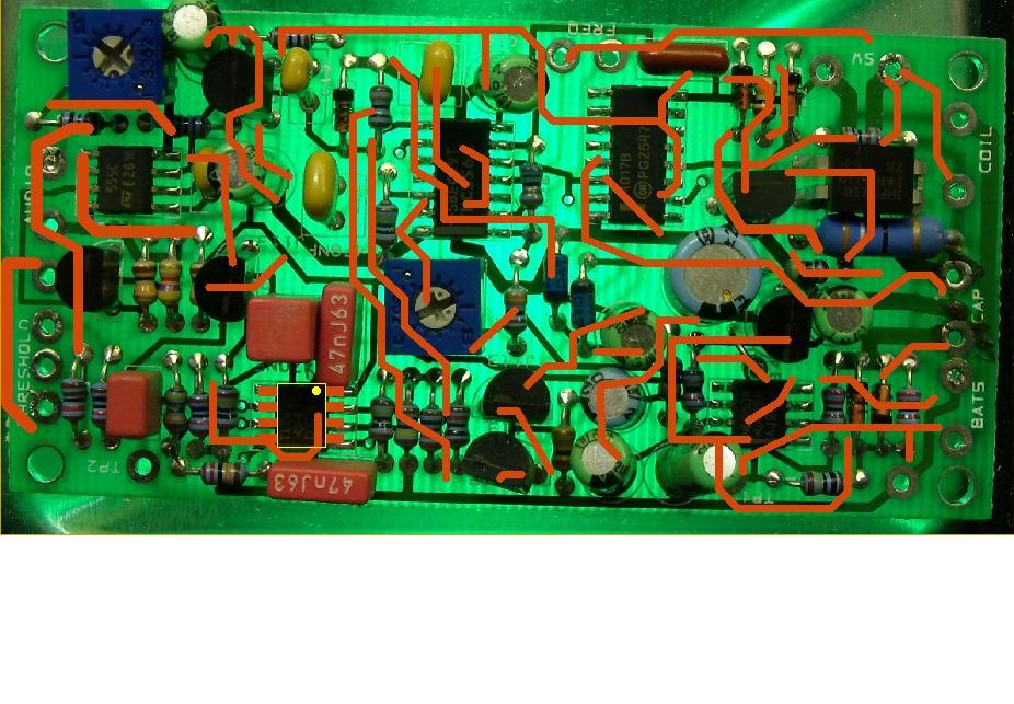

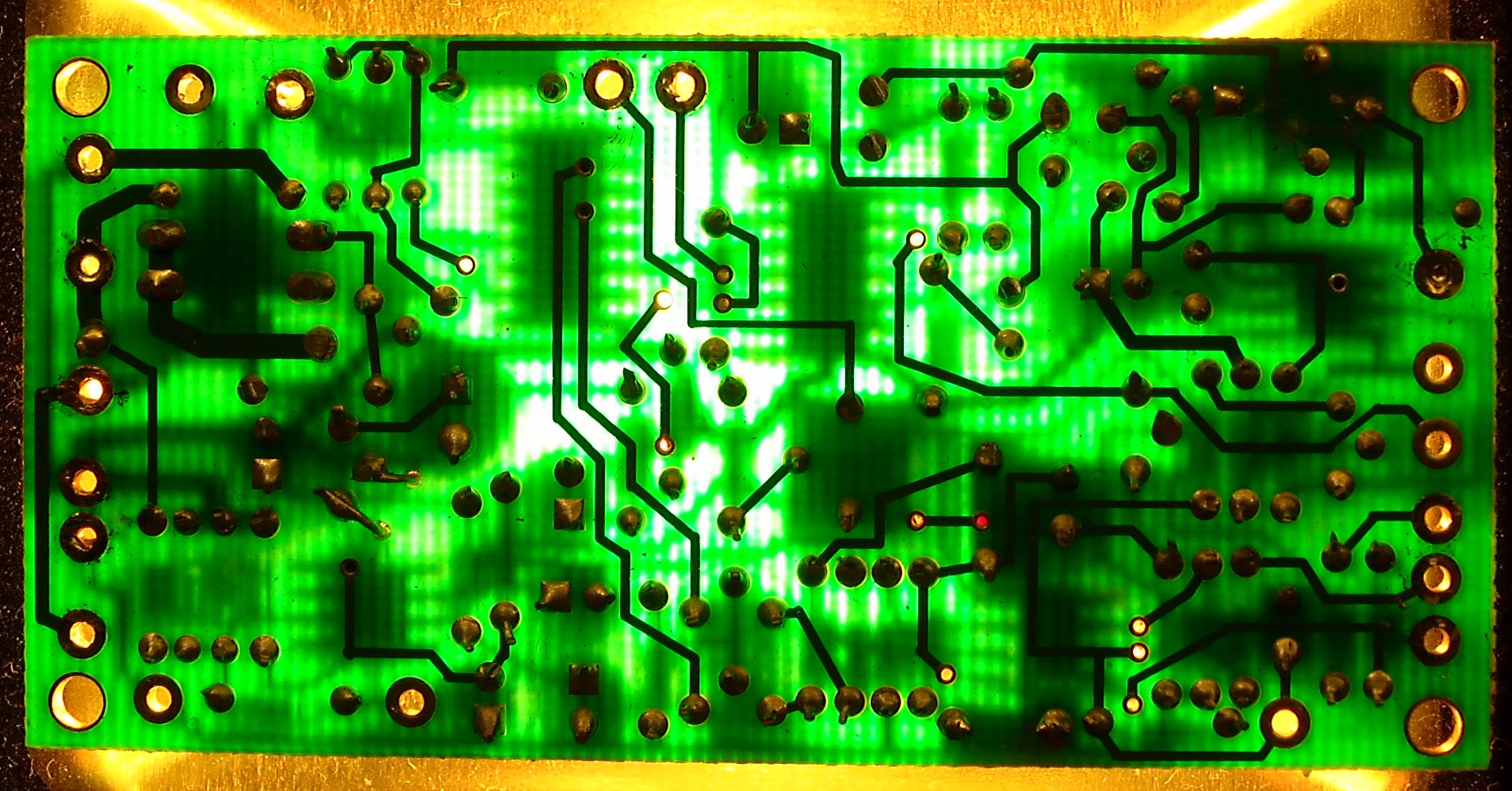

                    Fabian dont make any more work on adapting the layout to sprint layout or somewhere else
                    i have this done to 80% most tracks and holes are already captures bottom and top
                    i need just to fit in all parts with correct values, after that you can spent your work to genarated a good schematic
                    if i spent one hour each evening i could finish my part at the middle next week
                      Ok. I have no experience of reversing schematics from the start, but I'm here to learn and enjoy, so I will try to do it. I'll wait for your PCB.

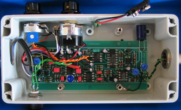

                          low power masterpiece by EF or a copy of his work, have a look at gqss/cs6
                            can you give me a link for gqss/cs6 i dont know what you mean with this
                            did you mean with ef eric foster??? alias ferrictoes here in forum
                              gqss=GoldQuest SS, cs6=C-scope 6 pi, photos of both and a schematic of cs6 somewhere on geotech, should be easy to find
                              Eric Foster, of course, just compare the pcb of your detector with gqss, they are very similar, exactly the same strategy...
