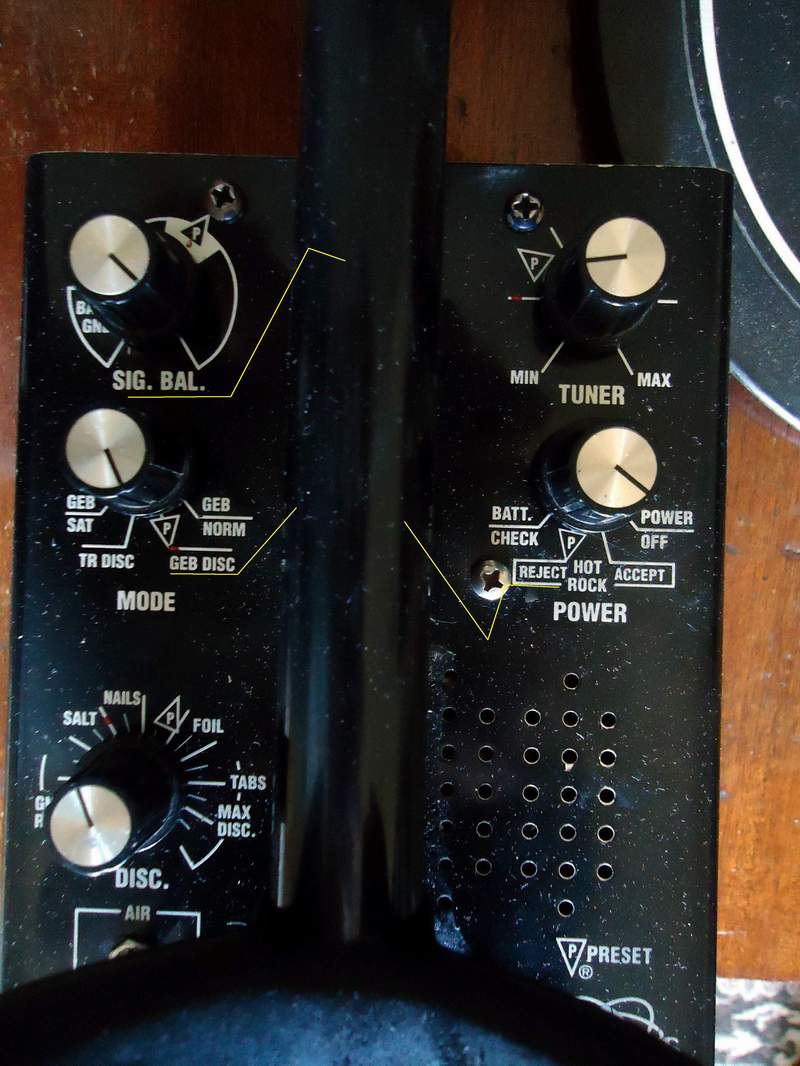

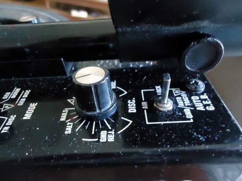

                I am having Deus, it can display GEB readings only up to "90".
                Very often i work on soils where it goes up to "87", "88" sometimes even a "90".
                If GEB is adjusted to measured value; Deus is still working without false signals.
                XL Pro is having very efficient GEB feature, you can adjust it to fixed value or to tracking ("AUTO") mode.
                You can further improve it's stability with setting up the switches to "Hot Rock Reject" and mode to "GEB Disc".
                And at the end you can readjust "SIG.BAL" (Signal Balance, (front end offset actually)) in conjunction with TUNER (Audio Treshold) to given soil conditions.
                With a bit of effort you can really pull out the maximum performances from XL Pro. Read the manual. You'll learn a lot.
