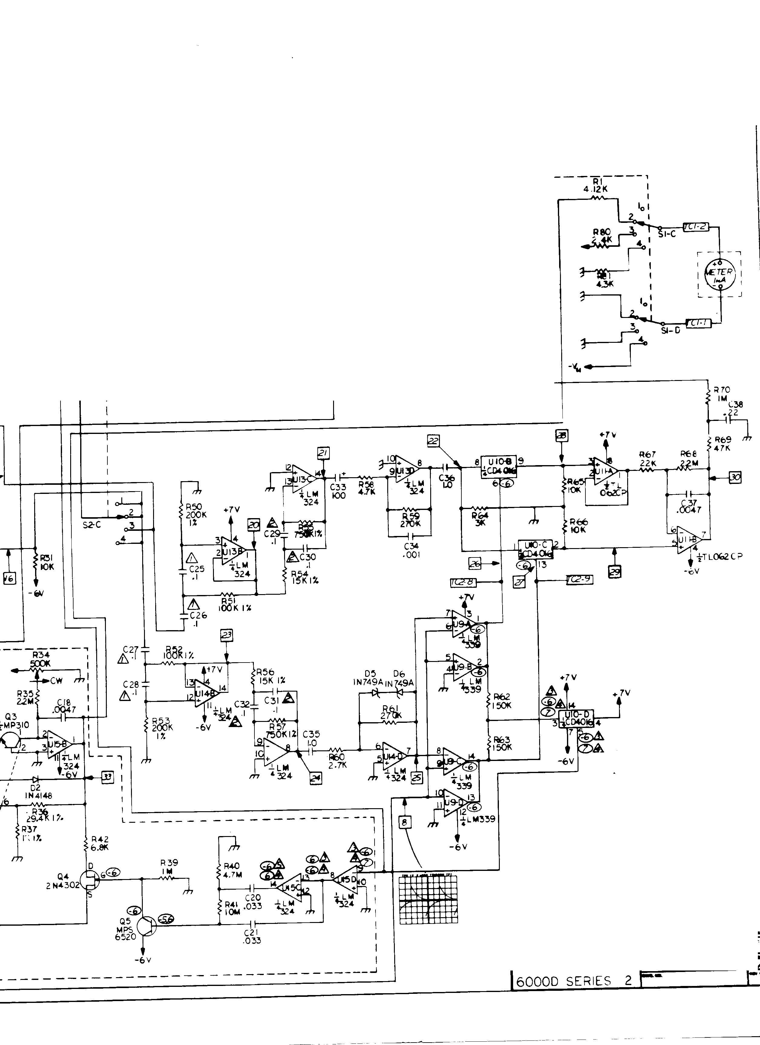

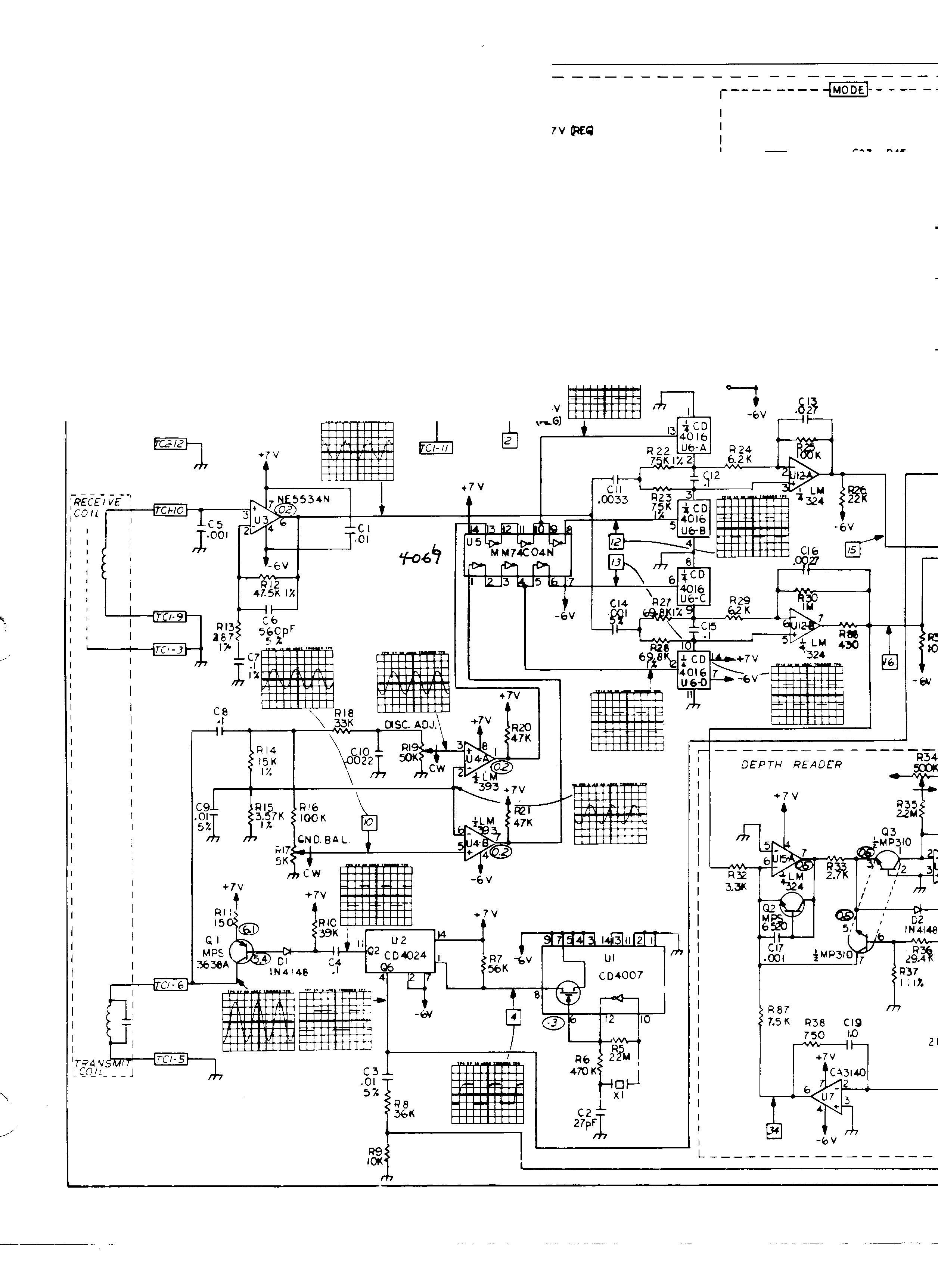

A lot missing. Can you post the rest. The thing with this schematic that I have not seen before is the wave forms.
I actually have this schematic, without the waveforms.
