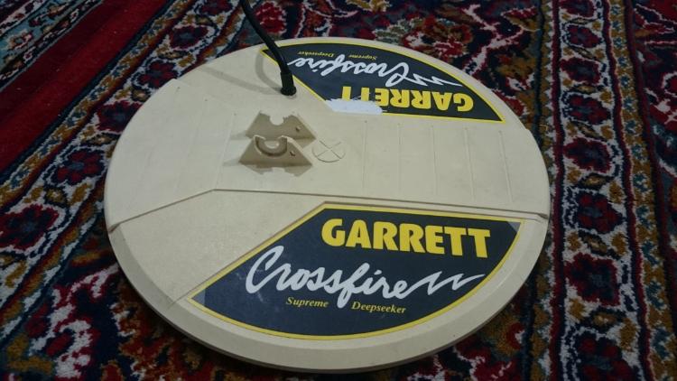

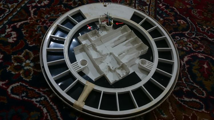

    hi.
    i have Garrett grand master hunter cxii metaldetector and my coil was broken.
    i wana fix it.
    can anyone put a picture from inside of this coil for me in this post,please?
    the yellow wore and that spring thing are opend and coil not working
    this is my broken coil pics:
    http://s3.picofile.com/file/8216238734/cx1.JPG
    http://s6.picofile.com/file/8216238792/cx2.JPG

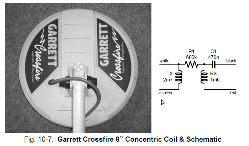

    Assuming the Crossfire coil for the Grand Master Hunter CXII is similar to the Crossfire coil for the GTAx series, then its internal wiring should look like the attached. This is a picture of Fig. 10-7 (Page 127) "Inside the METAL DETECTOR - Edition 2".
      thanks man
      your are a life saver
        The spring with the wire attached is simply the way Garrett attaches the ground or cable drain wire to the coil shielding. The spring maintains contact to the conductive plastic at the top and bottom of the coil.
