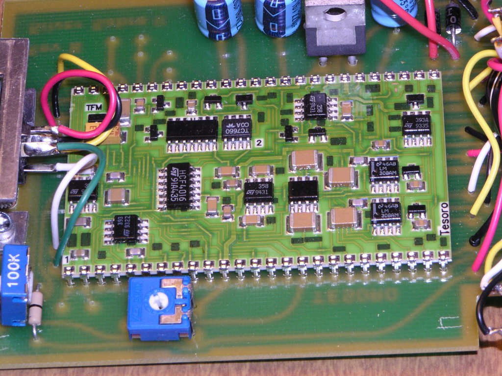

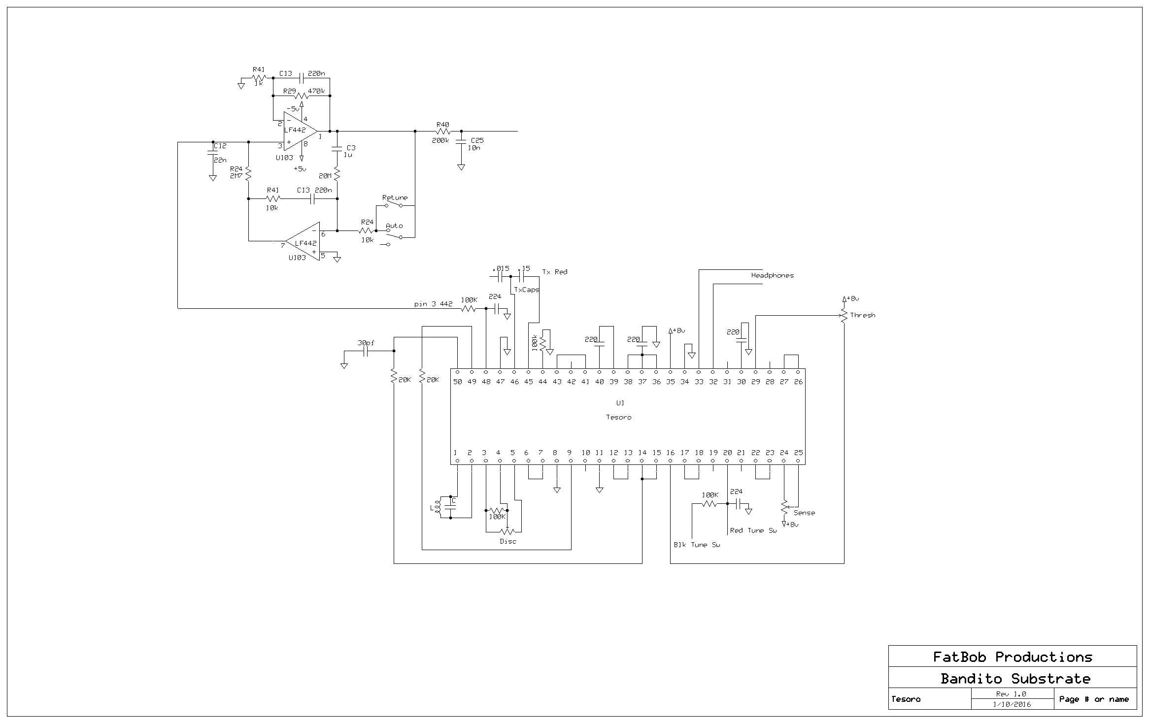

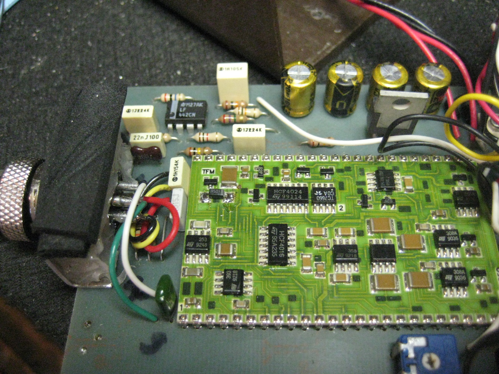

    I just bought a broken Cutlass uMax off Ebay and was looking for some info on it.
    It has the 50 pin substrate on a PCB like many other Tesoro's. I wonder if anyone
    has a schematic to the substrate?
    I started drawing a schematic but this site won't let me attach anything yet...
    Some of the pots were replaced and there are a few wires hanging. I found one
    picture from someone in the same situation but no pics of a good working one.
    Anyone have any info?
    can you do hi res pics of your board? i believe you mean a ceramic chip submodule. Carl M. did draw
    a schematic for 'bandido umax'. i will send all files after your files.

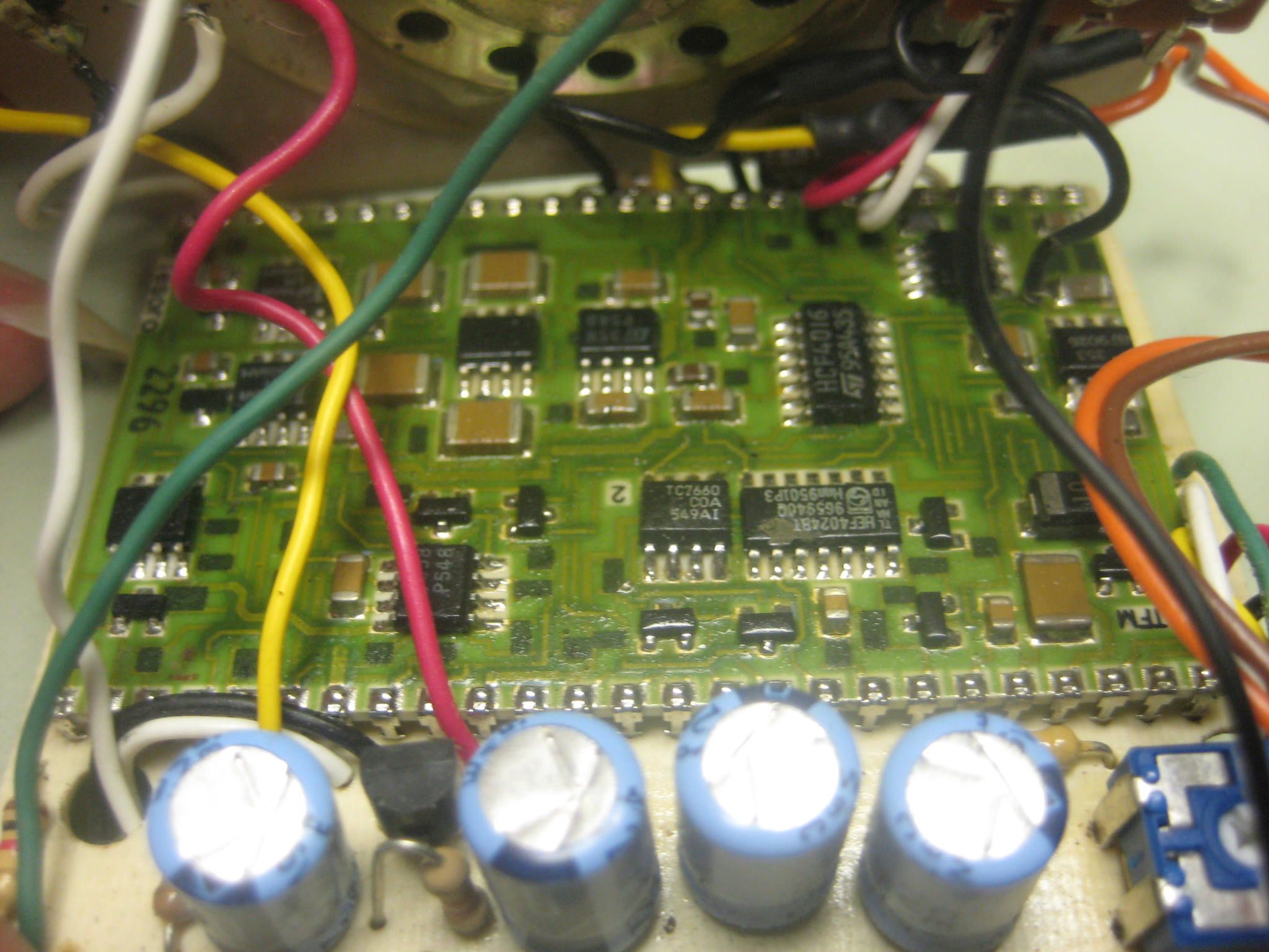

        Here is what I have. First some pictures of the substrate/pcb in several different units;

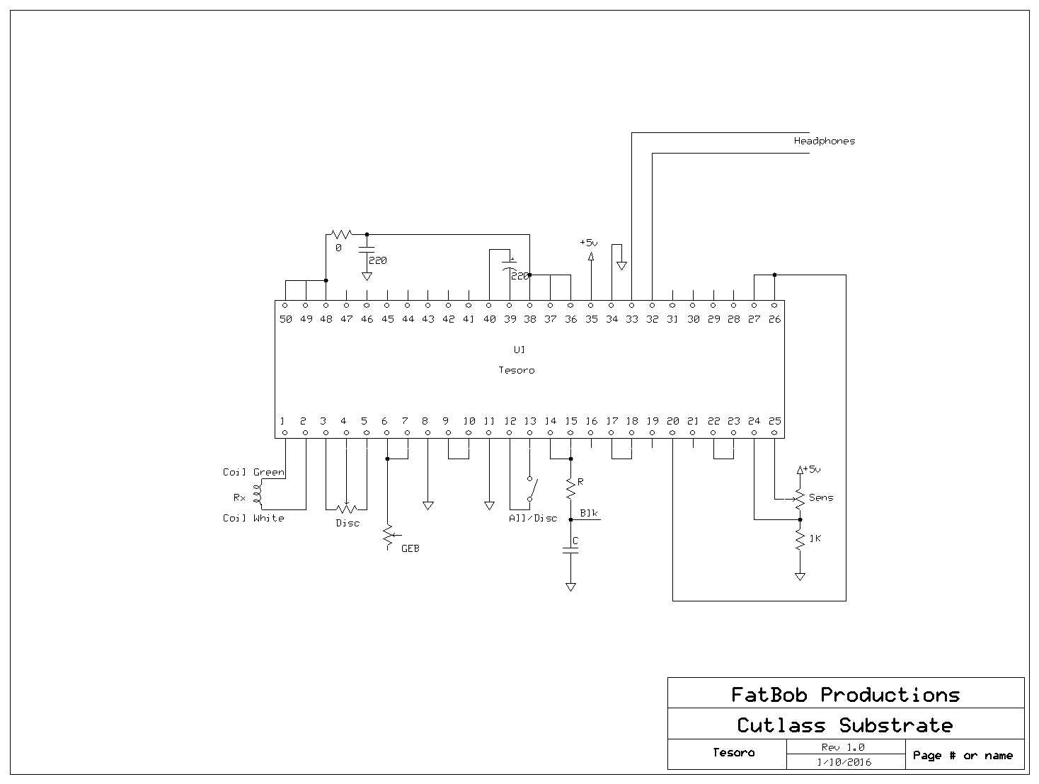

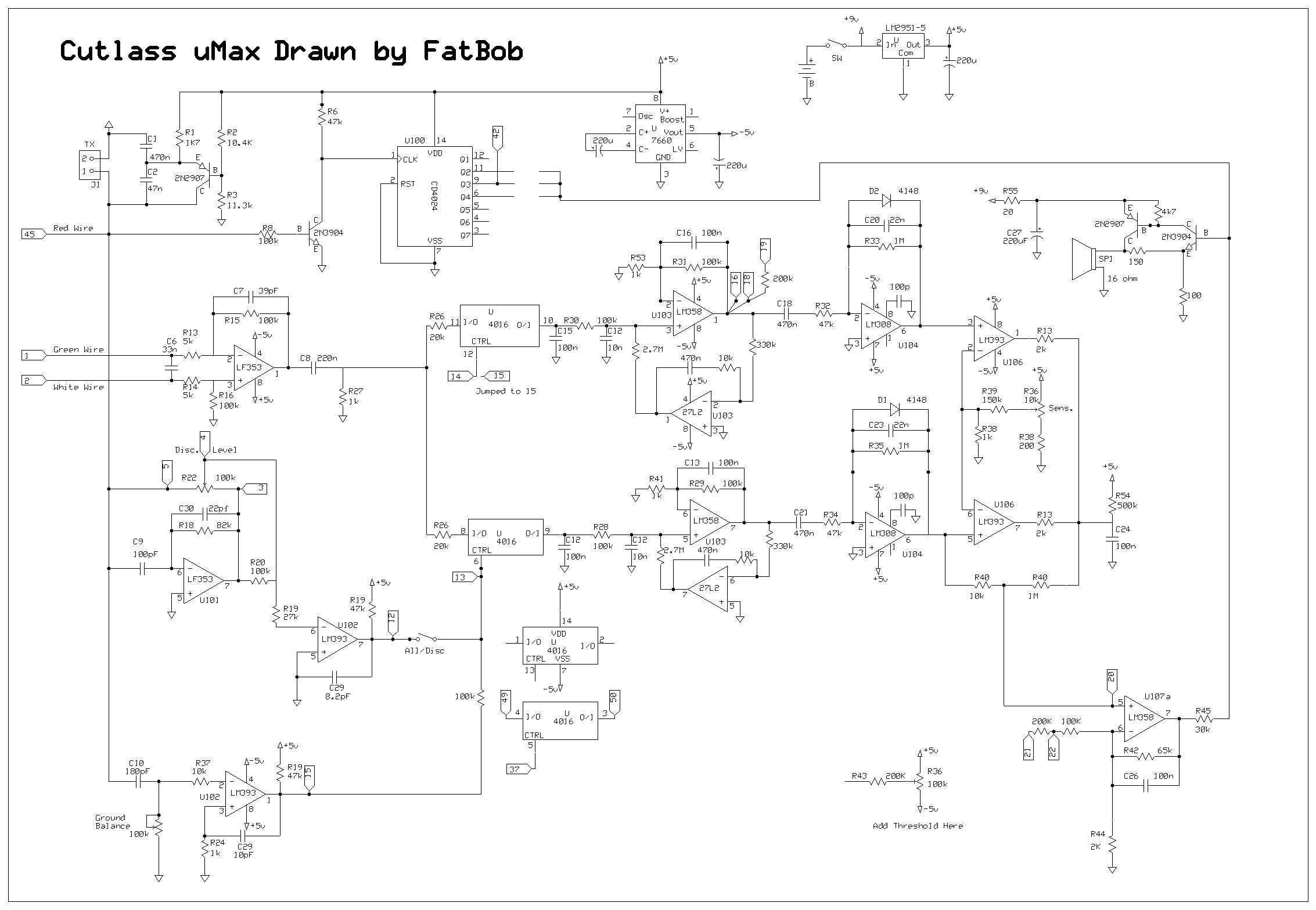

          And here is the Schematic of the substrate and circuit as far as I have measured it;
Name:	Tesoro Cutlass Substrate.jpg
          The little flags with the numbers are the pin number on the edge of the substrate...
          I wondered how the all metal worked using only 2 pins for the switch....
            a part for disc is switched in all met mode. simple and effective way. BTW good decision for compadre boys if they looking for how to do pinpointing mod.

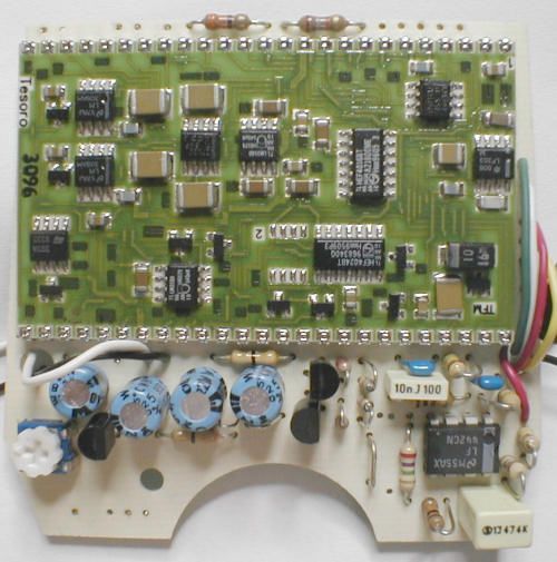

              A couple more pictures I just found;

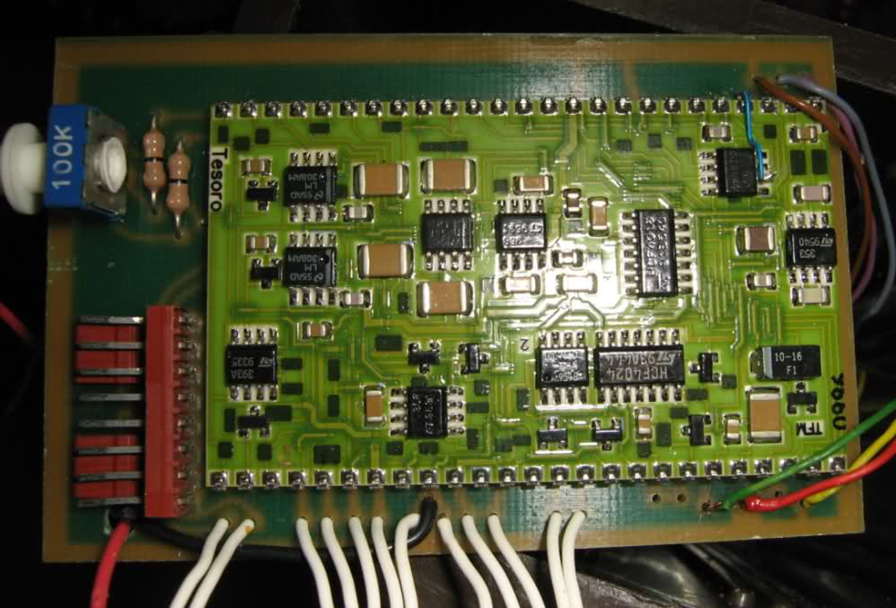

                Here's some of the Bandito substrate;
Name:	Bandito Substrate.jpg
