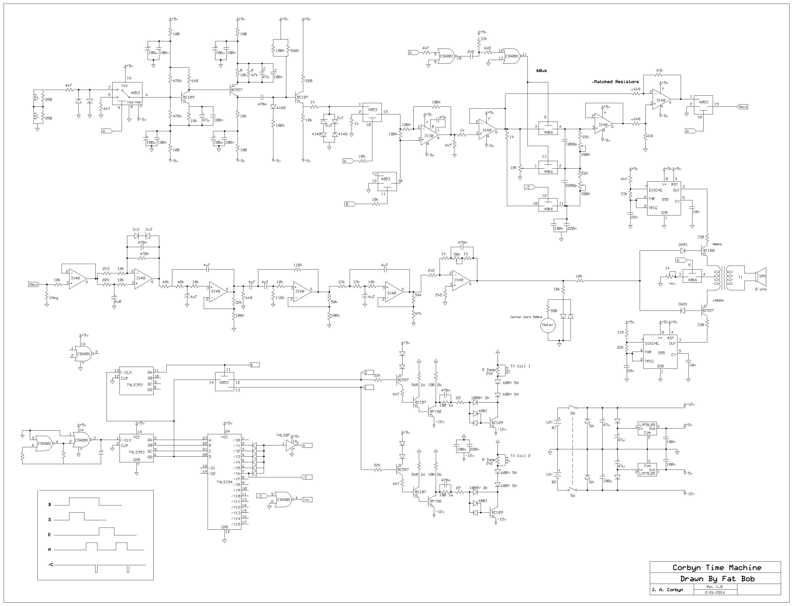

    I was doing some research and realized the Corbyn article didn't really have a full blown schematic with it.
    So I drew one up. It has some cool features like bipolar TX, discrete preamp, top hat coil and other stuff.
    Check out the 2 tones, one is for positive signals and one for negative. I might use that on my next project!
    There are most likely mistakes (in the original and made by me) so do not build it if you don't want to mess
    around a lot to get it going. I had to add lib a lot of the timing stuff (I hope I got it right!).
    It's just for study and maybe to get some ideas!
    Here it is;

    This could be an interesting project.
    According to the article, this detector was experimental, and originally developed for detecting gold in Western Australia (but so far unsuccessfully). Either he wasn't searching in the right place, or there's a basic problem we don't know about. As far as I know, there has never been any follow-up articles on this design.
    Whatever ... it could still be a good learning exercise.

        In an article published in "Wireless World", May and June 1980, J. A. Corbyn describes a PI detector and an electronic circuit for that detector in which, in addition to discriminating against the ground eddy currents by not enabling the receiving means for some period immediately after the cessation of transmission, an attempt is made to discriminate against the remanent magnetization of the ferrite within the target volume induced by the transmitted magnetic pulse. Within the said article, as well as within some of its cited literature, the remanent magnetization of ferrite in the ground is credited to the effect called "magnetic viscosity".
        In the circuit described by Corbyn, a transmitter coil transmits a magnetic field discontinuously, with alternating equal periods of transmission and non-transmission. Throughout the periods of transmission, the input of the receiver amplifier is grounded; amplification of received signals occurs between periods of transmission. There is also a delay after each transmission period in order to allow the eddy currents in the ground and the transmitting coil current to diminish to a level where they do not produce significant signal in the receiving means of the detector. The period during which the receiving amplifier is not grounded shall be called the analysing period.
        Corbyn's circuit attempts to eliminate the effects of magnetic viscosity in the environment by electronically simulating that part of the signal which is due to the decay of the remanent magnetic field of the ferrite in the environment. Corbyn states that the magnetization, as a function of time, of ferrites in the environment is proportional to the magnetic susceptibility of the material, the change in the applied magnetic field H and a function g(t) which is a general function describing the form of the temporal evolution of the decaying magnetization. Corbyn further states that the function g(t) is independent of the magnetizing signal. The signal induced in the receiving coil of a detector will be proportional to the time derivative of g(t), which Corbyn claims is
        g'(t)=(1-P)exp(-t/T1)+Pexp(-t/T2) (1) where P, T1 and T2 are constants which were determined empirically. This expression is largely based on measurements which were obtained using methods which are not disclosed in Corbyn's article.
        The apparatus uses an electronic circuit to produce a signal with the characteristics of equation (1) and subtracts that signal, of a magnitude related to the magnitude of the received signal, from the received signal. The proposal of Corbyn is that any departure in the received signal from the form of the "magnetic viscosity" signal will produce a non-zero output from the subtracting amplifier, perhaps indicating the existence of eddy currents in the target volume. Corbyn states that the form of the temporal evolution of the magnetization of the ferrimagnetic material is independent of the magnetizing field applied. However, it can be shown that the temporal evolution of the magnetizing of the ferrimagnetic material does depend upon the applied magnetic field, knowledge of which is essential when trying to predict the form of the demagnetization of the remanent magnetism.

          Seems Corbyn applied for a patent and gives a bit more info.
          http://www.delve.vub.ac.be/publicati.../GB2071327.pdf
            Wow. They featured some serious projects in Wireless World back in 1980! Though I see it's successor Electronics World is "aimed at professional design engineers". Practical Electronics was more my level
            http://www.geotech1.com/cgi-bin/page...rbyn/index.dat
            The schema looks so much better as one sheet.

              Thanks KT315 - I've never seen that patent before.
              Carl - this one needs adding to the Patents page on Geotech.
