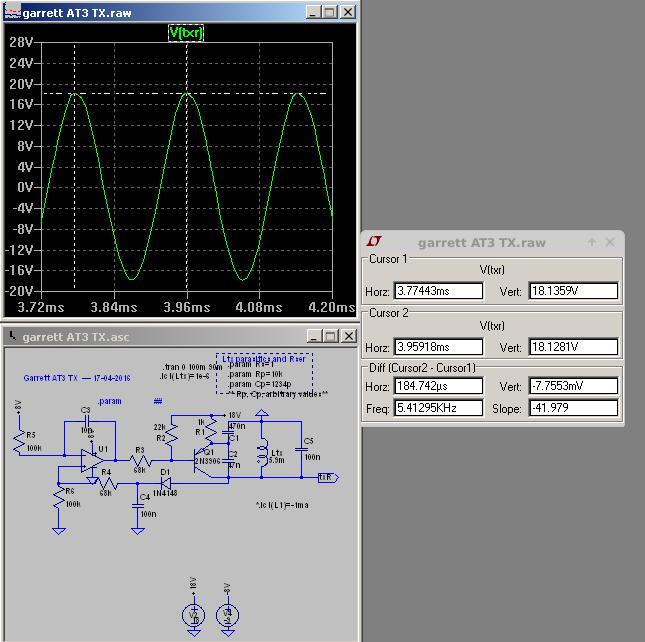

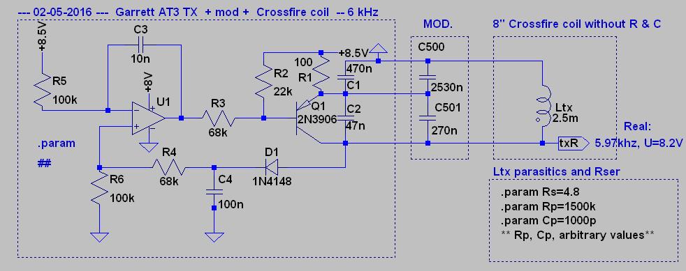

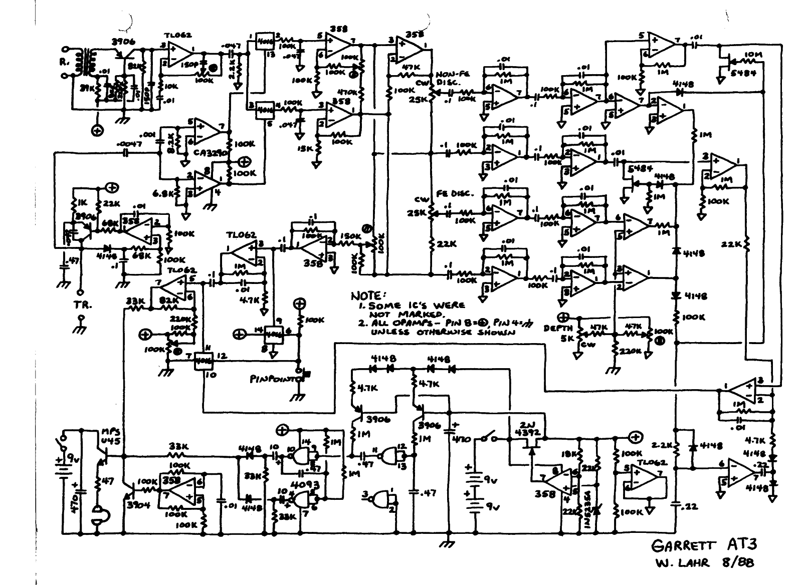

I started yesterday to fix AT3. Coil is missing and data for it is needed.

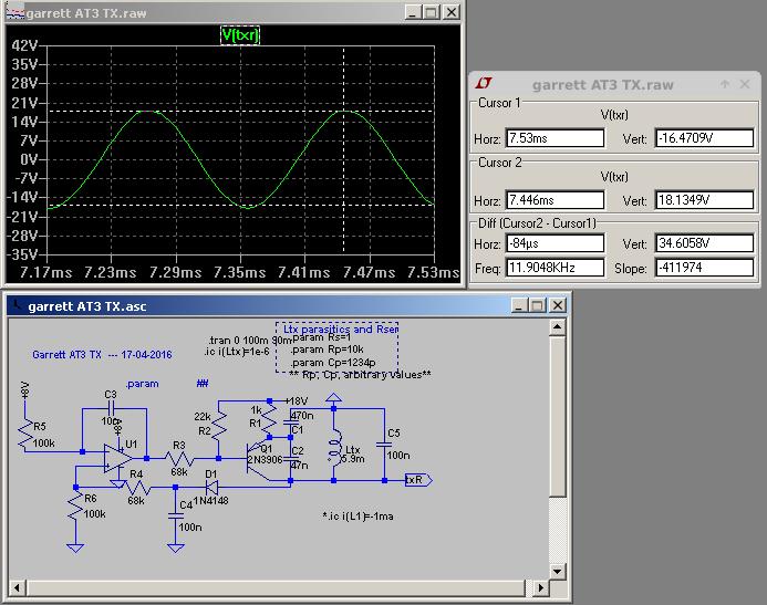

Tx freq should be 5.5kHz?
This is test results with different coils i tried:
TX 6.0 mH ---> TX f=9.93kHz U=20V
TX 2.5 mH ---> TX f=14.96 kHz U=21.6V
TX 0.9 mH ---> TX f=25.2kHz U=8.9V
Unit was somehow working with tesoro coil but with big loss of sensitivity.
All info about coil will help....
