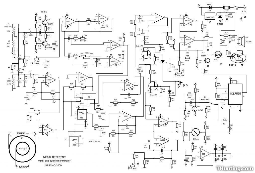

    who have schematic for slow motion discriminate vlf metal detector ??
    Work well . You can put dd coil.Click image for larger version

        but did you try it
        what i need is to make lare dd coil 0.5 meter square
        and slow detector so i can get good depth
        something like coil of deep hunter
          Ib detectors coil larger diameter bad discovered coins.30 sm is maximal for coins.

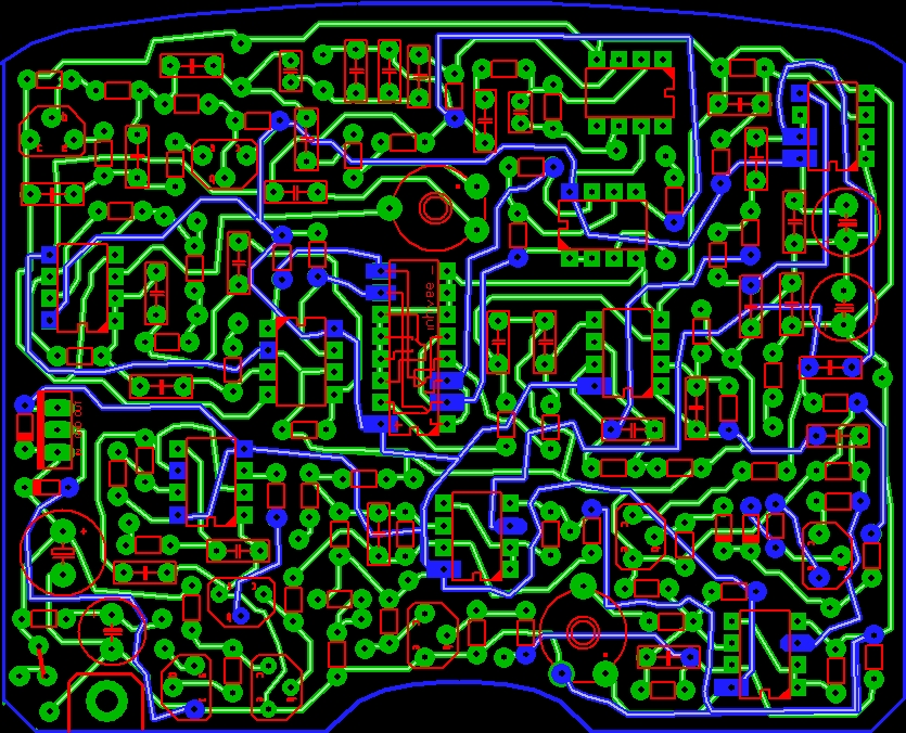

              Detector PCB-Click image for larger version

                      I'm all for a slow motion detection, and compressed audio. For real slow motion you must take care about the 1/f noise in gain stages, or otherwise you get a very decent LRL. I'd go even as far as to replace FET input op amps with bipolar, or even a chopper.

                        Any one test deep hunter will know what I mean slow motion needed for large Vlf DR coil
                          You are smart
                          low gain but high saturation time give slow motion or no motion
                            Well, almost. Compression gives you slow motion feel even with a machine that cuts motion well above 1Hz, but only for strong targets that get compressed. Small deep targets are not treated this way, and it is good to lower the HPF motion filter frequency to as low as possible to have that same feeling.
                            With lower frequency come 1/f and drift, which manifests as false targets, hence my LRL remark.
                              According to this can you modify idx to become slow without lose depth on large target?
