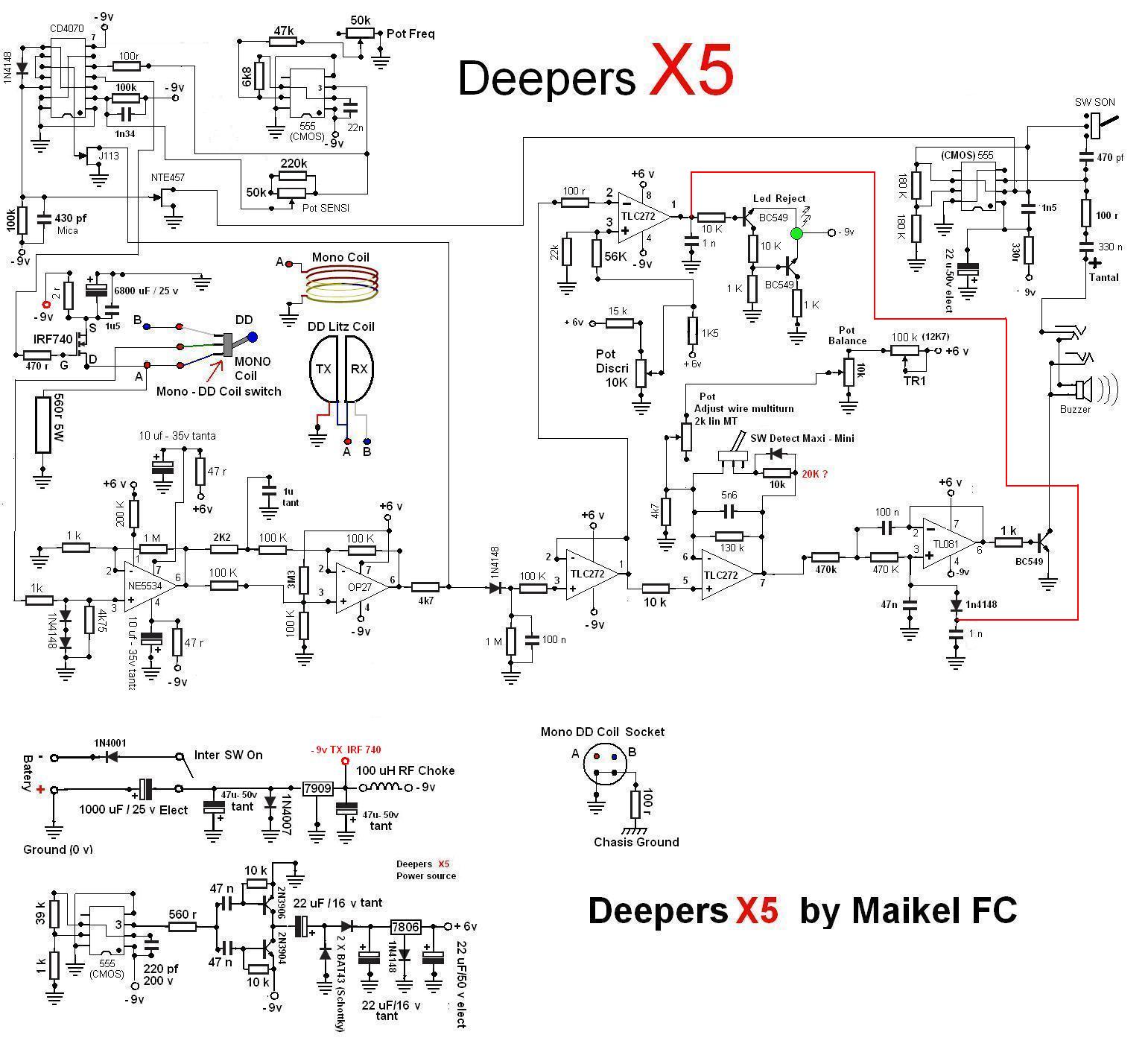

          • Here is a version of Deepers X5 schematics that I promess, I am working on it yet. This is a preliminar version but is full functional.
            please I need your coments is something wrong.

                        • MFC, I do not understand one moment in the scheme
Name:	not understand.jpg
                          Maybe -9V should be connected to E BC549?
                          • Maybe it is two colors, with ground at higher potential , one colour, when trani is on, other color
                            • I read the manual, really there two colors led. Rather it is with a common cathode. However, he is very strange and incomprehensible drawing. Where is red and where is green?
                              • Cathode to -9v?
                                Not sure if two colors LED?
                                Where is deepers manual?
                                One common cathode, two anodes. Or one common anode and two cathode. Common cathode is more usual.
                                Look at schematic above, green color is always lights, but iron will change to red.
