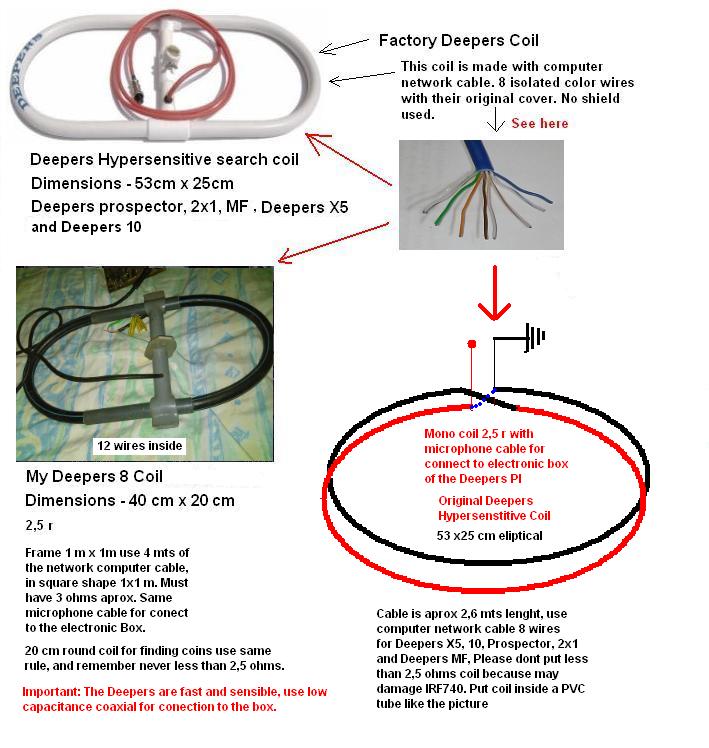

              • How to make The Deepers Coils
                See the picture.
