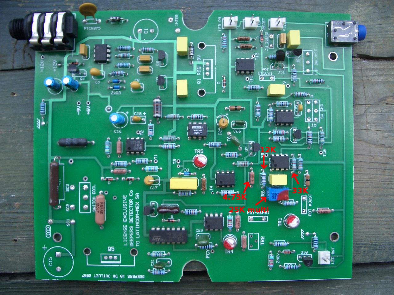

        You should be careful, Impetuity will get you nowhere. MFC originally stated that he was mounting deepers 10 board and he did not have values of potentiometer for deepers 10 board, and was asking for pot values for deepers 10. Here I am showing picture original deepers 10 board with pot values for TR6. You come here with impetuity, not realising the answer is staring you in the face.
        • #94
          As for measured value, each detector will be factory calibrated, therefore actual measured resistance of trimmers as they are set will vary slightly from detector to detector. What is needed is setup and calibration instructions.

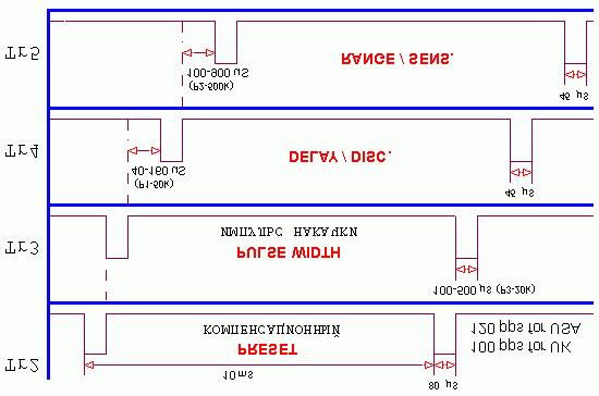

                And as I would say, please give me the factory specifications material along with the factory waveform settings sheets, along with the specification settings for the waveforms, and the test points used for the factory specification settings.
                The part value you gave was exactly correct. Each Deepers metal detector, is like a human being, some stronger, some weaker, and some just right, and each must be set to factory specifications settings by using an oscilloscope connected to proper waveform test locations.

                  Unfortunately, no factory specifications and factory waveform.
                  And we will certainly not see any factory specifications.

                      Thanks to you, its scheme is available to everyone who reads this topic, and on my circuit all checkpoints are marked.
                      Specially for you the final version of the scheme, with corrected all the mistakes.
                      It's a pity that there are no oscillograms.
                      Thank you for the photo inside. Enjoy the result.
