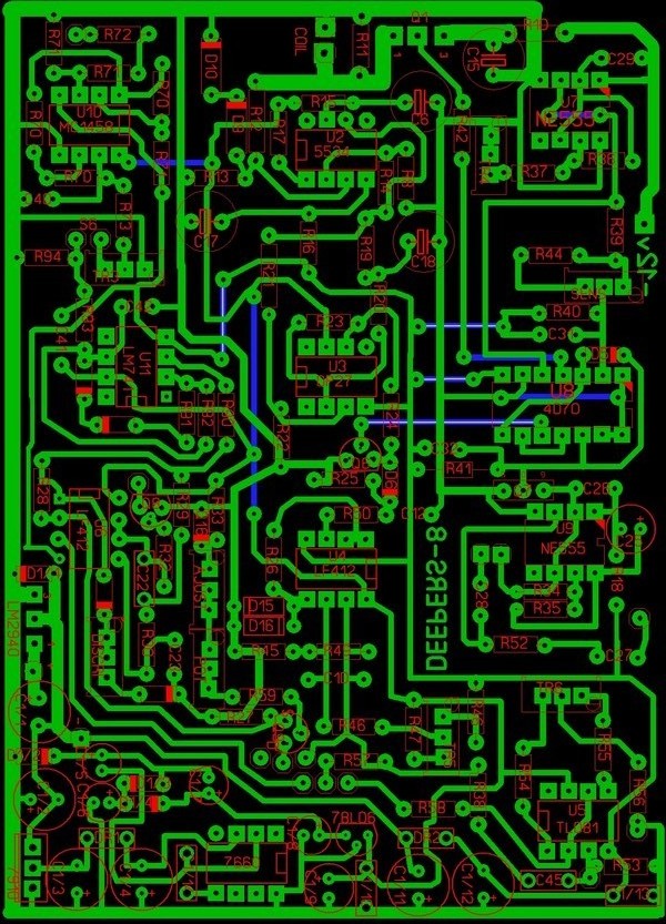

                      • in my Delta Pulse board i use the shielding cooper pouring under every IC, either it is plus of minus,
                        as that is only possible there. just no difference what power line you use for the shield.
                        i took/noticed that trick from Deepers board layout be cause i am good schoolboy sitting
                        in first row in the classroom.

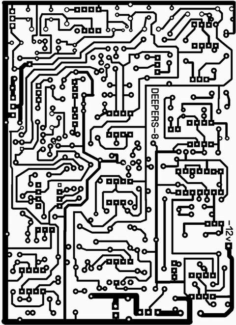

                        • This is a scheme depeers 8
                          https://www.up4.cc/downloadf-152356269094551-rar.html
                          • thank you But my brother Sprint Layout is different from the schema
                            • To see the difference between them
                              https://www.up4.cc/image73753.html
                              https://www.up4.cc/image73754.html
