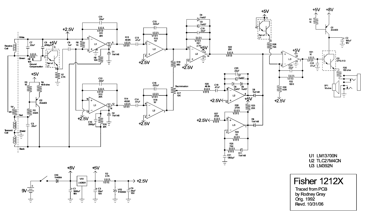

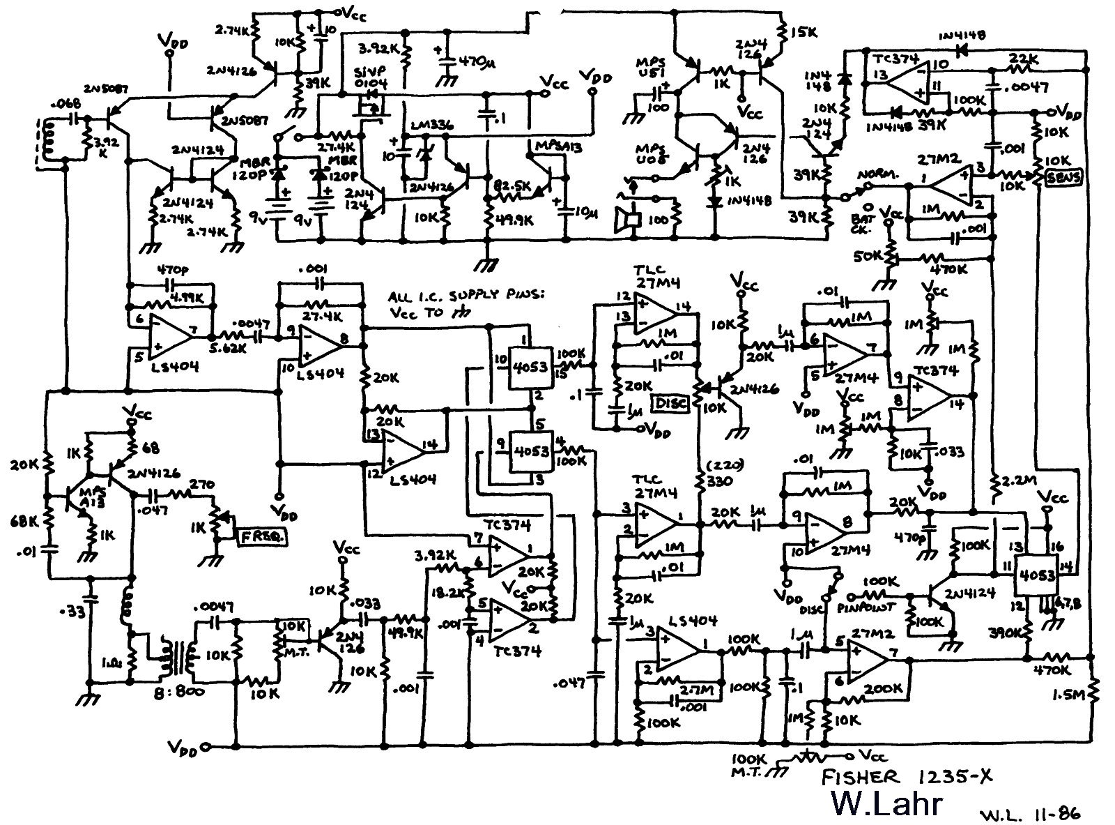

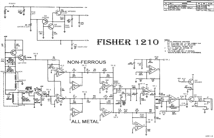

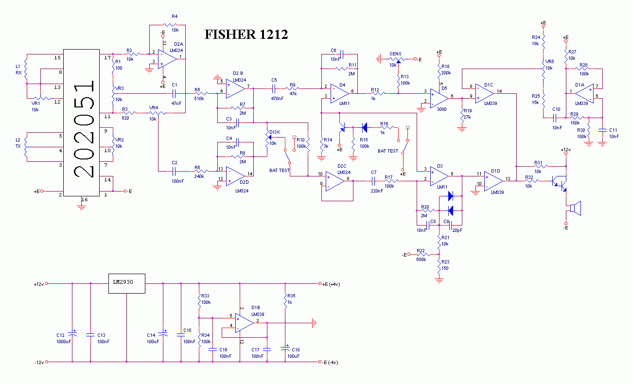

I wonder if there is an adjustment setup info out there some where ? It has a bunch of adjustable pots on the board. Or I wonder if a few of them can be moved to pots on the box for adjustments like the 1260x
I set mine up. But can't remember the POT locations.
Sensitivity crank it up until it starts to chatter the back it off until it just stops
Unusual is there are two pots for ground balance. One for slow sweep the other for fast.
Set with the discrimination on 0 and sensitivity on max. Graphite 2" above the coil waved slow adjust for least sound then speed up and adjust the other POT the same
Discrimination is set with a large copper coin. Disc on 10 wave coin 2" above the coil and adjust until its just fully rejected.
Sorry I can't remember the POT locations. I couldn't find the information online. I had to email a repair shop.
