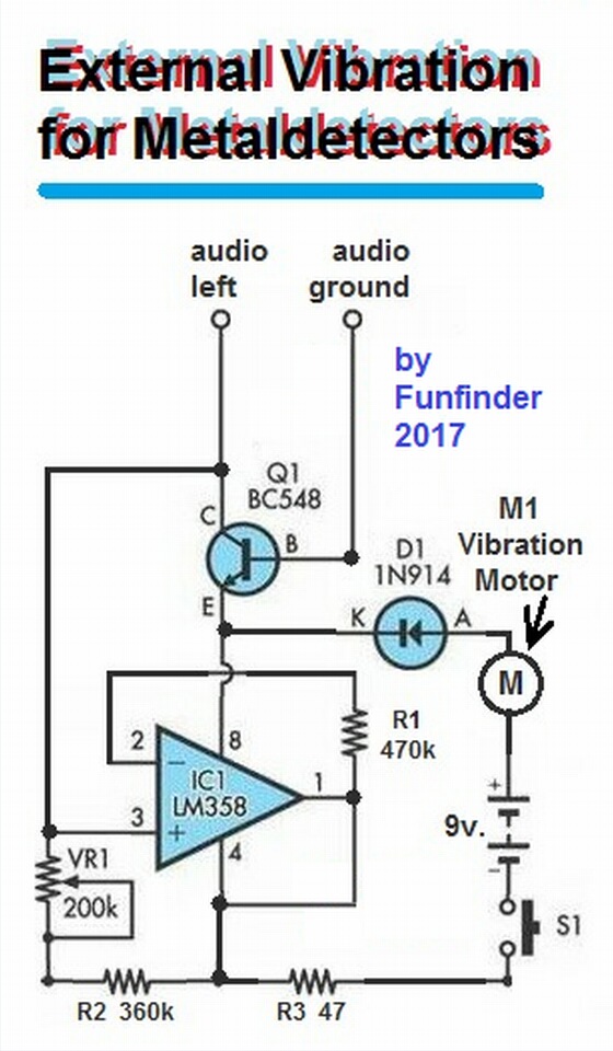

    After tough negotiations *laugh* I can proudly present you
    my MD-Vibrator invention as schematic here at this forum !
    It has been tested meanwhile under real search conditions
    and it works great! I used the Garrett Euro-Ace for the test
    and I even found small stuff (lead-bullet, 13mm, 10cm deep).
    So far tested:
    working:
    Garrett, Fisher, Makro Jeohunter & Racer
    not working:
    DeepHunter (always signal), Blisstool (signals too fainting)
    Of course now it's your turn to improve this thing if you like!
    Or input some ideas for a dongle so other MDs will work, too.
    I also think its not the best idea that the full current runs totally
    through the vibration motor. I guess its better if theres an extra
    division for the motor incl. variable resistor for vibration-strength.
    And, for best results, use this MD-Vibrator with pulse induction -
    or non-motion detectors, where a clear on-off signal is available!
    Or - if possible - use pinpointing-mode to catch the weak signals.
    Have fun!
    After testing I found out that the vibration motor is a little bit weak
    so the R3 47 Ohm resistor can be lowered to 22 or removed at all.

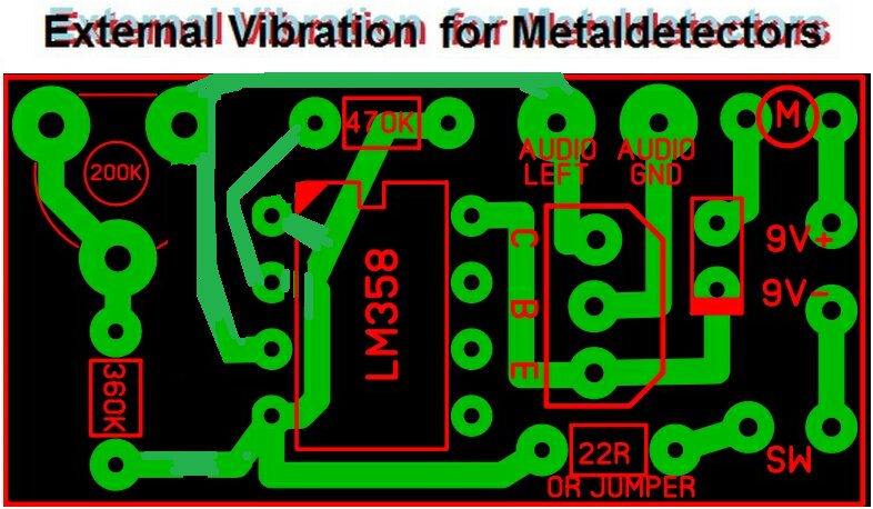

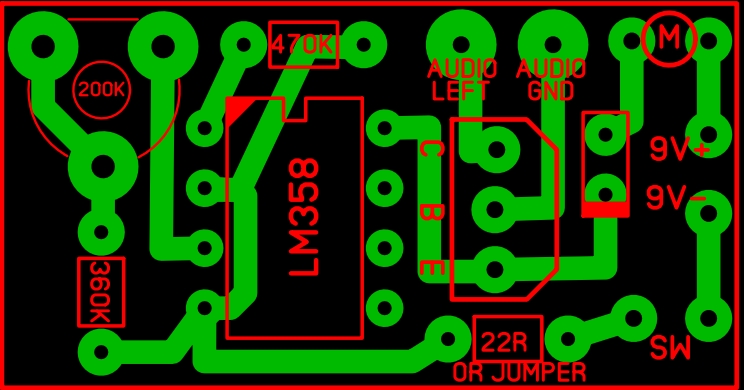

            Here's the corrected layout, enjoy.
Name:	Vibration circuit pcb ok.jpg
              Thanks Funfinder,,,,,I'll have a go at building it for my sisters detector,,she's totally deaf so she may benefit from this. Regards,,,Marty
                Thats a blessing-worthy motivation you have and great that you found the new layout that fast.

                  Parts List
                  - the above posted PCB: Vibration circuit pcb ok.jpg
                  (but you can solder the parts also directly together as I did if you have
                  enough imagination or if you can draw yourself a little sketch on paper)
                  - the vibration motor should be a little bit better and stronger as those ones
                  which are used inside of Smartphones but you can also use them, they are
                  just a little bit weaker (you can rip them from some old phone and try).
                  Polarity does matter if you attach them because those are DC voltage.
                  This means that you should connect the black cable into minus and
                  the red cable into plus direction - seen from the power source.
                  Apropos power: 2x 3,7v LiPo Batteries also should work.
                  If you know how the balance recharging works correctly.
                  You even can use some Digicam or Camcorder accu (7,4v)
                  if you can create or find any connectors-adapter.
                  The simple solution is a 9v LiPo rechargeable block, some old
                  NiMH 9v Block (but is more weak) or the usual batteries.
                  S 1: as switch you can use anything, even 2 wires bend together. *laugh*
                  If you wanna remove all the time the battery you even don't need any.
                  Of course the switch if in usage should be reachable from the outside.
                  VR 1: Variable resistor aka potentiometer: 200k.
                  I have placed it into the battery-compartment so its waterproof
                  and I must not adjust it all the time, anyway.
                  But you also can make it easy adjustable from the outside.
                  R 1: usual consumer electronics resistors: 470k yellow-violet-yellow-gold
                  R 2: 360k orange-blue-yellow-gold
                  R 3: 22ohms red-red-gold or replaced with wire for stronger vibration
                  D 1: diode 1n914 (or similar glass diodes, not too tiny)
                  Q 1: transistor BC548 (or with similar npn specs)
                  IC 1: integrated circuit ("intelligent chip") LM358
                  This is the OP-amp and comparing part.

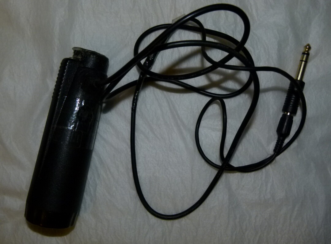

                  Audio Left - Audio Ground:
                  this is simple mono audio where "left" stand for the
                  complete output. Because MDs so far have no stereo output,
                  they only provide the mono signal same for left and right.
                  This means you also can use some stereo-jack if available
                  and you just connect left and right as single left output.
                  The best here is to cut off the cable from a DJ-headphone
                  because the small wires inside are very resistant against
                  movements, shaking, breaking etc. For soldering hold
                  the wires a short time over a flame for burning the
                  isolation-coating and afterwards rub it away.
                  Ground is the shielding which either encloses the white (left)
                  or right (red) cables or its the non-colored gold-copper wire.
                  And last but not least:
                  Wearing the vibrator inside the trousers- or shirt-pockets
                  might be a good idea as long as you can feel the vibes
                  clear and strong enough. Otherwise its better if you
                  clamp, tape etc. the device near the MDs handle.
                    (or: red-red-black-gold)

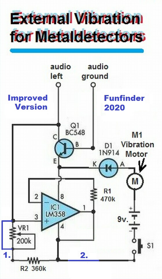

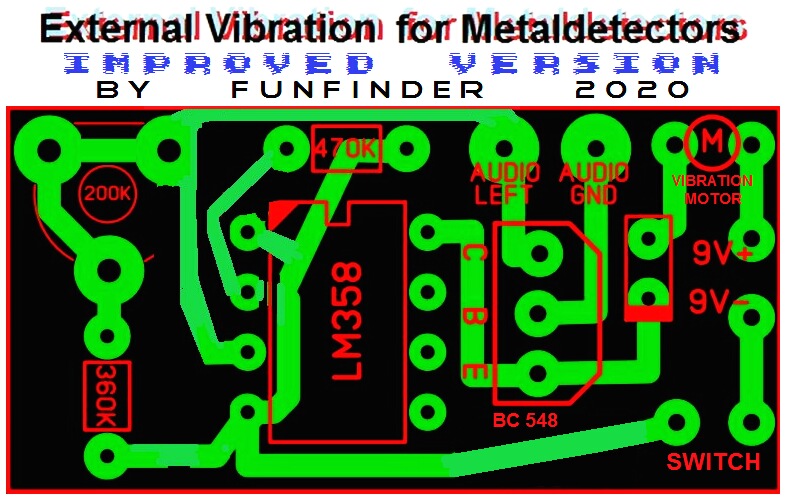

                            Improved External Metal-Detector Vibration Circuit Version 2020
                            update log:
                            _ full power vibration strenght (resistor R3 removed)
                            _ no more disturbing detection signals caused by electrostatic charges
                            _ clear vibration control for MDs with single or dual audio output (Jeohunter, DeepHunter)
                            _ supports additional ( or even all ?! ) detectors now
                            _ schematic & PCB updated
Name:	Improved External-MD-Vibrator Schematic 2020.jpg
Name:	Improved MD-Vibration Circuit PCB 2020.jpg
                            Well, this was a lucky hit today - - while tinkering and probing around! *laugh*
                            Later I saw that the magic was done by shortcutting the variable resistor, but this part
                            now works even better than before. Guess it has to do with the weak audio AC input.
                            For the Garrett detectors it also works perfect now, even with lowered audio volume.
                            I can't test every single MD but the improved version now even works great with
                            the DeepHunter at motion mode 2, so I guess it will work with pretty any MD!
                            If you built this device make sure that the 200k variable resistor is good reachable
                            because depending on the used detector you have to adjust it for best performance.
                            And better attach a good and thicker audio-cable as connection which doesn't breaks.
