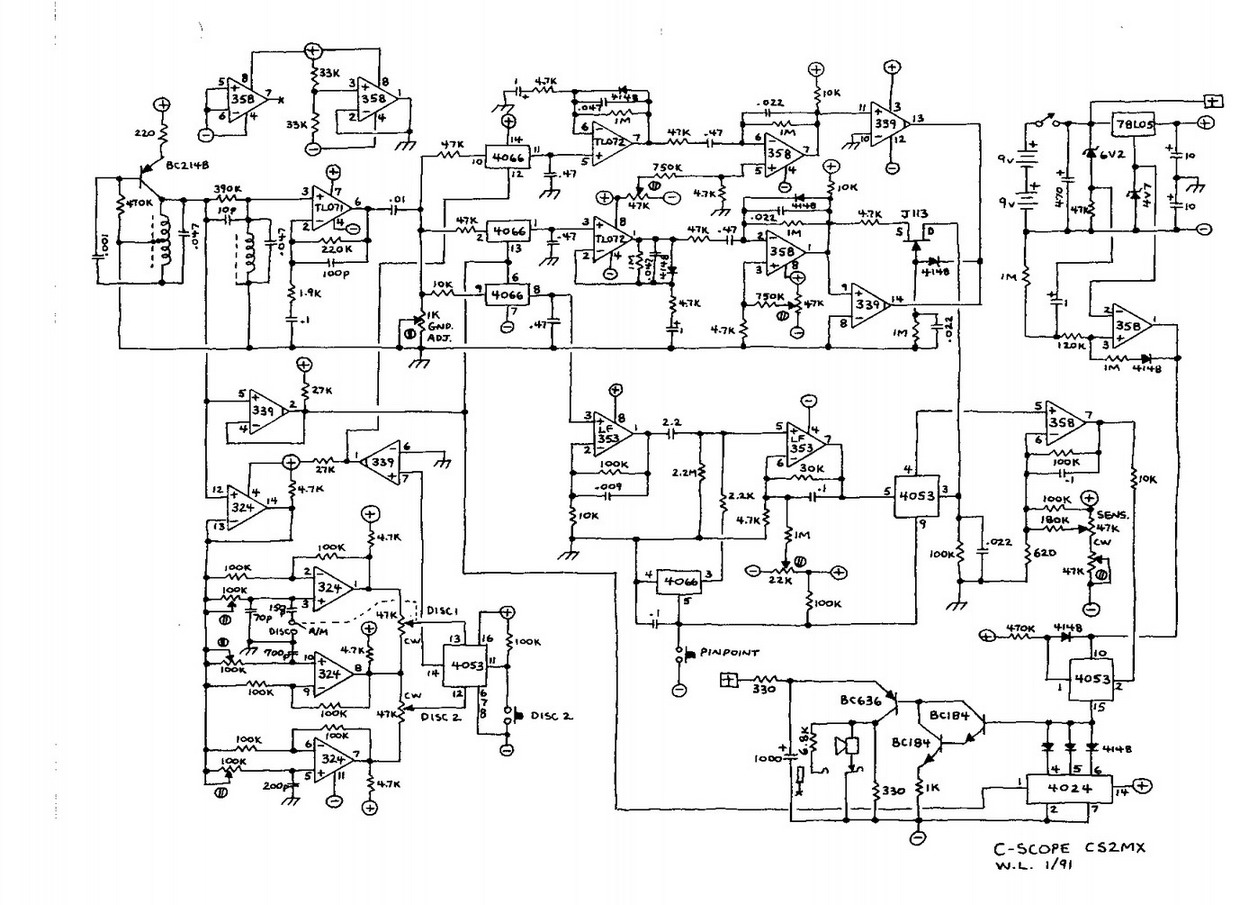

Please , schematic information for cscope cs2m

                  dbanner , your schematics (#3) cs2mx - does not comply with this metal detector

                        I want to put dd coil . Оriginal coil /20 cm = 7.9 in/ very shallow depth.
                        https://jpegbay.com/gallery/006699602-.html#1
                          Are you going to make a DD coil or you trying to buy a compatible DD coil? Making one would be very easy for this detector. You need to download user manual and look to see operating frequency. From this you can determine coil to make. Try to measure inductances of your cs2 coil. Try to determine if there are capacitors inside coil housing. This is easy to deduce. Look on pcb for tuning caps on front end of circuit leading to coil connecter. If you find any, note value and use resonance calculator to find inductance of Tx coil. Do adavanced search on this site for any info on scope coils. Just some tips. Maybe someone else can advise on DD coil replacement.
                            I have compatible DD coil original fisher - 2.2mH , 8 Ω /2.4mH ,14Ω - NO capacitors inside coil housing
                            Original coil cscope cs2m - 1.9mH , 7.8 Ω / 1.9mH , 11Ω
                            Original coil - transmitter has a middle inductive point - 3 inferences
                            dd coil - transmitter - 2 inferences
                            Тhis metal detector model has , three-point generator circuit
                            I want to activate dd coil - which is a two point
                            Generator works on a two-point circuit - I activated generator
                            Problem is in phase-shifting step !!!!!!!!!!!!!!!!
